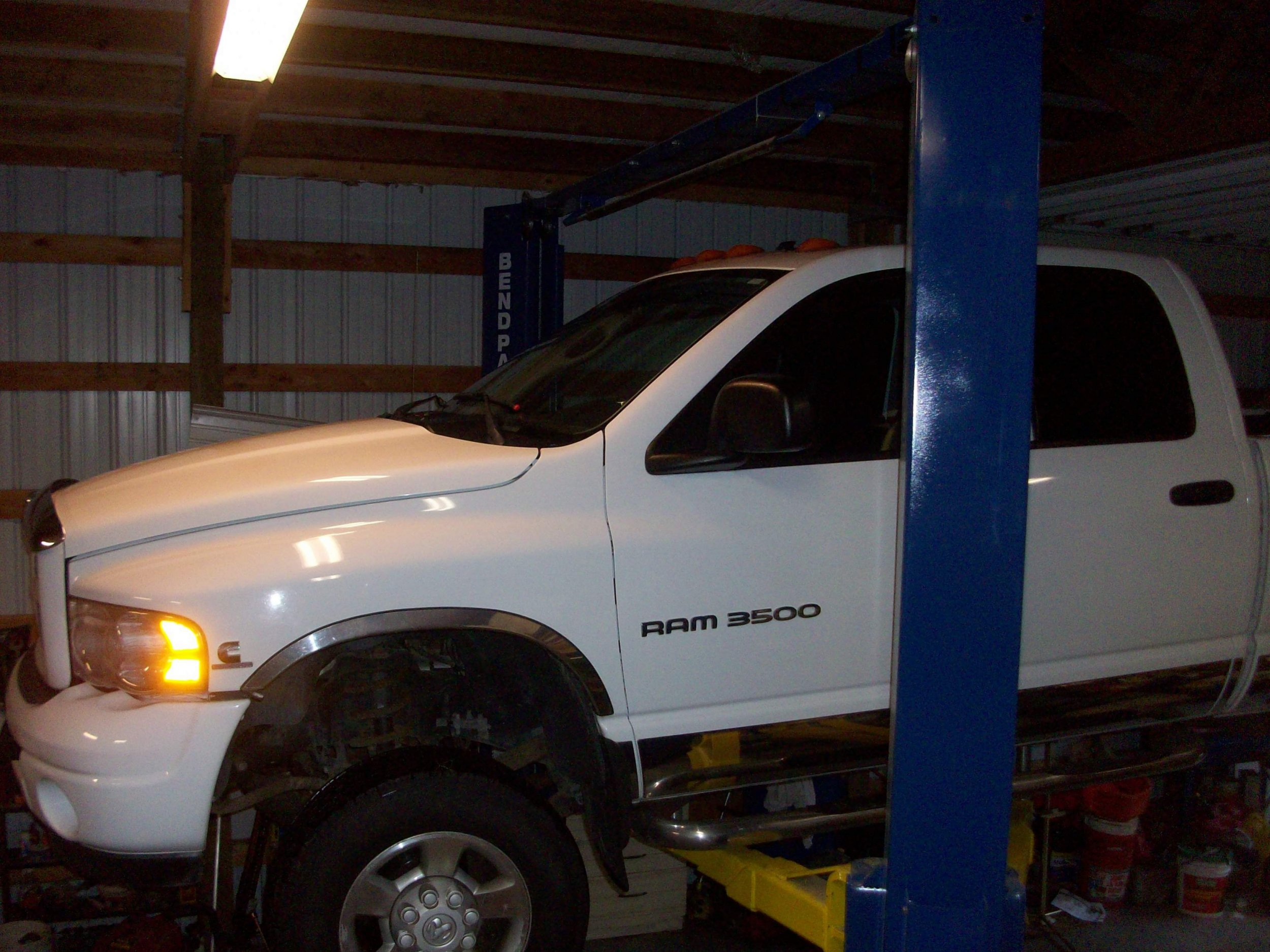

I have a two post 9K asymmetrical lift with the cross piece overhead. In my old shop I had a pit but found it to be far less than ideal for anything other than oil changes, which I do a lot of, but I also do a lot of tire work so I needed the wheels free.
When I poured the concrete floor I also dug out two squares 2' x 2' x2' where I knew the lift would go and made a rebar cage within the squares (monopour with the slab). The directions said it could go on a four inch slab but I had some hesitation so for an extra 1/2 a yard I could use 12" anchor bolts and not give it a second thought
My only regret was not going with a 12K unit for an extra 2K that I would not even remember spending 15 years later....

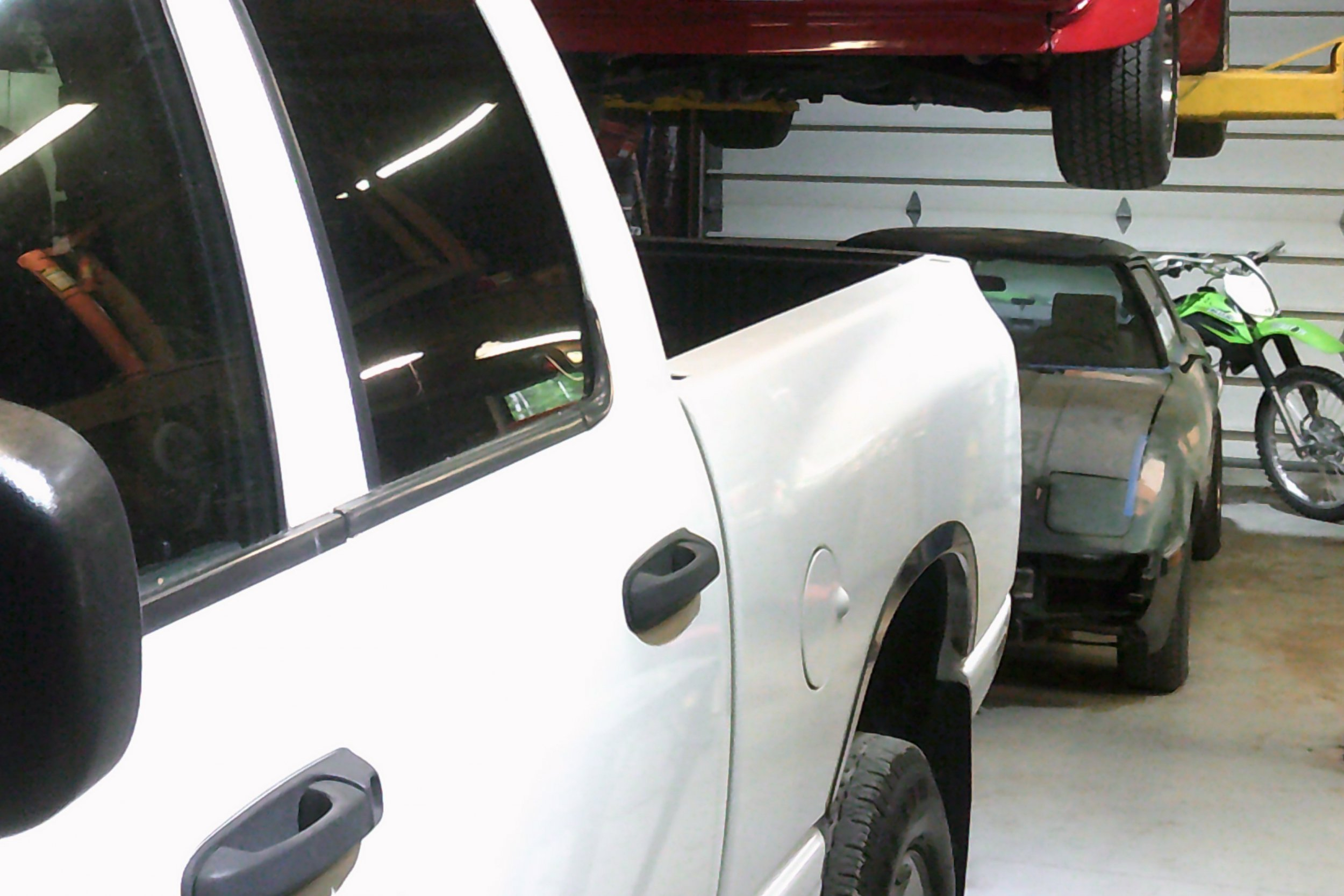

There's a place outside of Ft. Worth, TX that builds lifts, used to be called LiftCo, now something else. They will custom build lifts to your height specification. They built my 2-post 1 foot shorter than normal. I moved and now have a 4-post. I like it a lot better.

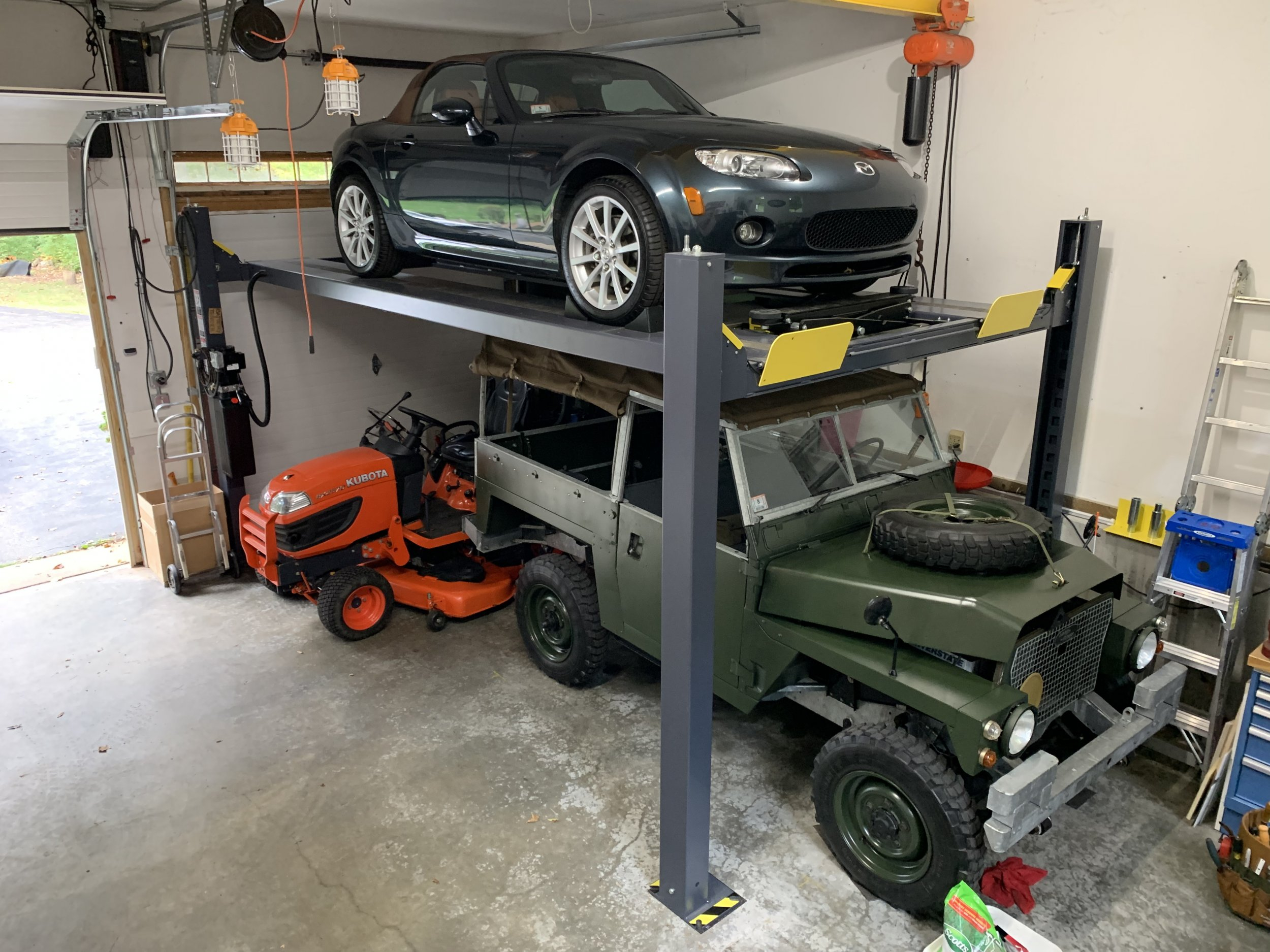

I just installed a BendPak 9K 4 Post lift in my garage, I wish I had done it years ago! I installed it myself, using my tractor and the garage beam hoist, it was pretty easy actually!
I got the 220V version because I already had plenty of power to the garage.
I also got the sliding air Jack, wheel Kit And rolling oil funnel thingy. 4 post works best for me because I also use it for winter storage. I don’t know about other lifts but the BendPak runways are adjustable to accommodate different width vehicles. I have 81 inches clear under the crossbars.
It’s SO nice to do maintenance standing up! One piece of advice: Do NOT tell family or neighbors you have a lift!! You’ll spend every Saturday and Sunday “Helping” them work on their vehicles!!
BN
Which model is it, it looks good
