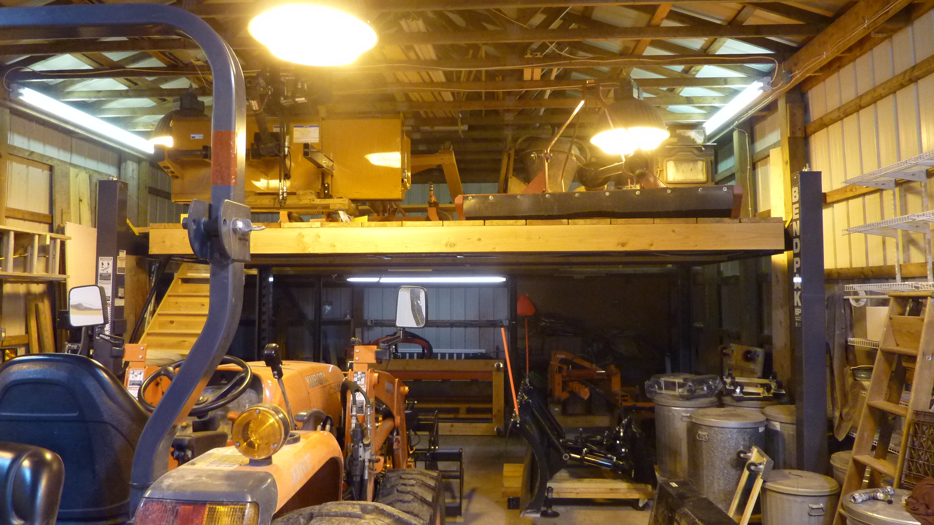

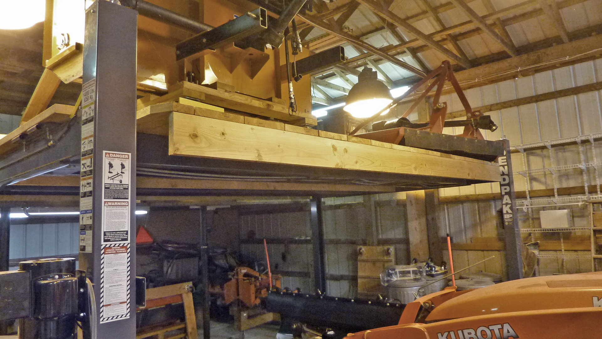

I have a Bendpak 14K 4 post lift I use for storing implements:
View attachment 736993 View attachment 736994
When I ran out of floor space, it was cheaper than a new pole barn.

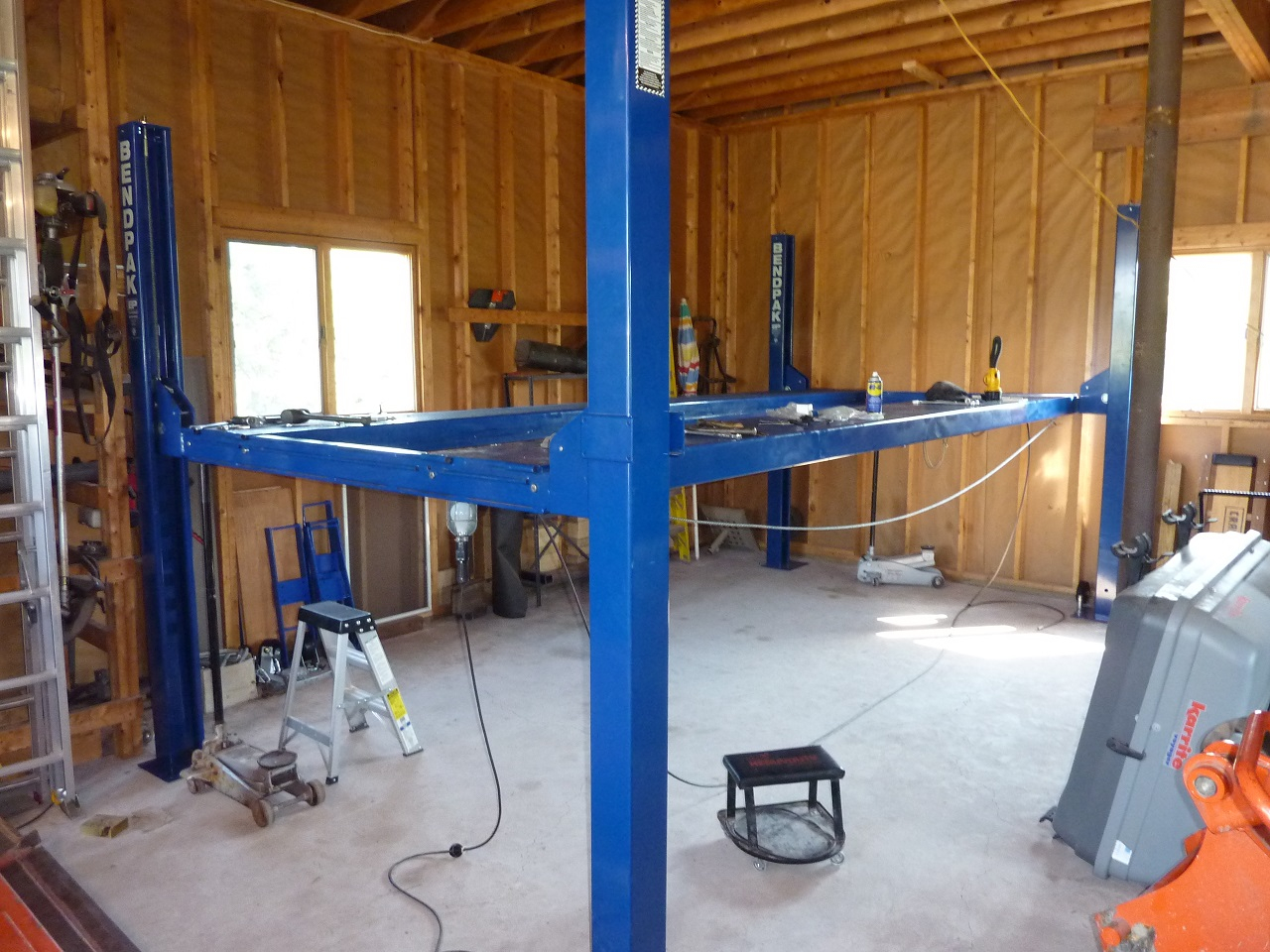

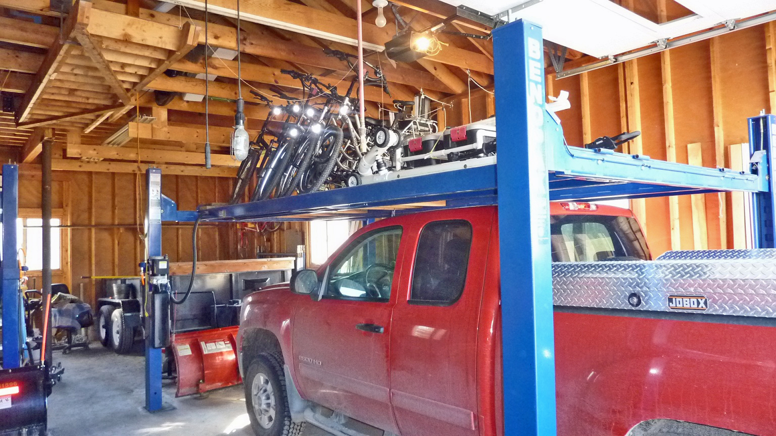

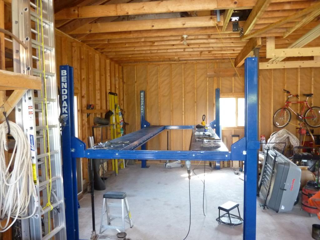

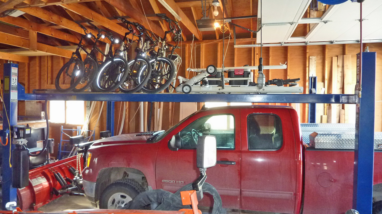

I also have two Bendpak 8K 4 post lifts in one of my other buildings:
View attachment 736992 View attachment 736991
I use one for storage and the other for working on vehicles:
View attachment 736995 View attachment 736996
No more laying on my back under a jacked up vehicle. My creeper hasn't been used in years.
Size & weight were a problem for local delivery. I had them shipped to a local freight yard and picked them up with my 10K trailer.
I was thinking a lift isn’t worth the expense until I saw your pictures. 👍 Putting the implements up is brilliant. Doubling your covered space makes it pay for it’s self.
