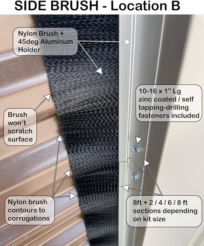

Also brush seals around corrugated rollup doors working well to reduce drafts and critters entering. By JaCor:
