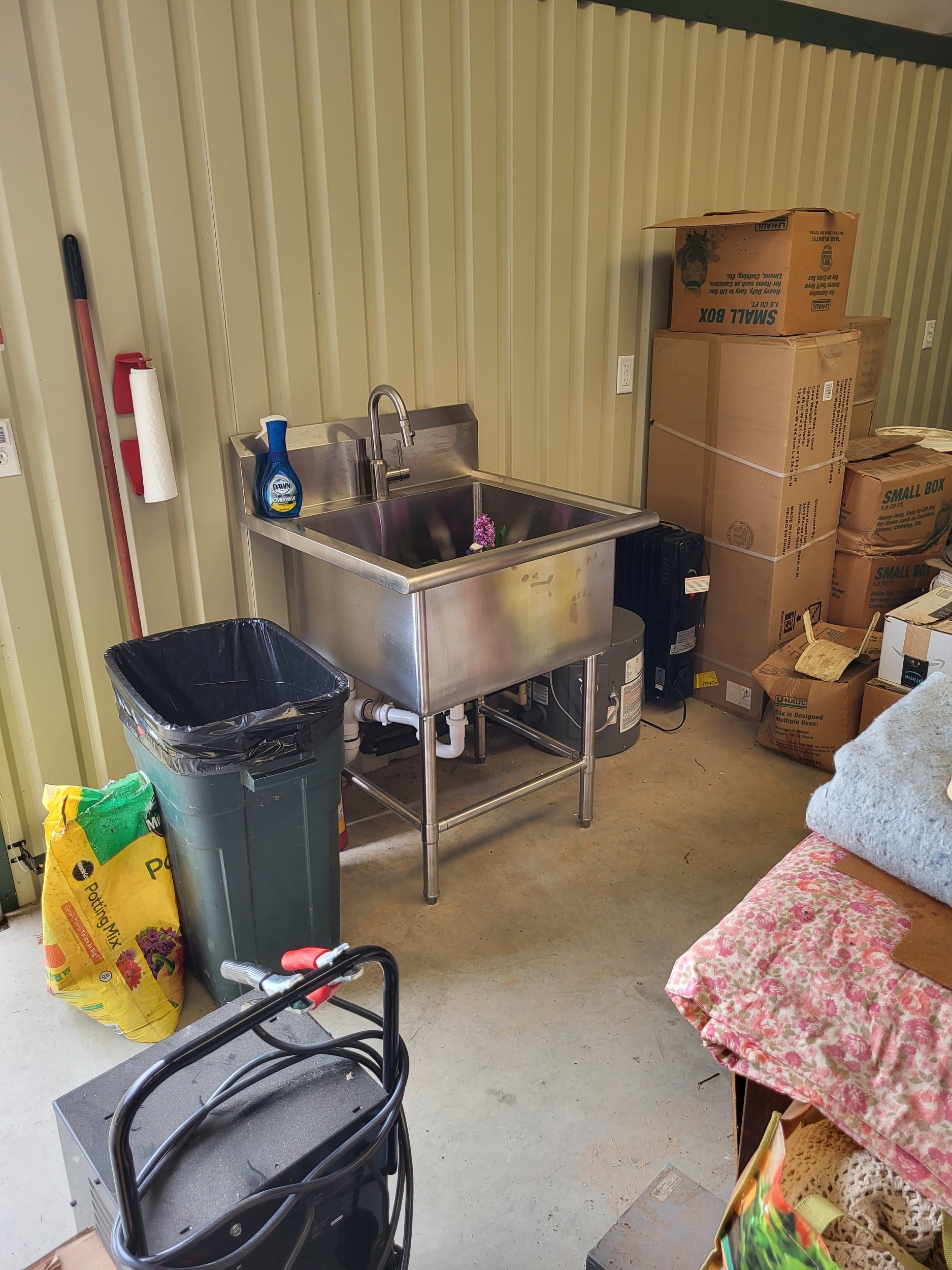

When I had my garage built years ago here's a few things I did & some I wished I did. I did have a bathroom and adjoining laundry room which is good, and with floor drain. Really came in handy when we had to have house drain replaced or water problem. It's well insulated and has hot water heater and propane wall heater. The heater pilot running is enough to keep pipes from freezing.
Other side or wall is a laundry sink next to parts cleaner. Garage is about 250ft from house, no fumes & fire safety.
Although garage has a propane furnace it has an adjoining one car garage with workbench easy to heat just that instead of whole garage. It's two story and I probably should have gone 3 story. Gas & diesel is in a separate building.
I should have had a floor drain put in and a wash bay with It's own drain would have been nice. Garage is close to stable so we could wash horses easily also.

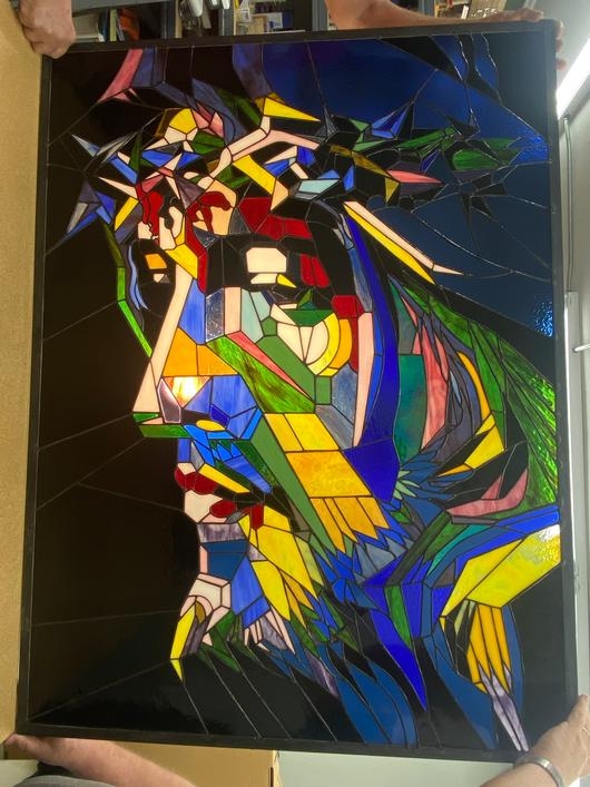

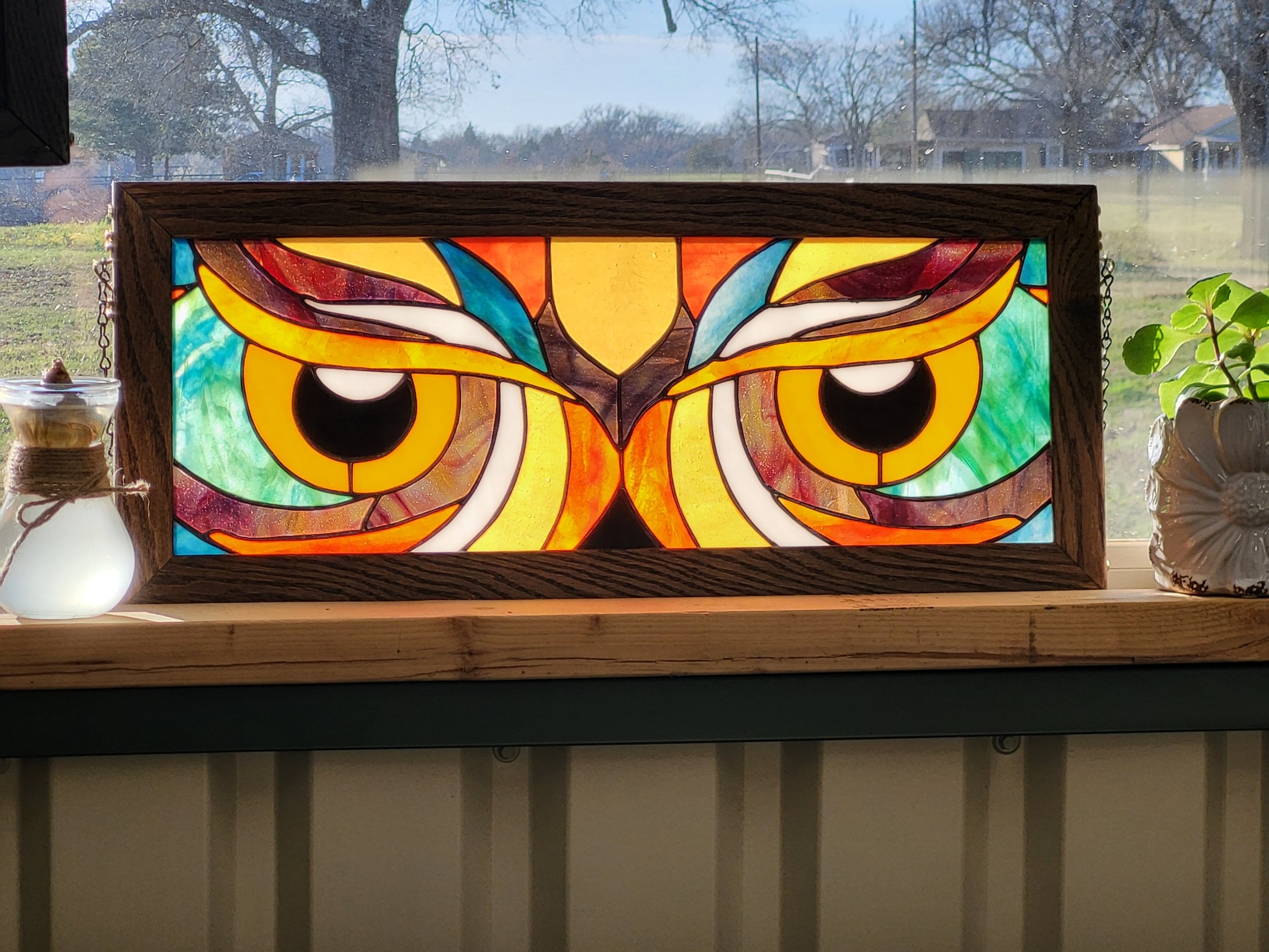

Have plenty of electrical capacity. I have a 200A meter with a large breaker box in our shop. We just added on to the shop to expand our stained-glass business. A stainless-steel sink with 6-gallon hot water heater has come in handy to clean glass. Added a 50,000 BTU electric heater just to keep a minimum temp of 50 degrees so the plumbing doesn't freeze. A dedicated office/design studio with 18,000 BTU HVAC to keep the computers. printers, and Cricut cutter away from the dust and heat. Also another 240V plug for a kiln to fuse glass, this one was 20A. That is in addition to the 240V plug 40A I already had for a welder, if I ever need it.
Here are a couple of examples of the projects my wife just completed. Jesus with a Crown of Thorns is 3'X4' and has 577 individual pieces of glass of 48 different types. It is displayed the lobby of the new ED in town, along with 3 additional pieces the same size.

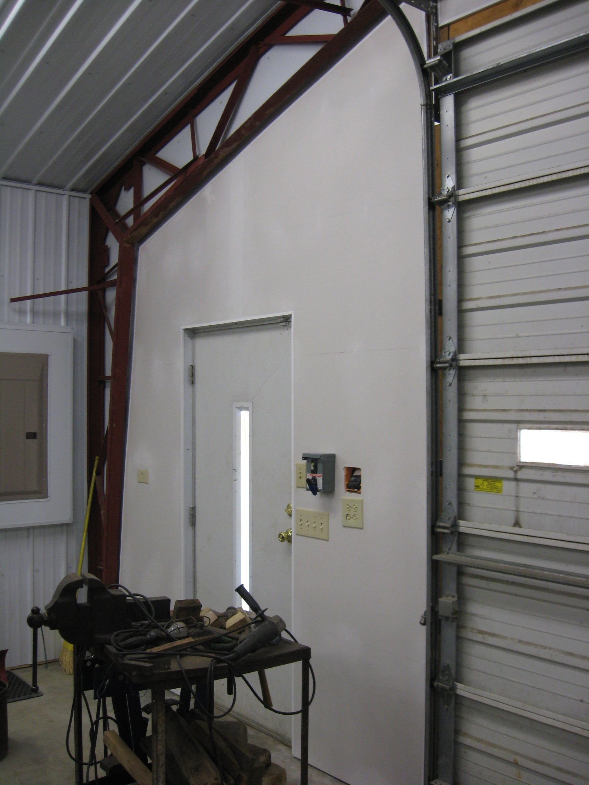

These 120v pilot lights are inexpensive if you shop around. They use NE2 neon bulb, last forever and use 1/4 Watt current. It mounts in a 1/2" hole drilled in light switch cover, etc. I wire it across the switch so when switch is off light turns on.
That way at night no fumbling for a light switch and I can easily see what's off since light is on. Probably a burglar would think it's part of alarm system.
And I did install a wired alarm with magnet switches and heat/smoke detectors. Alarm horn is in cupola...it's really loud.

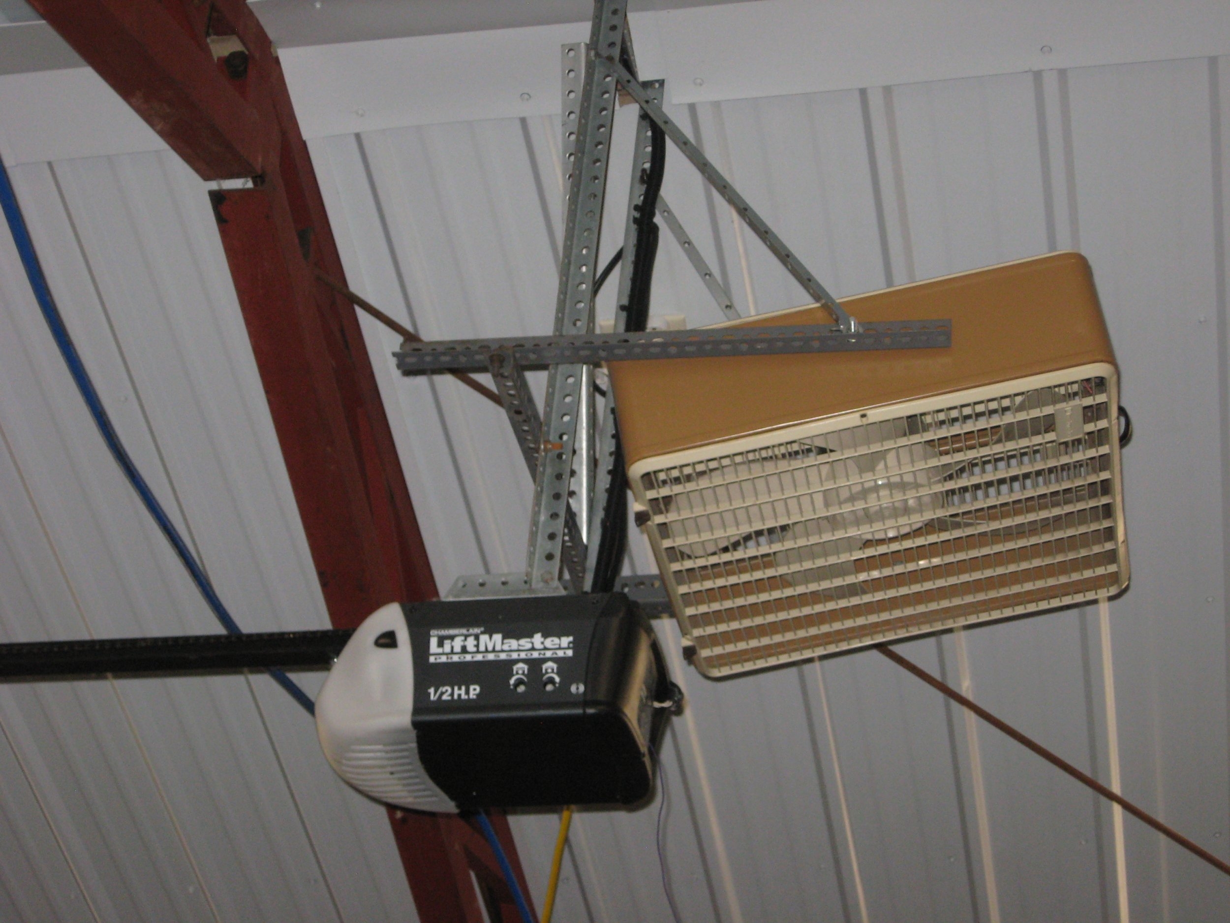

Redneck ceiling fan. Looks goofy, but works well, just a little noisy. Keeps the warm air down at floor level. Switched with a wireless remote.
Also have the door opener on a wireless remote so as to disable it for security.
Disconnect switch for air compressor on the wall, right next to the light switches and door so I can easily remember to turn it off when leaving for the day.
