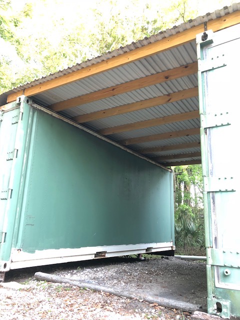

When out in the open, my container had terrible condensation issues. Had to tarp over my CUSHMAN mower that sat in there. Now amidst the trees and painted green, I have never detected any condensation issues.
It is also full of all manner of stuff that doesn't require fancy storage but should be out of the sun, rain, snow and pine needles. Maybe the mass of this STUFF has some effect on condensation. When the Cushman was in there, the container was basically empty.

Four years ago I graded out a gravel pad, built a 20x40 carport, enclosed back with panels coming down the side just enough and placed a Beige 40 HC one tripper on each side. They were moved in placed with a 電onkey and offset forward of the front carport posts to allow the doors to open and leaves to blow out the back. One has 4 pressure vents and the other has 9. The nine vent box stays a bit cooler so that where my Kubota and Polaris live. I added a 9 covered vent in the front right door with a turbine in the back roof. I ran solar lights thru the turbine and gorilla taped the solar panels to the roof. There is a lock box to allow a single pin lock to secure. The work box is wired for electricity with outlets and LED lights. No problems w condensation or rust in OK. Rains a lot here but not as much as FL!

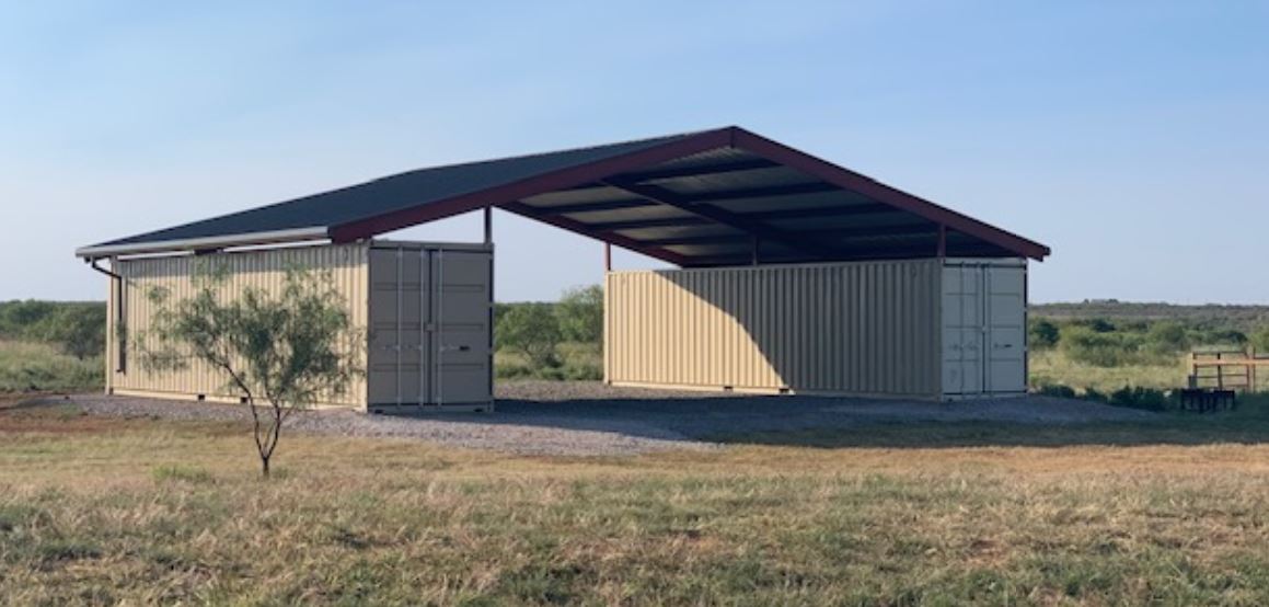

We just finished getting a roof installed on our 40' high cube containers with doors on each end. I keep my Kubota M62TLB , MX5800, and my F2690 mower in them as well as a sprayer & spreader. They fit perfectly and I don't have to worry about mice eating all of my wires again any more. With the roof it was still the cheapest 50x40 barn I have ever built and, from what I am told, it might not increase my property tax bill since it is portable. Not sure about that one yet.
How expensive was the roof? Nice!
WOW! That looks very nice. Very cool. Not to be nosy but what did that cost? Did you have a tough time finding someone to do it? We would need a back wall up here in snow drift country, so wondering how the roof would survive in in crazy winds.
Thanks! It was right about $14,000 for the roof with gutters. More than I originally guessed but they did a really nice job and were in and out in 4 days. It is 15" I-beam so it should be pretty stout for what amounts to about a 30' actual span (54' overall roof width but it is supported at the inner edges of the containers also). The container supplier gave me a list of local welders they have used and the first guy I called was ready to go. I painted them to match my other buildings so they don't stand out too bad.
I was worried about the wind blowing the whole thing away too but 8,000lbs for each empty container+ who knows how much weight in I-beam,+ around 20,000lbs for three tractors inside gets to be a pretty heavy structure.
