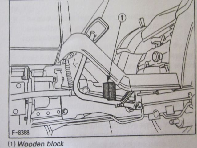

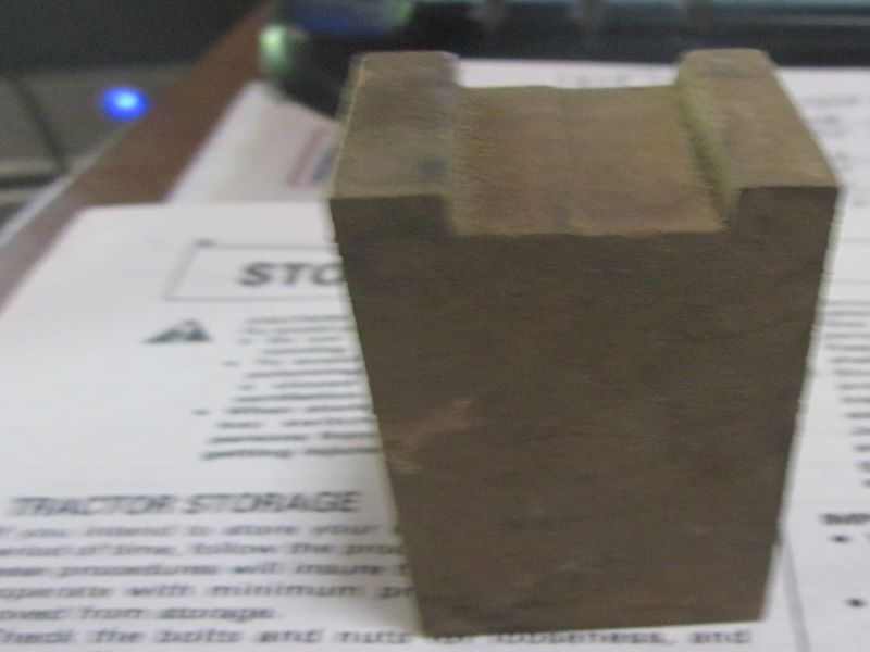

If it is a gear drive tractor one of the most important things for storing is making sure the clutch is disengaged to prevent it from getting stuck to the pressure plate...All gear drive K_ubotas of the era came with little blocks of wood with a notch to place in the mechanism (under the floorboard) to keep the clutch pedal depressed and the clutch disengaged...
/ Long term tractor storage.....and less long term #6
Any references? Pics?
I've a M4700 gear drive.
/ Long term tractor storage.....and less long term #7
The block is about 1.5" X 1.5" X 2.75" the notch is about .1875" (3/16)
