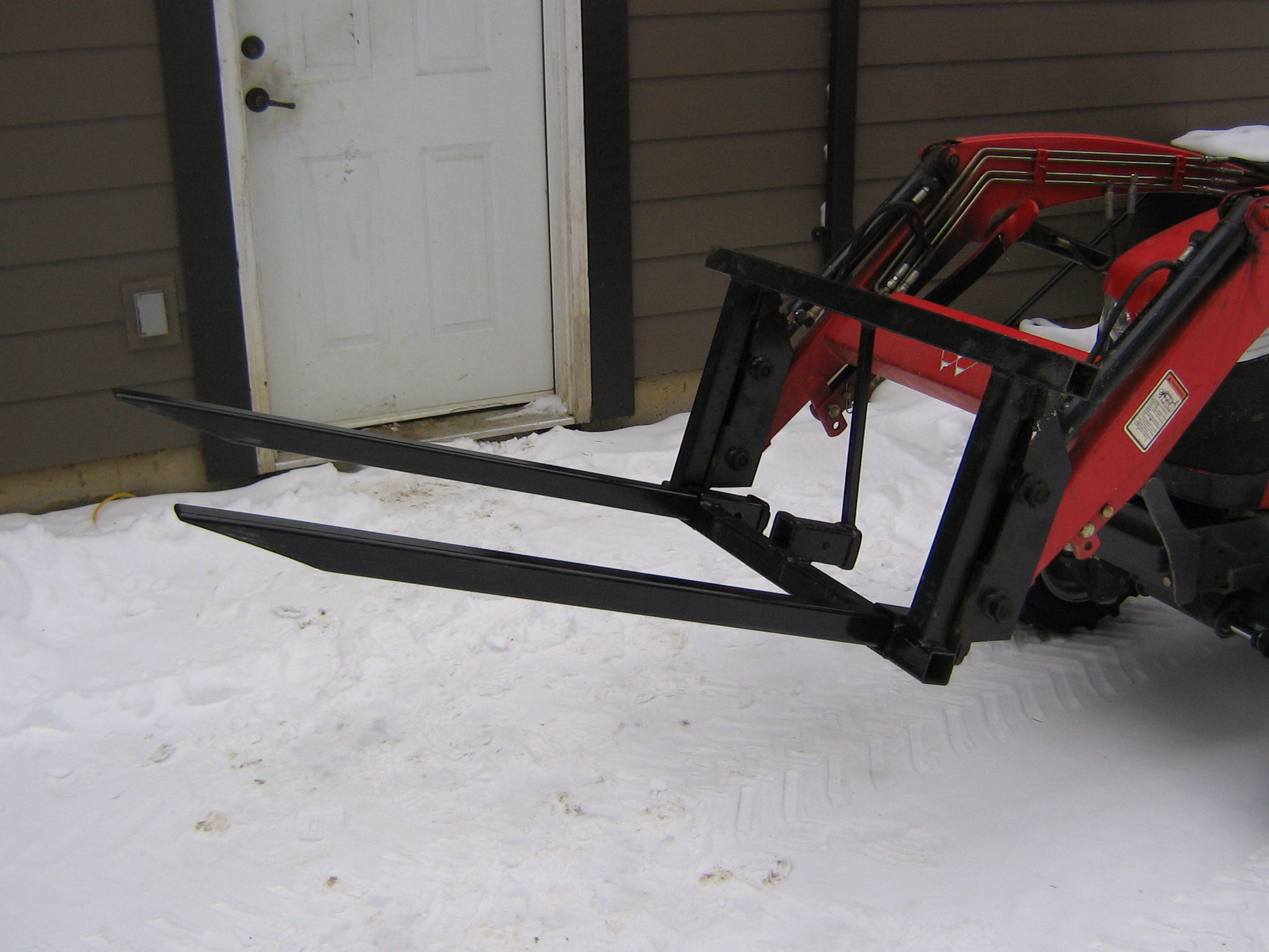

Plus, the visibility that the bucket takes from the clamp-on forks makes it a very tricky experience.
I made a set of clamp-on forks for my previous loader. I didn't use those much and it was very hard to see the tips of the forks.
On the new tractor, I made a Euro style quick attach set of forks, borrowing the forks from my 70's electric forklift and I use those things all the time.
Very useful, it's compact, you have decent visibility over the forks. It doesn't extend the load forward like the clamp-on forks do.
