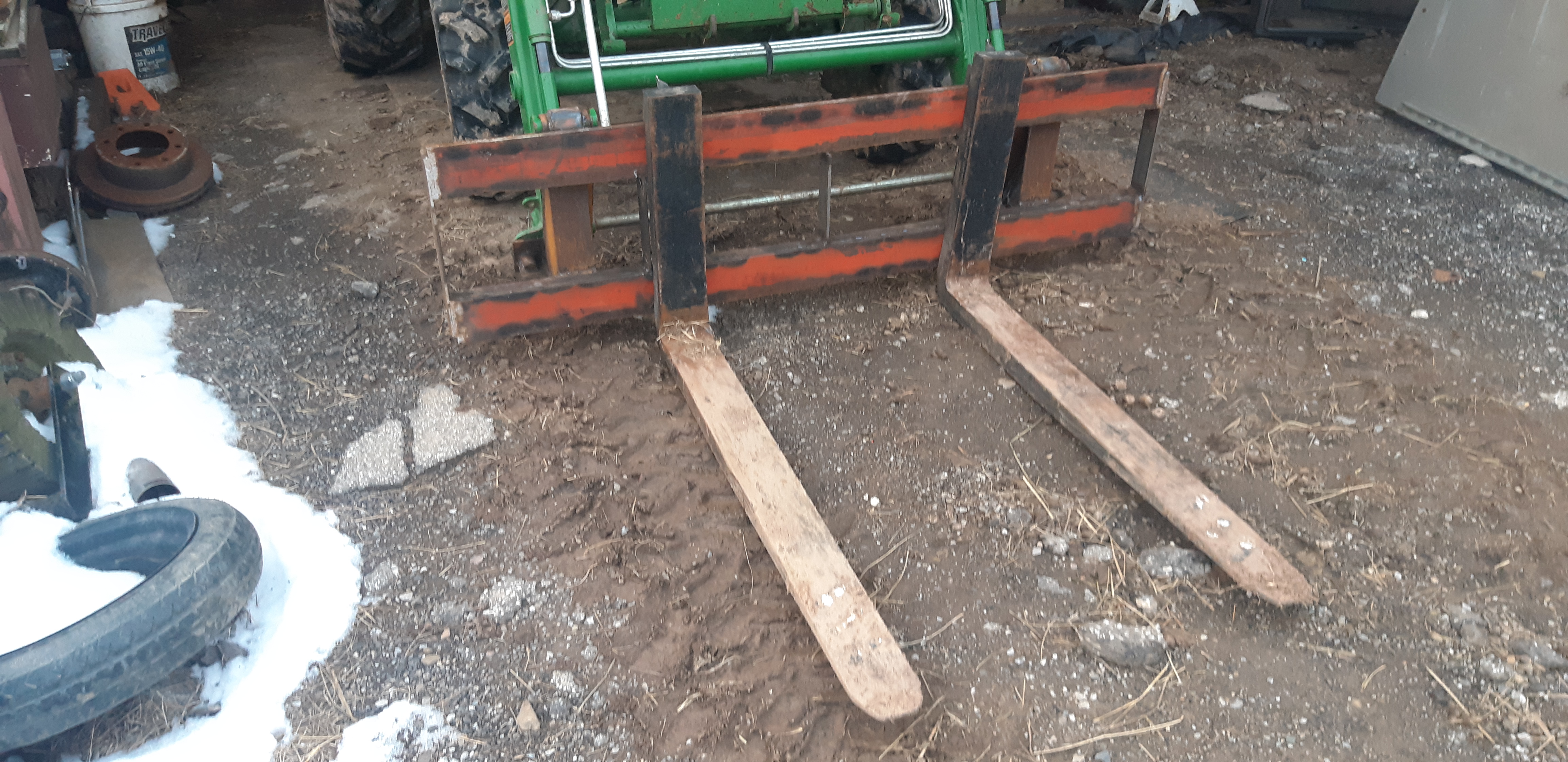

I salvaged an old set off a fork truck from work and built my own frame to match the John Deere quick attach system on my tractor, they have only been off the tractor 2 times in the past 2 months when I needed the bucket to load manure. Otherwise, forks are good for feeding cows round bales, moving logs, I've got stuff on pallets, IBC totes for firewood, truck parts (axles, frames, beds), forks are so much more useful.

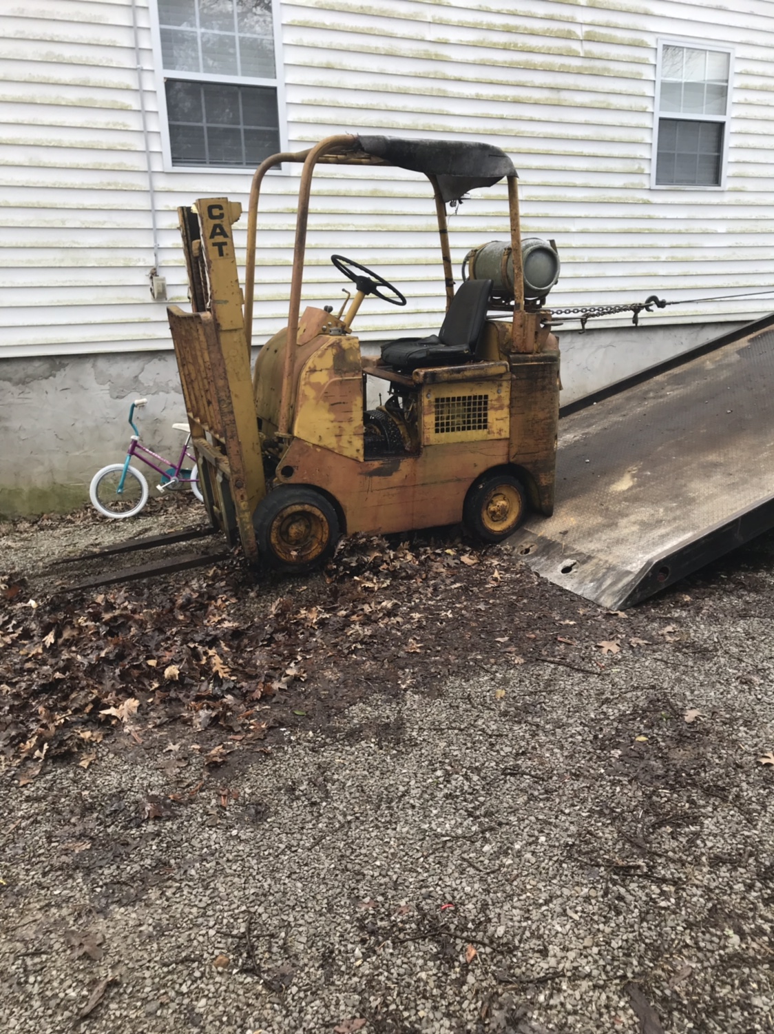

That’s the main reason I bought this junk forklift for $300. I’ll come close to getting my money back in scrap plus I’ve got a good set of forks. It’s got a shuttle transmission so I may see about fixing it. IMG_8384.JPG

Good job on building in extra rollback, shown by the red lines I added :thumbsup:.
Thanks... rollback wasn't the goal (but nice fringe benefit), keeping the level indicator rod accurate for both the forks and the regular bucket was important to me.
4570man, the forklift will offer the forks and the mounting system, I had to fab my own... and it lacks what yours has, the guard above the frame that holds the forks. Looks like yours has a round pin at the top, will they allow down pressure at the tips, or just pivot on the rod?
It’s the track system with a catch at the bottom so they don’t pivot.

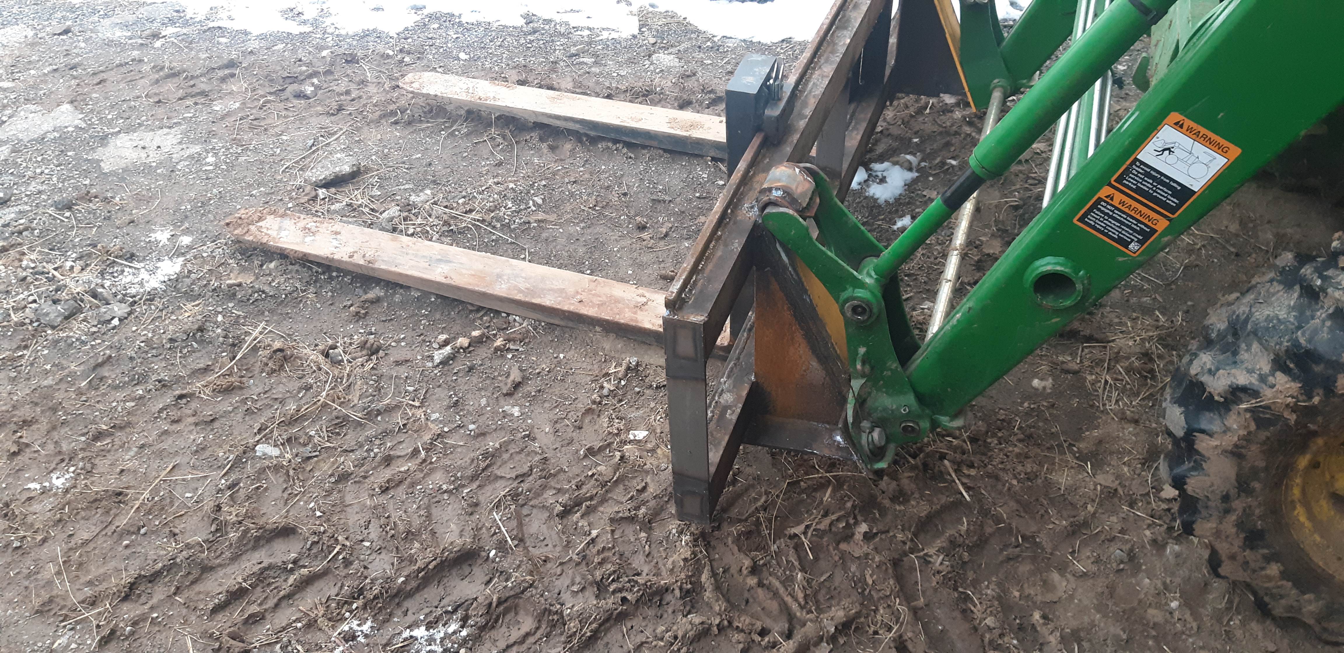

I wanted a set with a quick attach for my GC2610 but the adapters all were very heavy which took away too much capacity for my little machine so I made my own. Just finished them recently so they haven't been used a lot. They aren't adjustable now but more receivers can be added if necessary.
Since this picture, I've also added a short piece of pipe to the top of the adapter in order to move my 5th wheel trailer.

That’s the main reason I bought this junk forklift for $300. I’ll come close to getting my money back in scrap plus I’ve got a good set of forks. It’s got a shuttle transmission so I may see about fixing it. View attachment 649572
That is a very wise investment! Even though I have SSQA forks I would be tempted to get a dedicated forklift for less than $1000. Useless in the winter or in the woods but so handy for moving stuff around the homestead. All my wood processing is done in an area I can use a forklift. It would be handy to use the grapple to handle logs and have the forklift to move the IBC totes I use for storage.
Nice job 🤙
