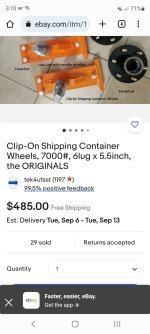

Would you be moving it empty?
/ Shipping container axles adding? #6
For minimal around the property trips to get around code just weld some axle stubs to it and have the wheels barely on the ground.
/ Shipping container axles adding? #7
Folks, has anyone here added axles to there shipping container to make it readily moveable?? I've been working on some 20ft versions at work and noted one in town the company had added three axles and hitch to. It looksed rather nice and said they'd done that just to make it easier to move.
They have removable container wheel kits that use the corner post attachment points.

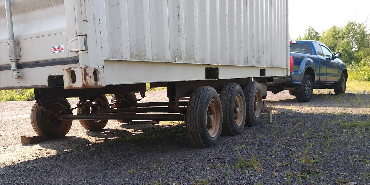

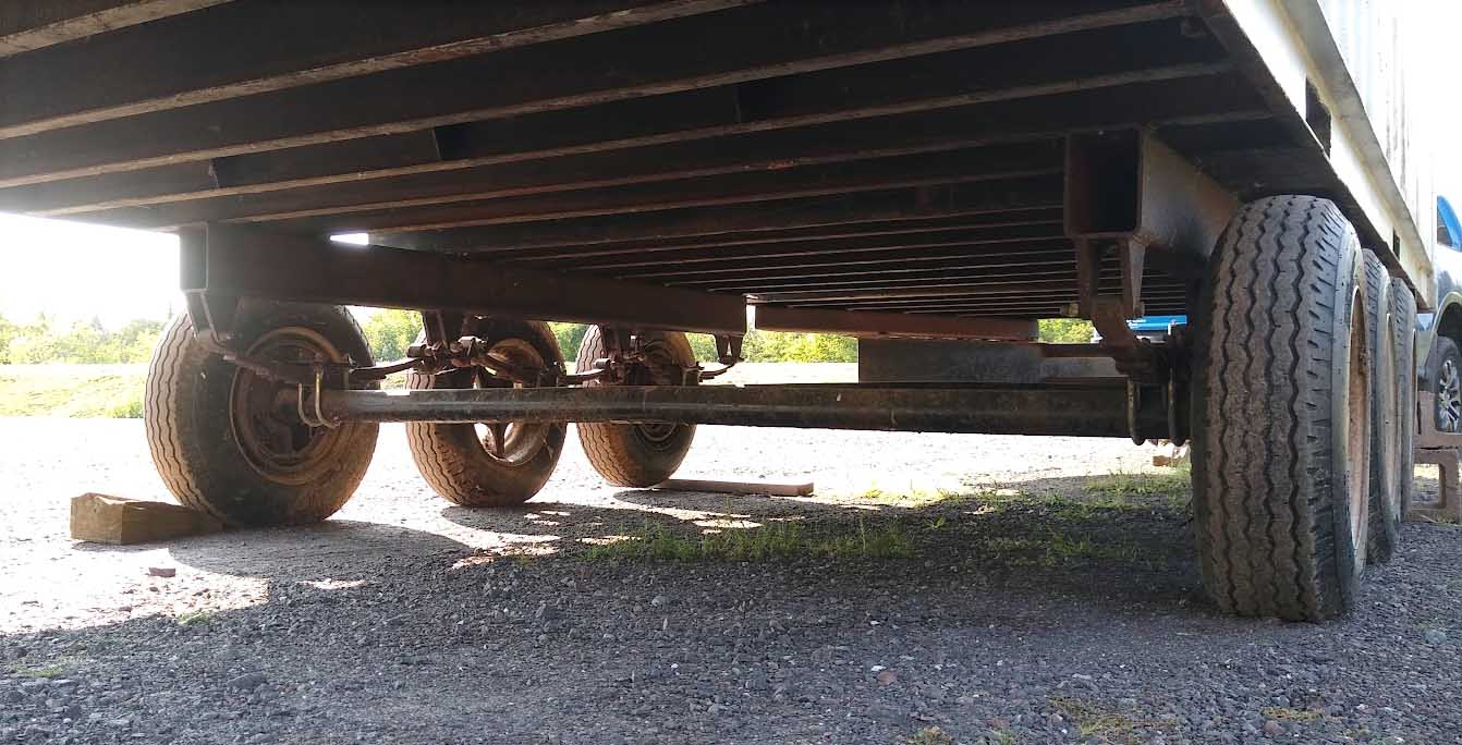

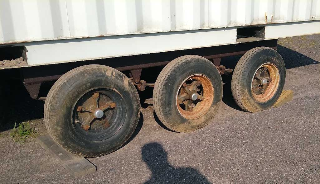

Here is the one parked at a nearby business. The trailer-home axles didn't make it has high off the ground as I suspected they would. Across the rear, some platform would be needed so we could easily open it and machine ramp could be left on it.

The containers are designed to be supported at the ends, where the lifting and tie down points are. I’d be hesitant about adding spring mounts which didn’t transfer load to the ends. But I’m a dumb ole engineer who knows enough to be worried.
For short distances empty, I would spend the $500 they are asking on eBay for an axle kit which ties into the tie down sockets on the container.
/ Shipping container axles adding? #20
Here is the one parked at a nearby business. The trailer-home axles didn't make it has high off the ground as I suspected they would. Across the rear, some platform would be needed so we could easily open it and machine ramp could be left on it.View attachment 759867View attachment 759866View attachment 759865
Cheap junk axle assemblies out from under "mobile home"..... Original designed to get "mobile" from factory to its intended site, nothing more....
