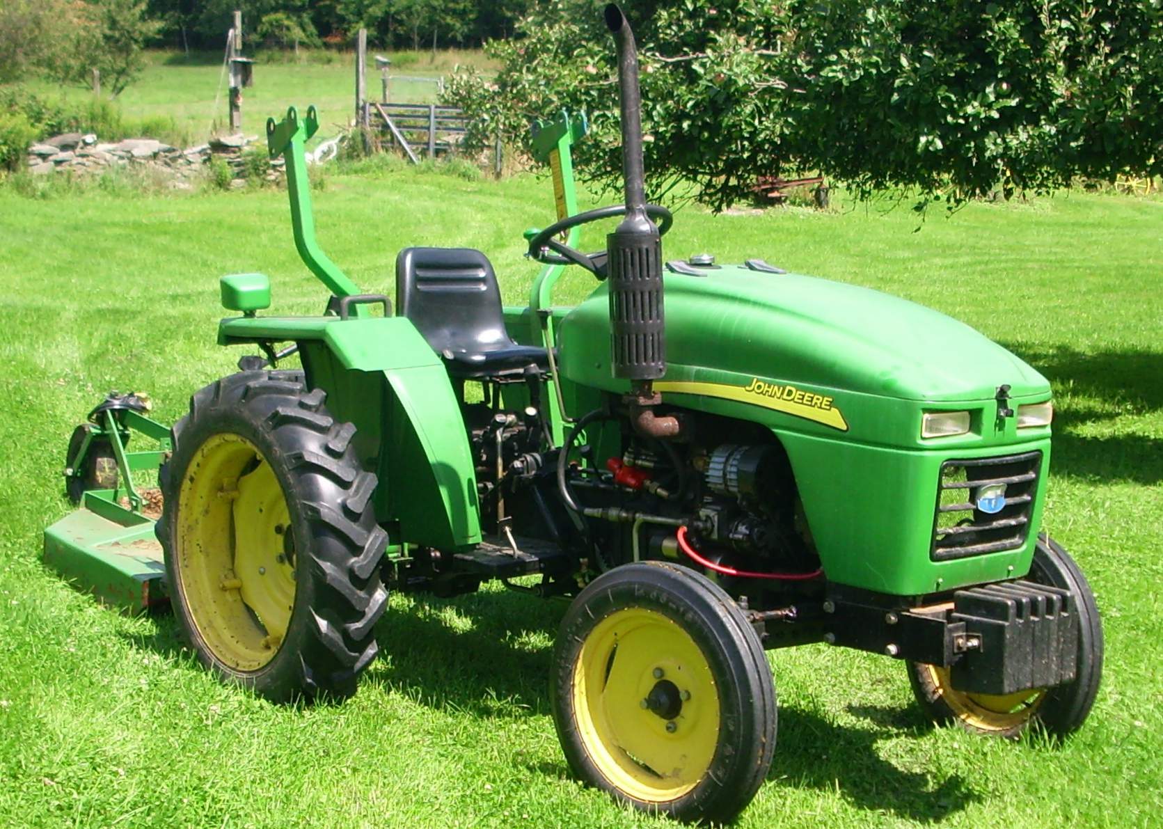

[ATTAC jinma001_zpscbddb177.jpgH=CONFIG]332821[/ATTACH]
Currently selling my JM 180 for $1900

/ SHENNIU 25 ?? #8
Yes
I just thought Soundguy may be interested.
