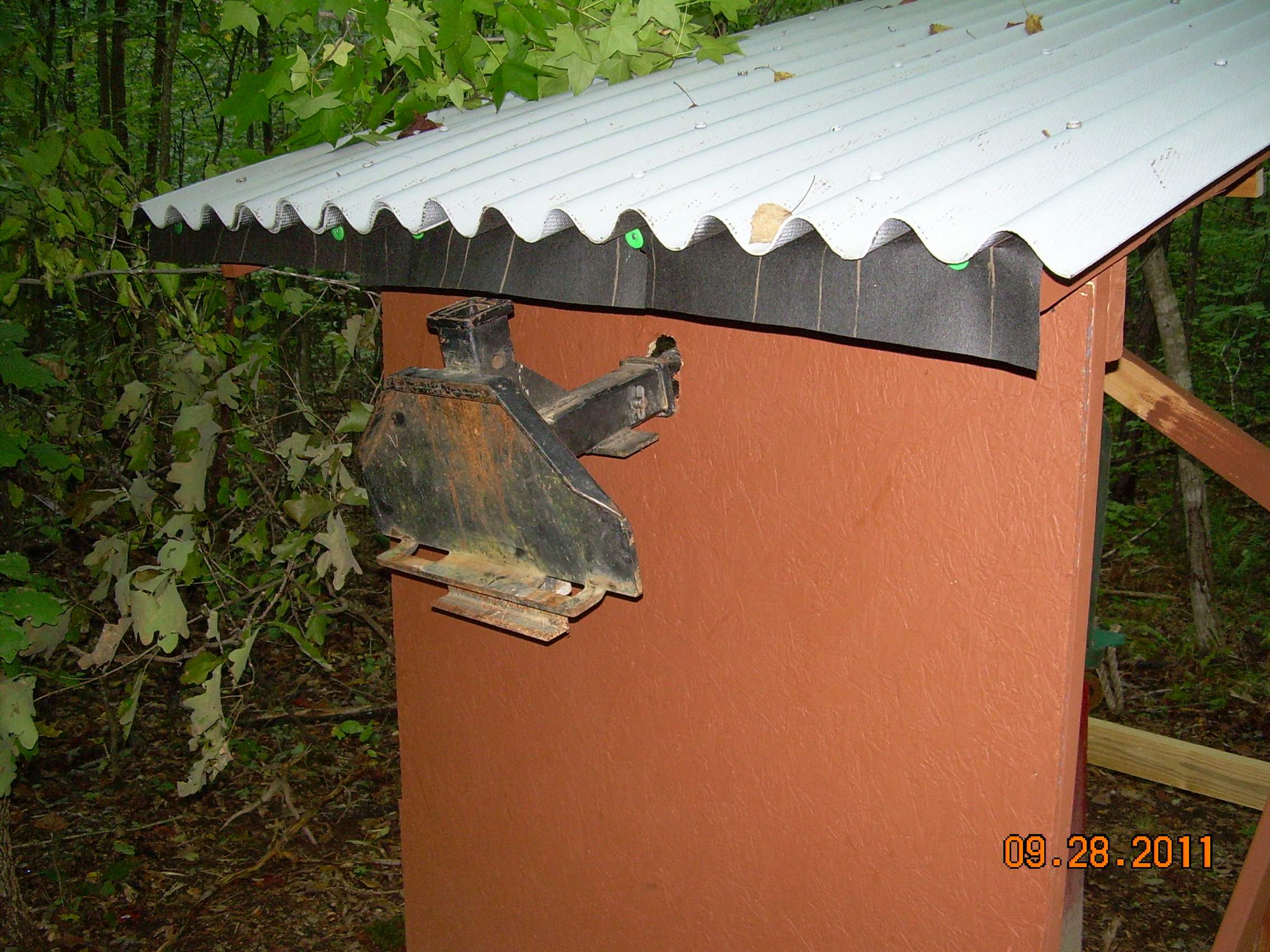

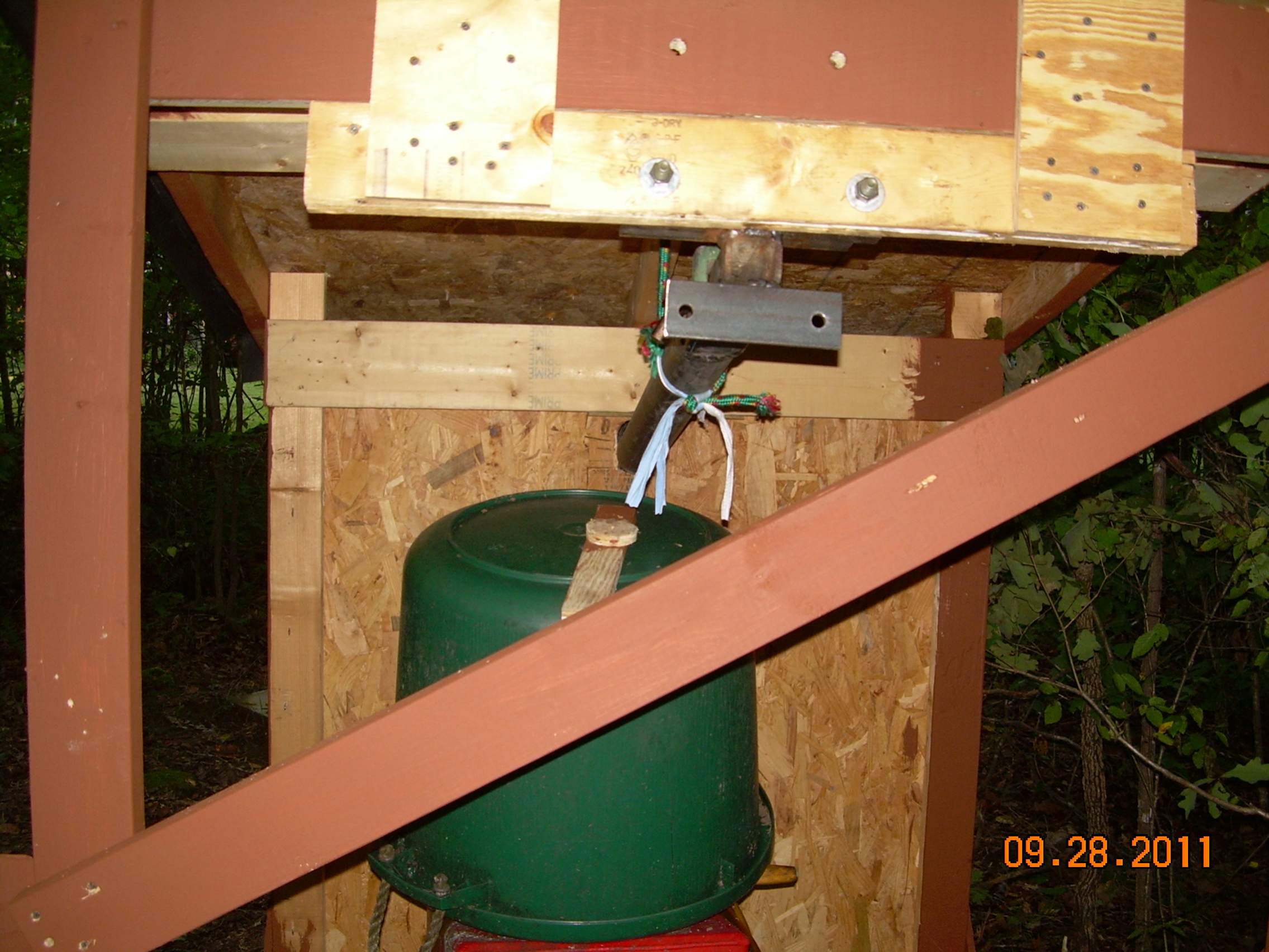

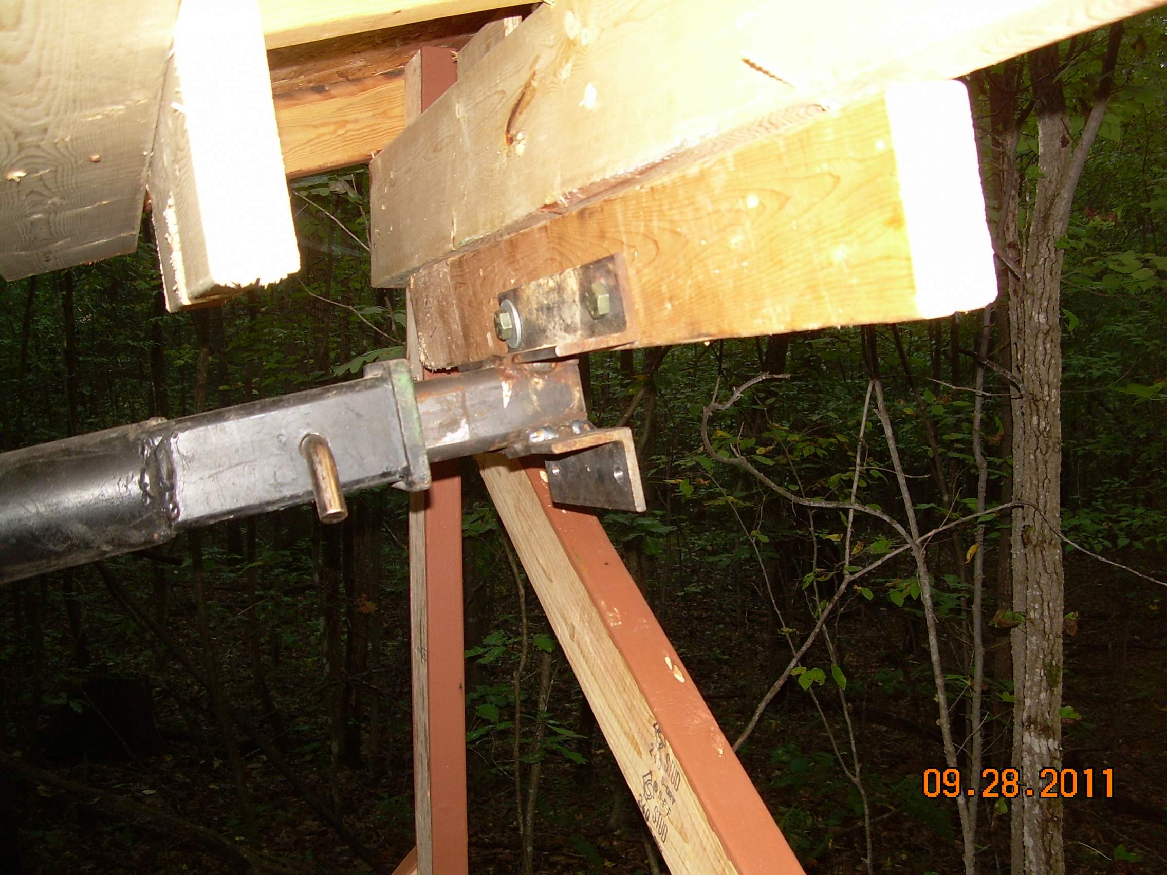

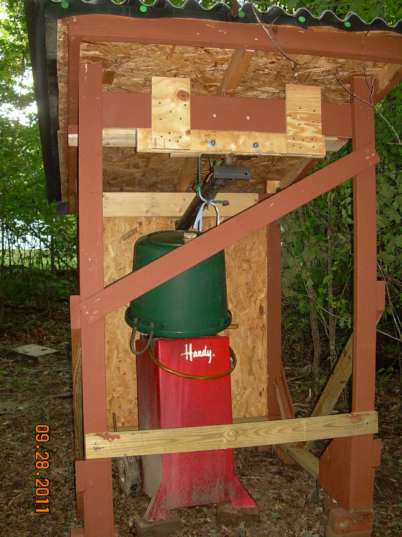

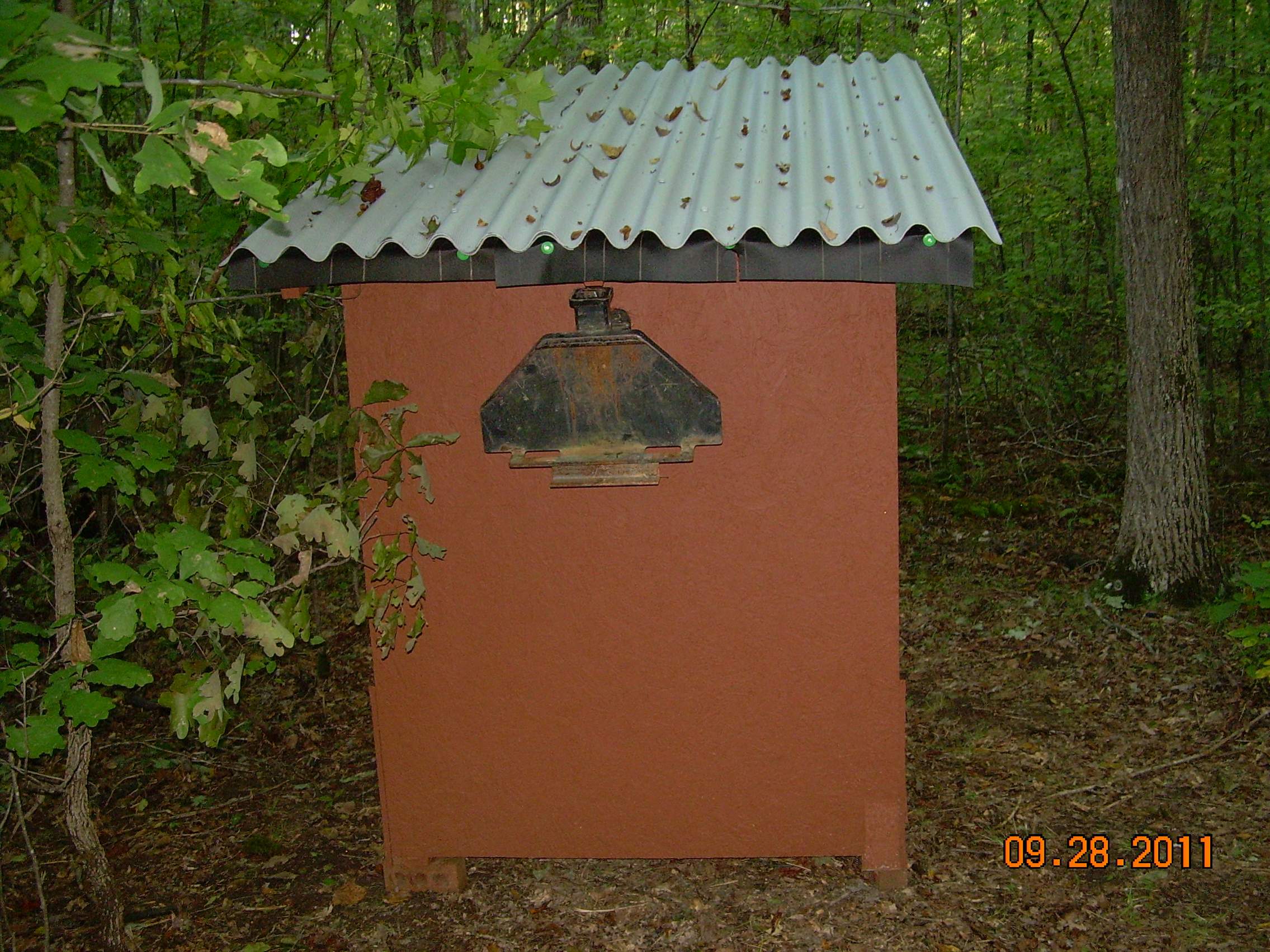

I have been wanting a shed, basically a roof, to keep rain off of my thirty gallon gas tank. Recently after hurricane Irene, I could not run my generator until the rain stopped. I wanted to build a generator shed near the house, but the wife has a limit of two outbuildings on the property, and I have three. She does not mind if they are down in the woods. After much thought I consider making a very small shed to cover the generator. This would be something I could move easily. I realized that the Power Trac could move it. So I made a shed that has a boom pole going through it. I can connect the boom pole through the two inch receiver quick attach plate. Now I store the gas tank in it most of the time and move it to near the house right after a storm, if needed.

is the shed hurricane rated? :laughing: It might be ripped to shreds before you had a chance to use it.
/ Shed? PT Attachment? Both!
No, it is not hurricane rated, and that concerns me. My rational (weak as it is) is that I live in a valley and the shed is in a thickly wooded area. This should help shield it from wind. Also I do have some pieces of rebar bent to L shape nailed in the ground to help hold it down. Right now they are too short and I can pull them out too easily. My plan is also to run a rope over the roof and tie it down to trees during a storm.
