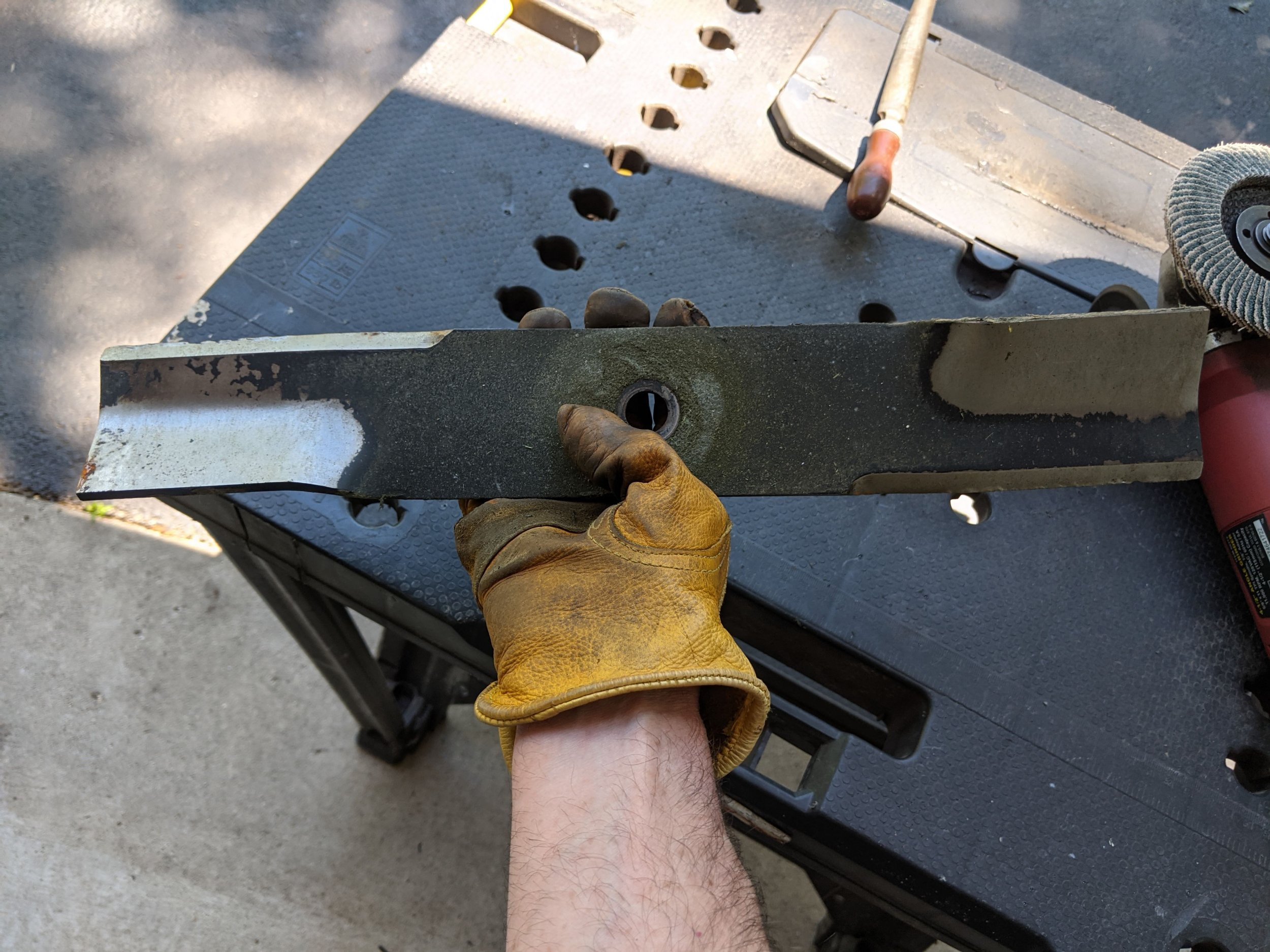

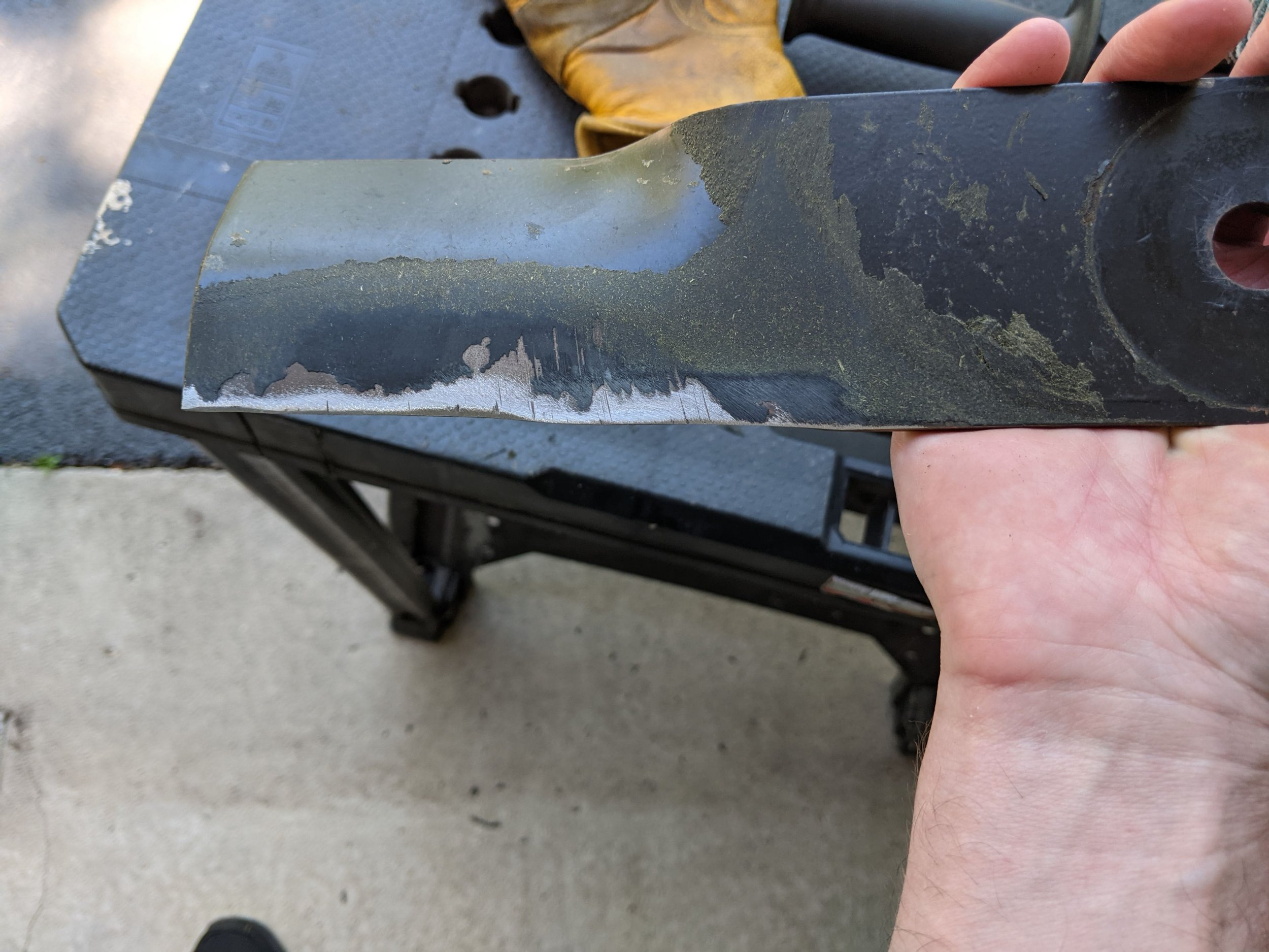

Well hey, I don't hate on anybody for buying a tool of their choosing, but how would you screw up your blades with a grinder? People overthink things a lot of times. The 30 deg angle cutting edge is a guideline, but guess what the tolerance to that is not 0.003" or anything. Your blades will cut just fine if you're over/under that, I mean even by a lot. Doing it by hand will, yes, likely curve out that cutting edge a little bit eventually...but that's with you sharpening them like a bunch of times, way more than several times. And even then they'll still work fine enough.
This is a jacked up blade which I knackered when mowing my neighbor's yard as a favor (whoops, she had some not so nice things hidden in that tall grass). Look at that chewed up cutting edge!:
This is the backside of it after I ground out the jagged cutting edge. Looks how curved out that cutting edge is. Cuts just fine, tho:

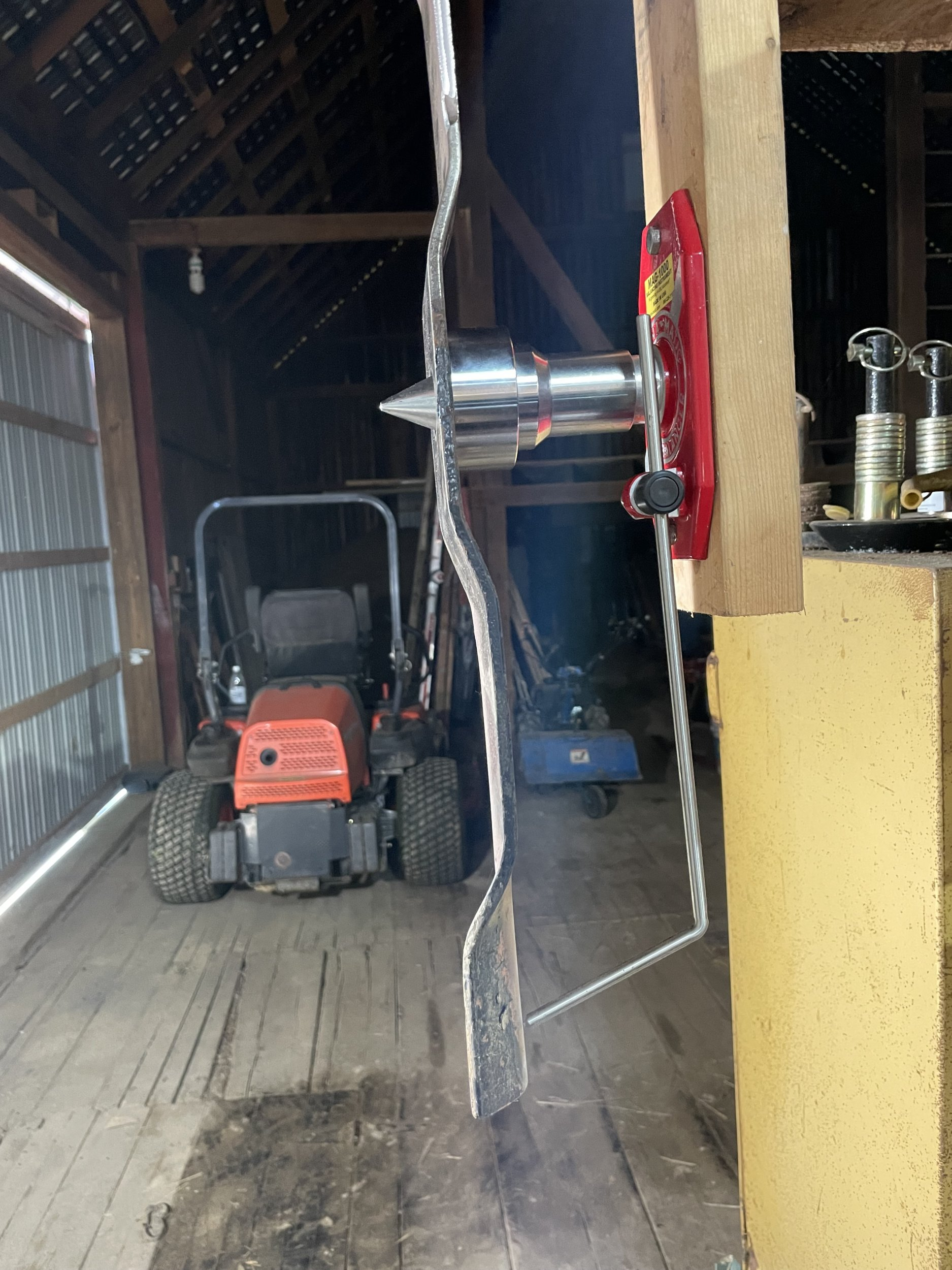

BTW do I need a fancy balancing gizmo?

I've never sharpened a blade before, but then again I've never had a deck that cost me over $100 to replace the blades on before, and going up every time I look. There are no alternative blades available, only the OEM parts. My main concern would be blade balance. I've read that it can cause bearings to wear out faster and spindle damage.

I take it you got that 60" deck, right? That's the problem with Massey's deck, I could never find alternate blades for it either. Other problem is that you can't mulch with it (even if you were able to find mulching blades for it).
Anyways, just get this, Hube: https://www.amazon.com/gp/product/B000VYKS1Q/ref=ppx_yo_dt_b_search_asin_image?ie=UTF8&psc=1
8 bux, and you're good to go. Some people hang them on a nail to check balance, but that won't work on your blades coz the hole is a star pattern (plus that's not a great method).
Some people just count the number of times they run a grinder on one side of the blade, run the exact same number on the other side, call that a balanced blade...and never run into any problems with their spindles (or notice unusual vibration).
But anyways, here's how probably 90% of commercial landscapers do theirs:
