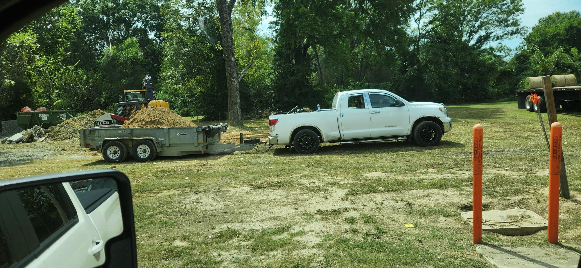

Caught this one while out at lunch today. That trailer is riding a little low in the front.
