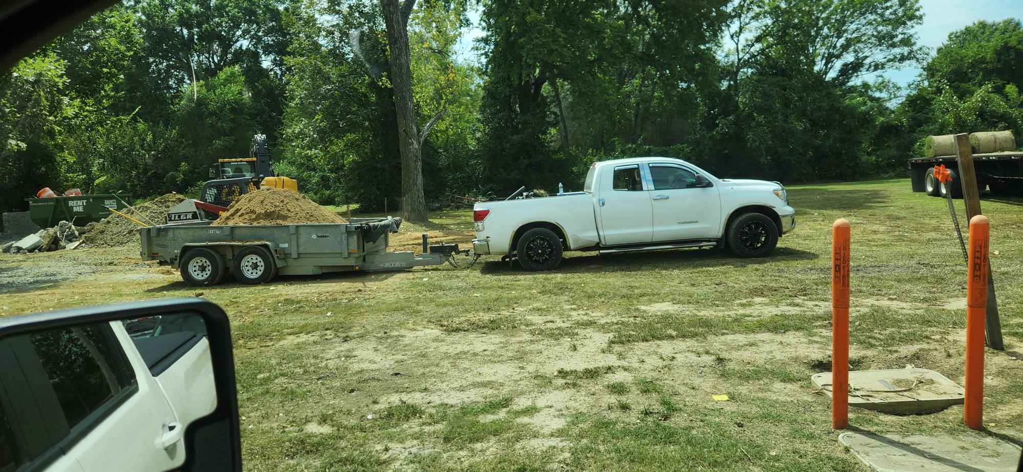

Caught this one while out at lunch today. That trailer is riding a little low in the front.
Dry topsoil is around 1 ton per yard, up to a ton and half per yard when wet. I'd guess there's 4 yards in that trailer, assuming it levels off at 12' x 6' x 1.5', so at least 8000 lb. payload, on what appears to be a 10k trailer... as you don't see many 7k lb. dump trailers.
Soil appears relatively dry, so why is the trailer squatted so hard, with the tires almost rubbing the fenders?
As to the truck, 10k gross trailer (payload + curb) means 1000 - 1500 lb. tongue weight, on a truck probably rated 1000 lb. max tongue, before length of hitch itself. And I suspect they recommend WDH on anything over 700 lb. tongue weight.
