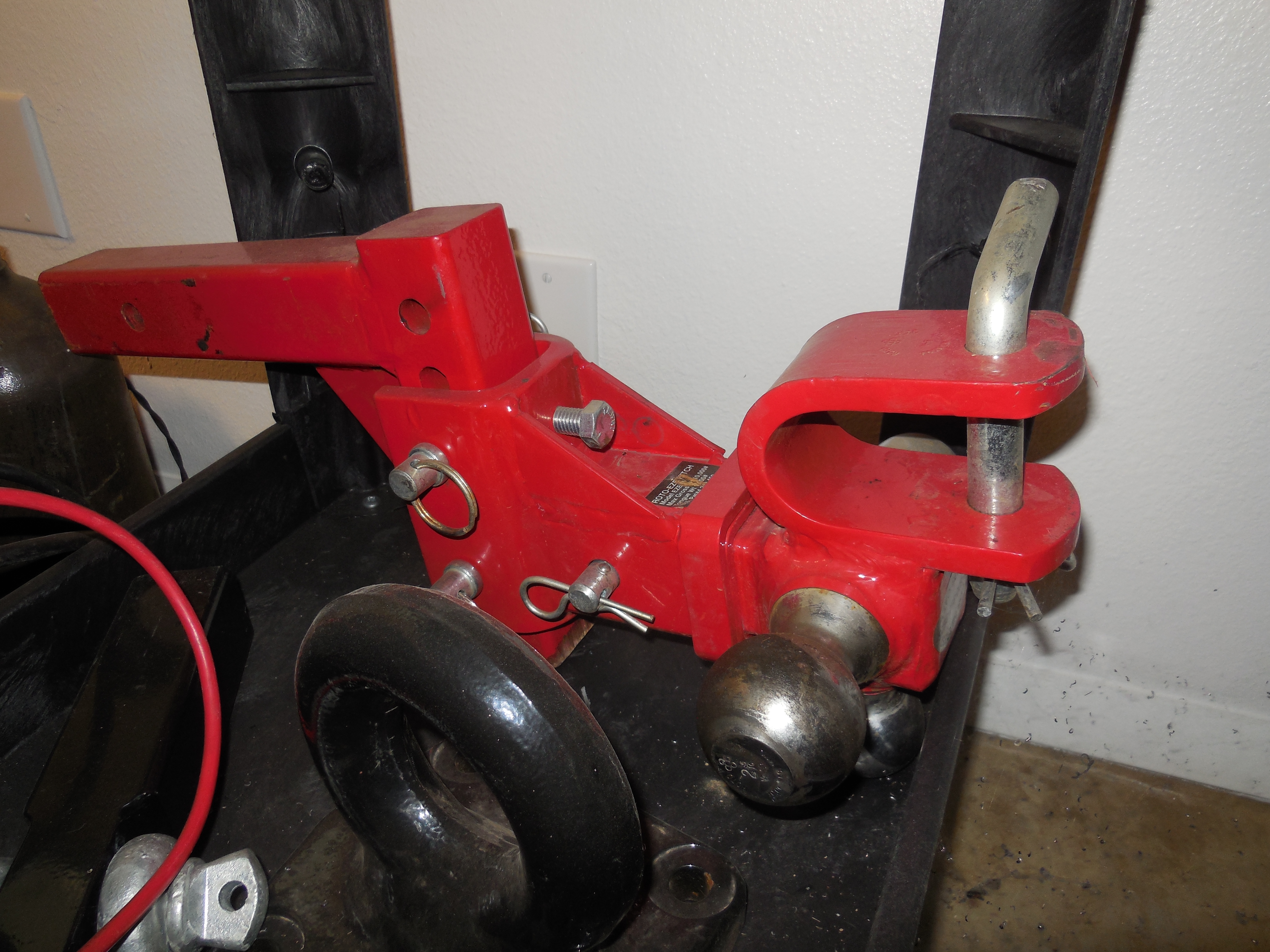

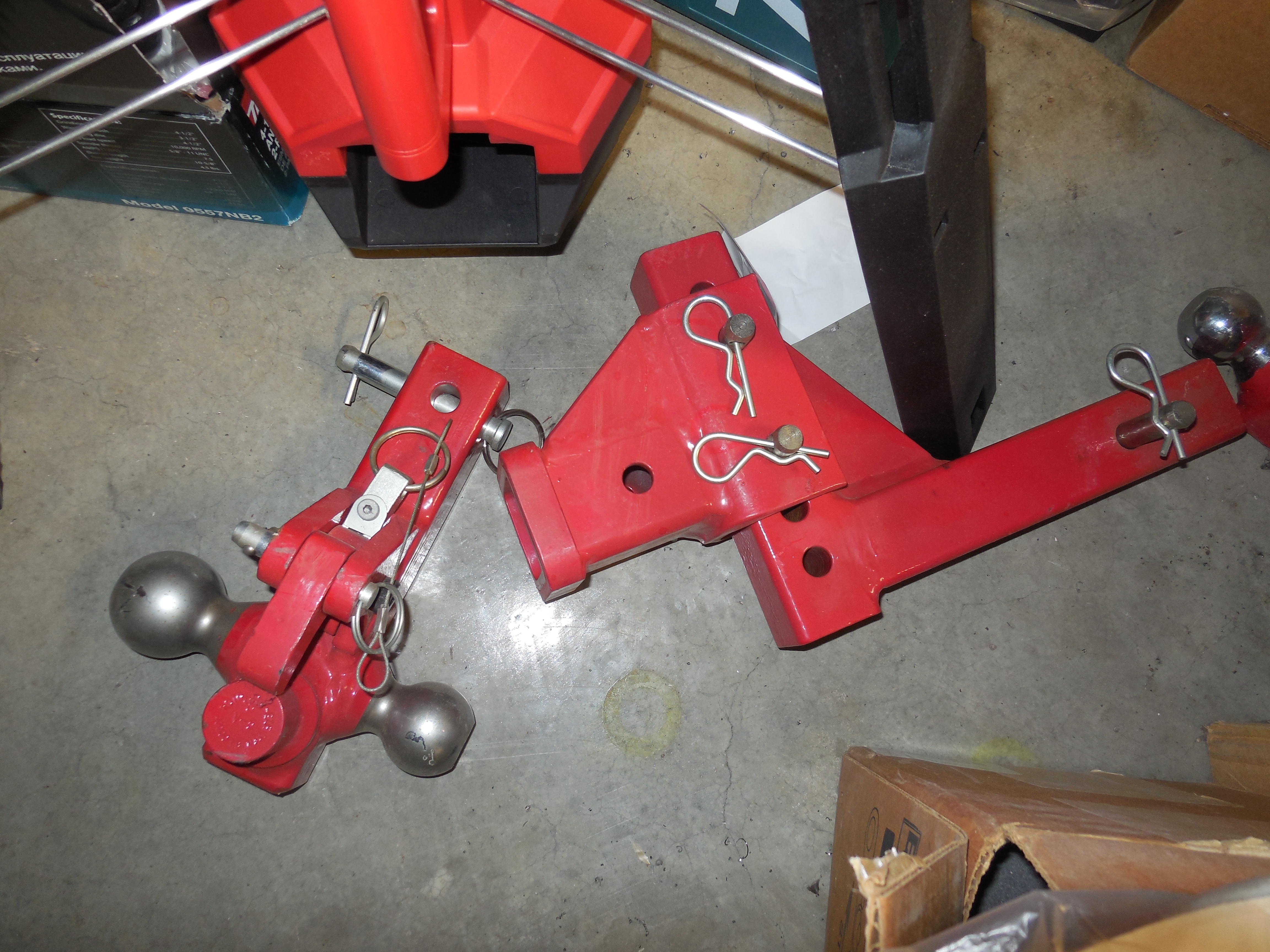

Those things look wonderfully convenient for the rare person who's truck and trailer are near the same height. I've never been that lucky, and run drops of 4" to 6" between my current truck and various trailers.
There are adjustable versions and I have a few, I just don't like using them.
Instead, making the trailer match the height of the receiver minimizes the torsional stresses on the receiver.
