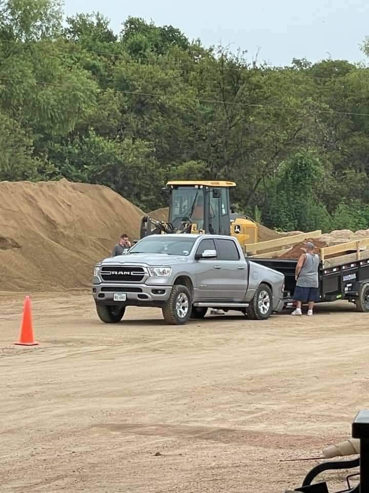

It looks like a single axle 10-12' trailer to me. The middle vertical of the wood extensions on the driver's side comes down in the middle of the visible wheel, and the front half of that wood looks like about 5' long to me when comparing to the guy standing there, so I doubt there's another axle.
This reduces the likely load in the trailer, but increases the probability that an unbalanced load will vastly increase the downforce on the truck since it's not shared between the axles.
This article mentions how even pulling a normal sized trailer can cause a frame break if a bump is hit. I'm wondering if this 1500 wasn't loaded somewhere else in the yard and they hit a bump as they were driving through the yard on their way out? It's not obvious to me that the trailer was loaded right there.

^ yeah.... you're right. I see no evidence of a loader squash. But even a full yard or 1.5 yard dumped at once should not buckle a new pickup frame.
Alternate theory. Was the ram lifted with aftermarket suspension? That front looks pretty high, even given the situation. I dunno, I'm stumped.
I tried to zoom in, but can't verify if this is the 1500. I have a 03 RAM 5.7 HD 2500 Quad that literally does pull loads like this with no issues. I just pull up to the sand quarry and load up. Like wise with the gravel.
Oddly, the pix doesn't tell enough of the story. Is that trailer a single axle? Indeed it would then put too much tongue weight on the truck. 2 or 3 axle trailer is ideal.

It’s a 1500 truck. It’s got 6 lug wheels.

I should have known that, my bad. Actually bad for the guy who was making his 1500 act like a 2500.
The RAM 1500 is more like a toy. They have the looks and possibly the power, but no guts (suspension) to pull a heavy load. The 1500 can keep it's MDS to be a gas sipper, the real RAMs of 2500 & 3500 do the real work.
