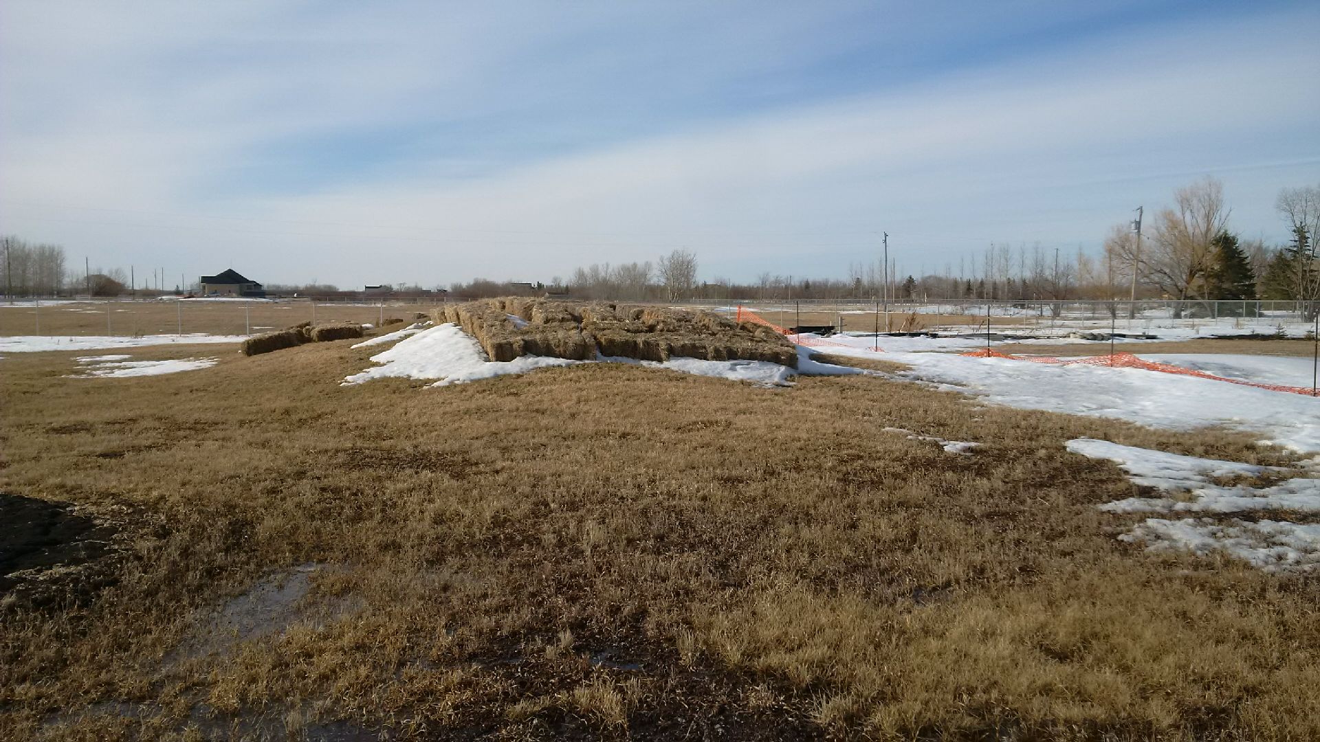

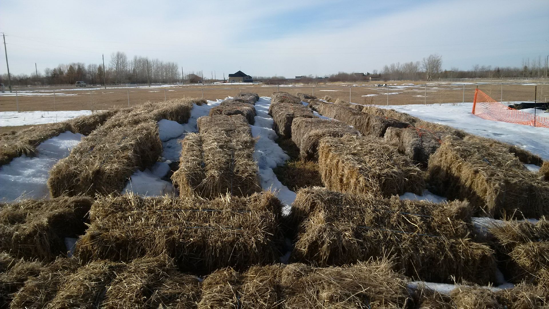

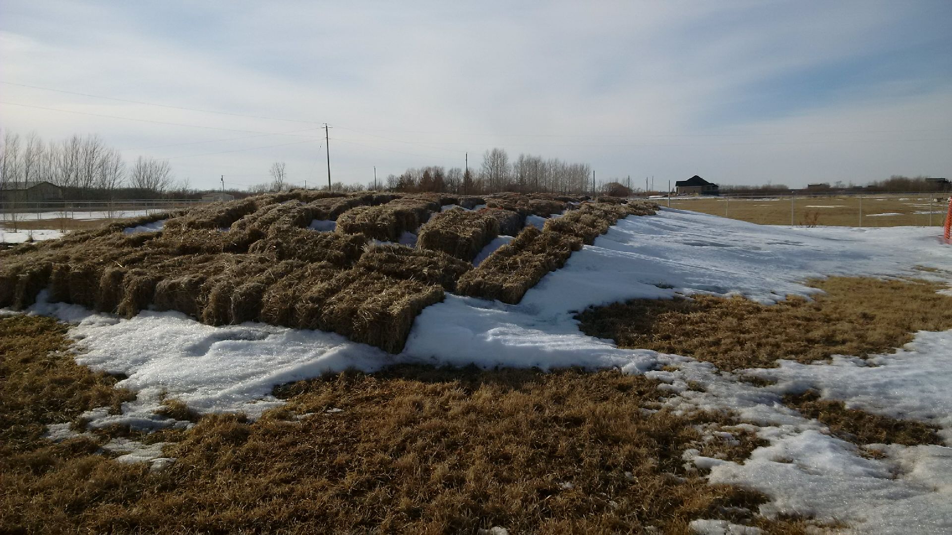

I have some pictures of my coverage on the field as i said i have a total of 90 bales: 4 rows on top of my field lines and spread out 2 rows on either side and 2 rows around the distribution line. Note: the second photo shows that i have moved the bales over to the left as i am trying to thaw that area with the warm sun, the bales are set up in a straight line.
There are 2 of us in the household who come from homes with fields therefore we arent really new the septic field living however this field is different as its a sand mound vs the old rock mound. The field was built in 2009 there were no issues to my knowledge with the previous owners and the first winter we moved in we had no issues, this year and last year (2 out of 3 winters) it froze, last year it froze in January this year March.
We do not use bleach/javex as we are aware of the bacteria required to keep the field warm. Our daily routines are a shower everyday each sometimes a second shower, laundry every 2 weeks (cold water washes) dishwasher every few days.
My answer maybe additional coverage however as i said earlier in one of my posts i already have 90 bales how many more do I need....the norm around here people only have maybe 20 bales, some people dont use bales and just use snow fence.....

Based on what you just told me it sounds like you are not putting enough effluent into the field for the size of the of the mound. They sized it to the size of the house/number of bath rooms, then with the both of you gone during day and night it is freezing. Haven't had a chance to look at the pictures, but based on the width of the mound it looks like you have three laterals. If it was mine I would consider shutting off the outer two laterals. Dig down put shut off in then, PVC pipe so you can get your hand down to shut it off, and so you can turn back on, when you get more people in the house. Then use timer control like I suggested Cover like you have been. Timer control by its self won't work your not making enough effluent..
