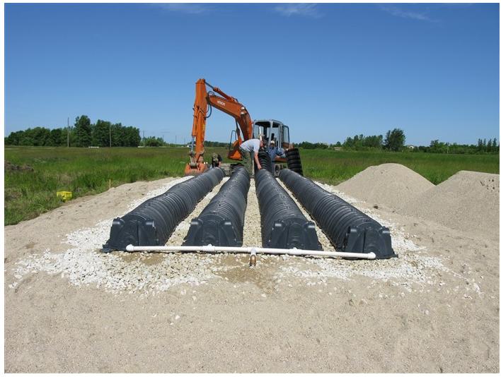

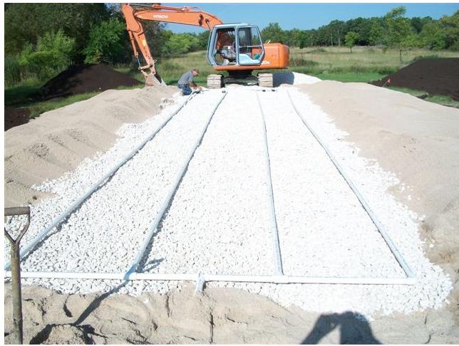

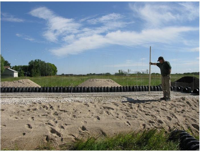

I will try to give more information:
-my system in a new type sand mound it is positioned 4' ABOVE the surrounding ground, apparently this is the new way of doing things around here. The construction of my system is as follows: small amount of excavation on the ground level, crushed stone, 1-1/4" rigid line with 1/8" holes perforated, mound chambers, and backfilled with sand and a layer of top soil to grow grass. My DF lines are basically sitting level with my existing landscaping (maybe 6-8" above max) at the end of my DF there are access caps (threaded caps on the pipes) these access caps are to allow the DF holes to be cleaned out or frost removed. Therefore the new systems do no have the same amount of ground coverage that the older systems do.
After my high level alarm in my septic tank went off sunday I checked the operation of the pump to ensure it was not jammed or the float was not working, after i verified all was working I went to the field removed bales to access the access caps, i unscrewed the caps and they are solid full of ice.
I feel that my DF is freezing because of exactly what you said: you have freezing problems in the DF because the effluent either remains in the lines or soil long enough to freeze.
I know the lines have a good slope because in the summer I have the lines "flushed and cleaned" with all access caps removed you can clearly see the effluent flow to the end of the field out of the access caps, with the access caps on it "pressurizes the pipe and allows it to bleed from the 1/8" lines"
I feel the ground around the field might be saturated and i dont have enough of the surrounding area covered to prevent the run off from freezing and eventually working its way up and it finally has no where to go....

The system is pumped, I have a 2 chamber holding tank (solid side and liquid side) the liquid chamber tank holds the pump and pushes out to the field, there is NO evidence of ice build up inside the tank.
What kind of pipe is in the field ? If it is sock pipe , you may have an issue . That was the rave 20 years ago . It plugs with grease and will not drain . Terrible product . You need the open bottom chambers .
the pipe is 1-1/4" solid pipe with 1/8" drainholes and covered with mound chambers.
I have some photos of how this system looks during construction:

I don't profess to know anything about septic systems, but that seems like a really stange approach to building one. Everything is above grade!
/ septic field frozen #11
That 1-18 pipe is too small . N eed 4" That is called a mound system where the ground will not perc . They set it up above grade then backfill the sys tem .

In normal soil, frost has to overcome the typical ground temperature as it works downward. You don't have that reservoir of ground temperature in the mound really, at least not the same as native settled soil. So I bet the mount has a significantly less frost resistance than the ground. If you have a 6' frost line in regular soil, I don't see how a 4' mound of sand/stone has a chance, even with bales of hay on top. Maybe there is a better way to insulate the mound from air temperature above so that it can trap/hold some ground temperature, but I have my doubts.
