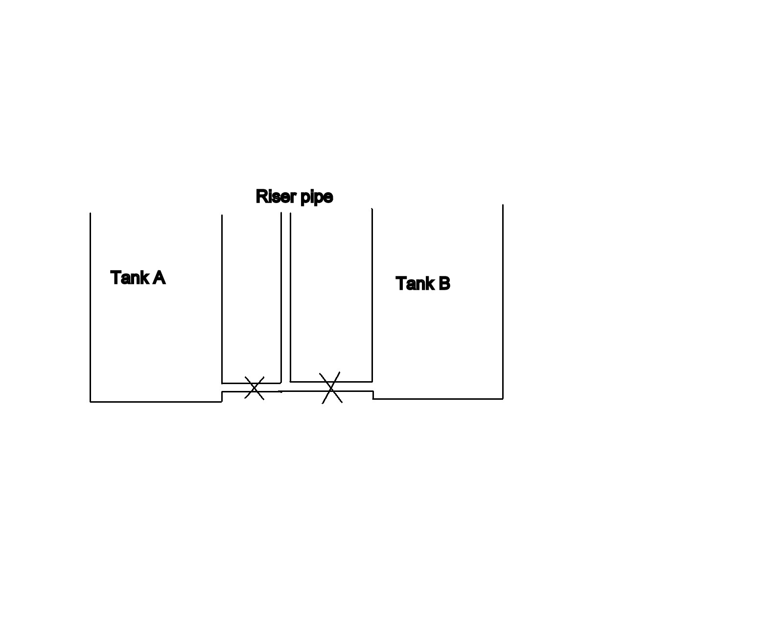

I am helping a friend protect the pump for his above ground cistern by adding a water level sensor. It is actually 2 cisterns under their deck connected together via about a 3" pipe. To keep it simple I am suggesting adding a saddle Tee and with a riser pipe attached (see drawing) and sensing the water level in it. They generally draw on one cistern at a time by closing one of the valves. There is very little head space between the cistern top and the deck so inserting anything long in the riser pipe is not easily done. I expect to use a 1.5 to 2" diameter riser pipe. To keep maintenance easy I want the switch to handle the 125 VAC direct to the pump. I have looked into optical and non-contact sensors but I would like to get opinions from TBN first. Any suggestions are welcome.

Without knowing more about the setup, I'd drop a sump pump with its own switch into one tank and call it good. Plug the pump in or have it hooked up through a switch when you want water. This is assuming the pump is for watering flowers, etc. and won't be dead-headed. (Or there's a pressure switch to kill the pump)
If it's a pump that needs to keep a system pressurized, drop one of these in the one cistern:
Everbilt Tethered Float Switch with Piggyback Plug-TFS13D161P1 - The Home Depot
Either way, no water and the pump won't run. No reason to tap a tee into the equalizing line.

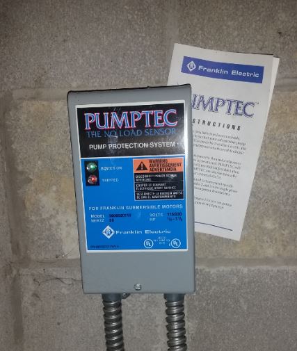

You can sense water level till the cows come home. What you really need is something that shuts the pump off if/when it runs dry.
I use Franklin Electric Pumptec in my cistern. It was originally installed in my (now failed) well because the pump pushed more water than the well could produce, so this device would shut off the pump when the "well ran dry" which was everytime.
Now it's in my cistern to protect the pump in case I let the water level get too low.
Pumptec Family | Residential/Light Commercial | Drives & Protection | North America Water | Franklin Electric
Don't know if this is what the OP wants, but thought I'd mention this because it was mentioned - Brian

I may have to go with the float switch Prichard recommended (that's what I have in my cistern) but my friend draws on his tanks one at a time (one valve closed) so that would require 2 floats switches (unless he changes his mind). I was hoping to get ideas to utilize the narrow riser pipe, e.g. put an opaque float inside the riser pipe that interrupts a light beam when the water falls to a predetermined level. Maybe that's too complicated.
/ Sensing water level in cistern #15
It sounds like you'd want two float switches, and some way to connect them to the valve position so that only the switch in the tank that the valve is drawing from will switch the pump.
I am starting to see what you are doing with the riser, you are trying to sense height from the pump side of the valves, it eliminates a lot of electric logic. Another advantage of doing that is if both valves are off, then there is no volume in the riser and the pump won't run.
Simplest "empty" float switch I have seen is a tube with a rising float (hollow tube a little smaller) that triggers a microswitch (can be any kind of switch, including optical). If the tank is empty, the float is on (near) the bottom and the switch closes and lights a signal (you could have it either open power to the pump directly, or trigger a relay). As soon as the float is high enough to turn off the signal (let the pump run, etc) it hits a stop. Water can keep rising as much as it wants after that, you don't care--you don't need it to tell you how much water is there, just "more than enough". Example is from a simple consumer grade humidifier.
Other nice thing about this system is the float is tall enough that the switch itself is well away from the water. No reason that couldn't be a rod that sticks up attached to a float, rather than a tall float. Total travel is about 1/2", if that.

Yes you're over complicating it. What size is the riser? How deep?

GLyford, I have seen the tubes with a rising float but I don't have the headspace to insert them, and the ones I have found what I have seen are too short. The cisterns (and riser) are at least 3' tall and maybe a foot of headspace above them.
/ Sensing water level in cistern #18
So put in a stack of 6" tall floats. They only need to float enough to say there is still some water there, not to say that the tank is full.
Just make your stop strong enough to keep them in the tube.
