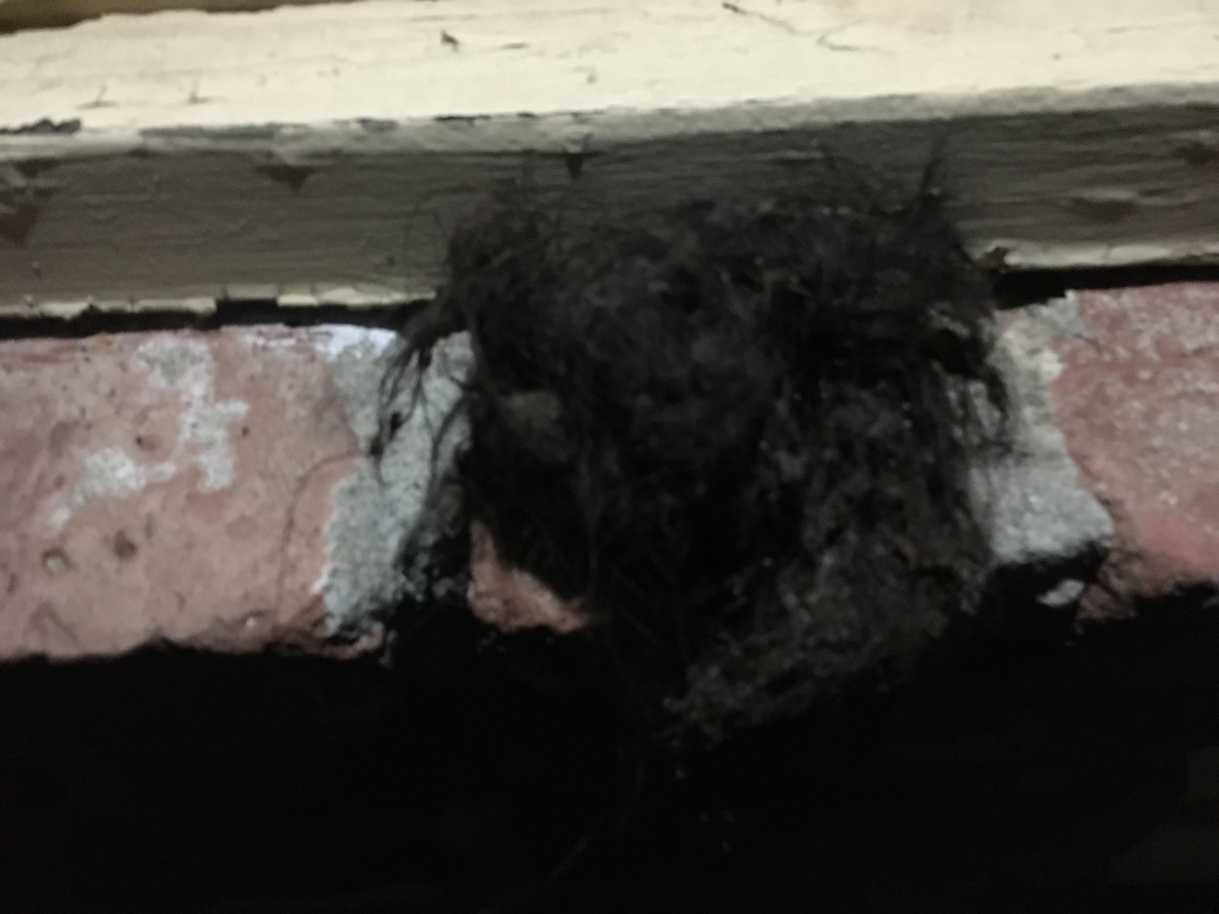

This is the hair ball 11’ in from the tub drain where the horizontal drops vertical…
The odd thing is water under pressure with a ballon would pass but gravity not… had me scratching my head so I opened it up with the battery saw.
Not how I was planning my Sunday afternoon… but got her done.
