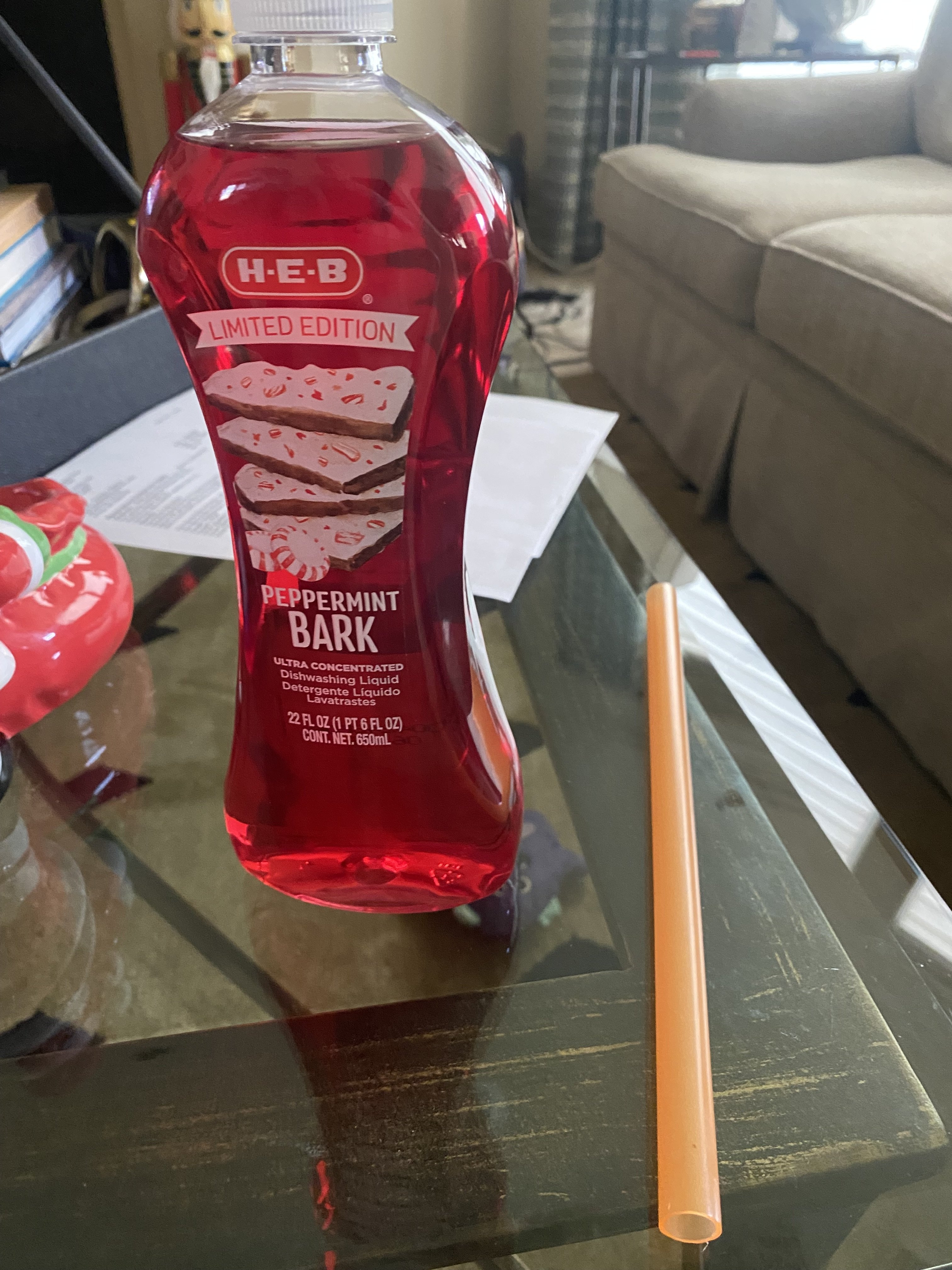

Question:
Does anyone see a drawback against squeezing a plastic container of liquid dish soap into the pipe where the snake auger is stuck to help lubricate the ID of the PVC? I've enclosed a pic of what i am referring. I know there is going to be suds galore, and didn't want to complicate things for flow of water and other.
If there is another option that you've used thst is better than soap, please let me know?
Thank you very much !
Yes, you'll get a lot of suds if you run a hose down there.
Can't the plumber just back the machine away from the pipe entrance and pull the snake out by hand, or is it completely lodged in there? I'd think he could disassemble the machine, detach the snake, untangle the snake until it is strait, then use some wrenches to twist it counterclockwise to get it backed out of the jam.
