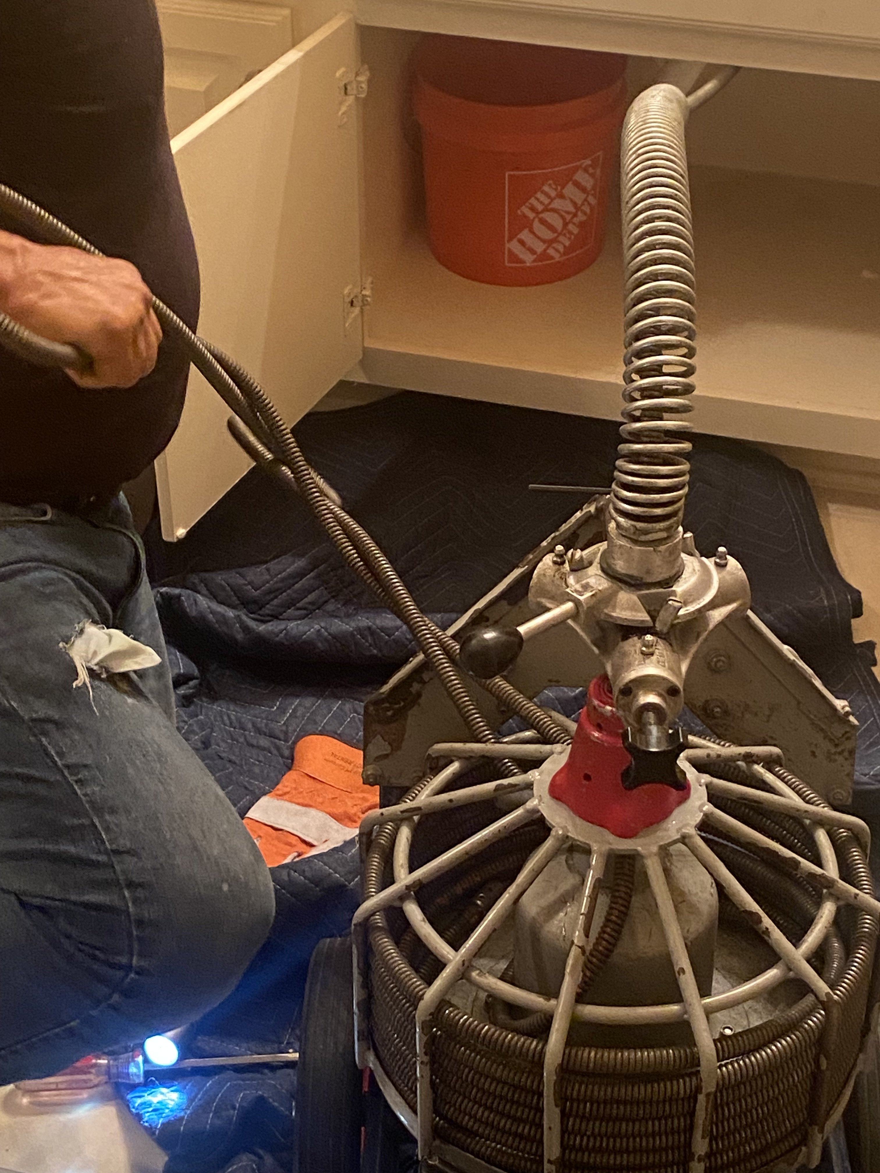

Hired a plumber last night (Sat 830pm) to confirm/fix the issue w my sink not draining. This is also where the AC's primary drain line empties.
The commercial grade snake he rented (see pic) essentially stopped wking bc the line was not coiled back in properly or badly kinked.
He's going to HD 8am to see what they can do, but i have a some pressing questions:
1. Will 30-40 ft of line in the drain system potentially cause the toilets to back up?
2. For any licensed plumbers or similar, do you have a fix or solution for this?
I have a house full of college girls so the tillers & showers will be cranking up soon.
I really appreciate your replies. I'll answer any questions I can.

Thanks. Not sure you can get anything down that pipe now w the snake still lodged 30 ft down the drain. This is also on the 2nd flr of house.
/ Semi Emergency #5
If the snake is busted off in the pipe you could open up the wall wherever the snake and pipe are and cut into the pipe and see if you can yank it out that way. Snaking a pipe is a pain in the ass for sure and if there's stuff in there that can't be broken through with a snake you are looking at serious plumbing repairs anyway so cutting the pipe and yanking out the snake will be the least of them.

I was using a friends 50' power snake on a problematic yard drain, it had roots invading it. Anyway, he calls and said son in law coming over to get it for his house. Fine, I asked him to return it here when done as I was not finished using it. I came back with the snake all Fed up, actually reversed direction mid feed when recoiling. I wound up pulling the whole 50' out and rewinding properly. It works like a charm. Dunno if this helps

Reversing the rotation of the drum can cause all kinds of problems…
The spring has to rotate so it’s always being “Wound”
A couple of guys pulling together might work.
The secret I’ve found is a good operator is able to read the cable and thus able to avoid problems before they happen.
Running a cable looks to very simple but often it’s anything but simple.
Technique plays a role as in starting with a very small spade instead of a large claw just like having water flowing to move the pieces down the line.
Inside a home it’s almost always hygiene products or kids toys… both easily user preventable.
Outside my biggest issue is roots.
/ Semi Emergency #10
Operation is key. I found it best to advance and retreat, advance a bit further and retreat versus pushing through in a single pass. And yes on the water assist if it moving at all.

I'm surprised that a real plumber went through the drain line in the vanity and didn't remove the toilet.
30 to 40 feet sounds like he hit something outside the house. Odds are that it's a root. Especially since the snake is stuck.
I had a house where something similar happened, but they where able to get it out. The one guy that originally showed up started having trouble, so he called in help. Eventually there where three vans, and three guys there, all working on it together. In the end, they located where the issue was in the front yard, and gave me the option of digging the hole myself, or paying them to dig it.
Once I dug down and found the pipe, it was obvious that a root had worked itself into the joint of my drain pipe. And over the years, it had grown to create an issue that needed to be cut out.
The original drain pipes on that house where clay pipe. Probably the worse type of drain pipe ever invented!!!
Before digging, ask yourself if anybody could of flushed something down there that could be removed by a snake?
My grandson stayed with us over Thanksgiving. He flushed some Wet Wipes down the toilet, but my wife thought she caught him and stopped it from happening. My guess is that he kept doing it. The day he left, our toilet backed up. I stuck a hose down the pipe and turned the water on full blast. It took about five minutes, but the block cleared and everything drained to the septic tank.
Last month I had an elderly lady ask me to fix her toilet. It wouldn't drain and she couldn't use it. She is a widow and lives alone, but has grand kids that visit, and a labradoodle dog. After removing the toilet, I found a large piece of bark in the trap of the toilet. Apparently her dog had brought it in and dropped it in there, and she flushed it without knowing it was in there. Usually I find Hot Wheels, Plastic Army Men, and Popsicle Sticks in there that catch toilet paper and creates the blockage.
If he cannot get the Snake out, have him figure out where it's at, and start digging. Odds are good that you'll have to dig there eventually to deal with the issue, might as well start now.

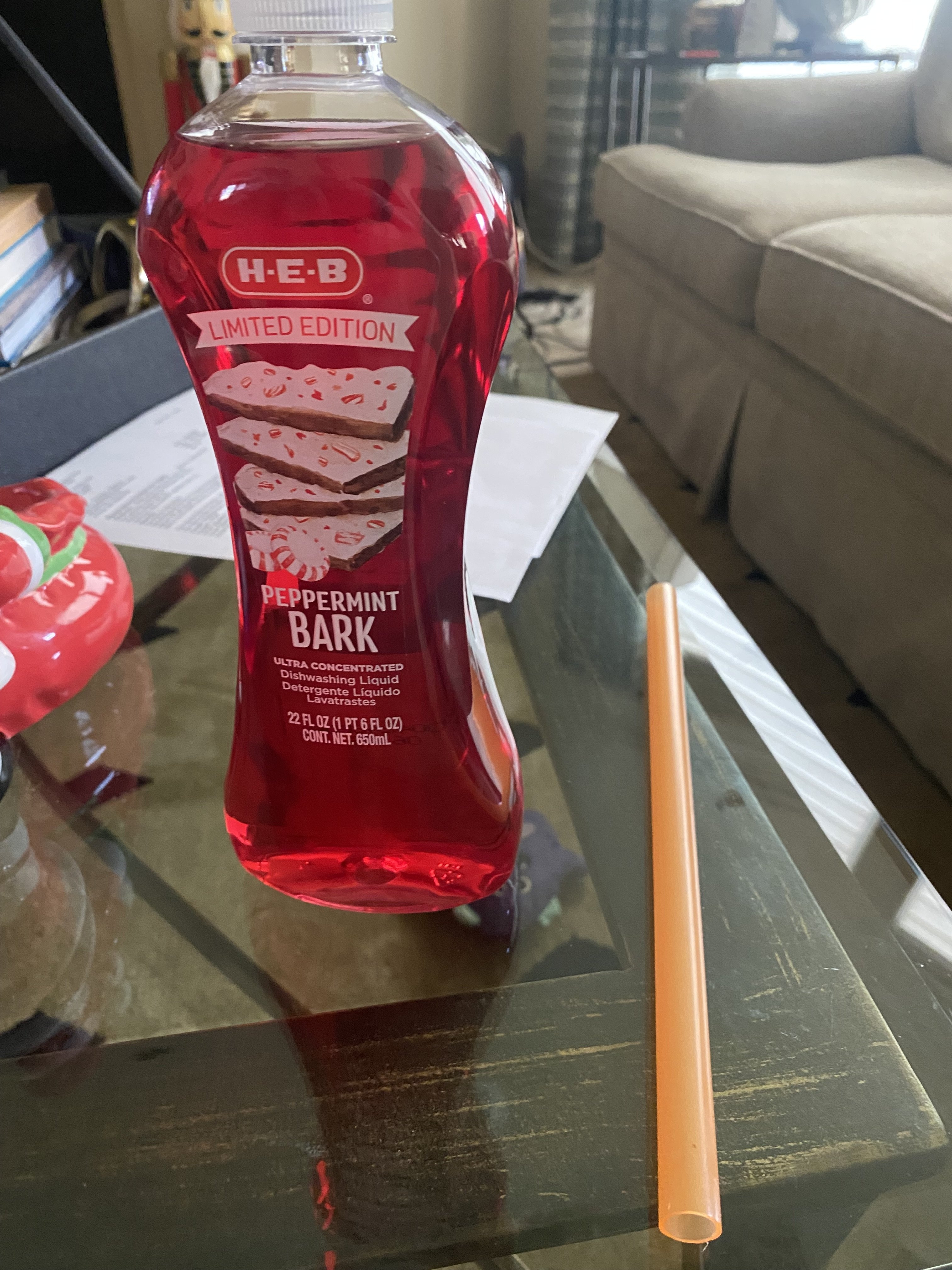

Question:
Does anyone see a drawback against squeezing a plastic container of liquid dish soap into the pipe where the snake auger is stuck to help lubricate the ID of the PVC? I've enclosed a pic of what i am referring. I know there is going to be suds galore, and didn't want to complicate things for flow of water and other.
If there is another option that you've used thst is better than soap, please let me know?
Thank you very much !
