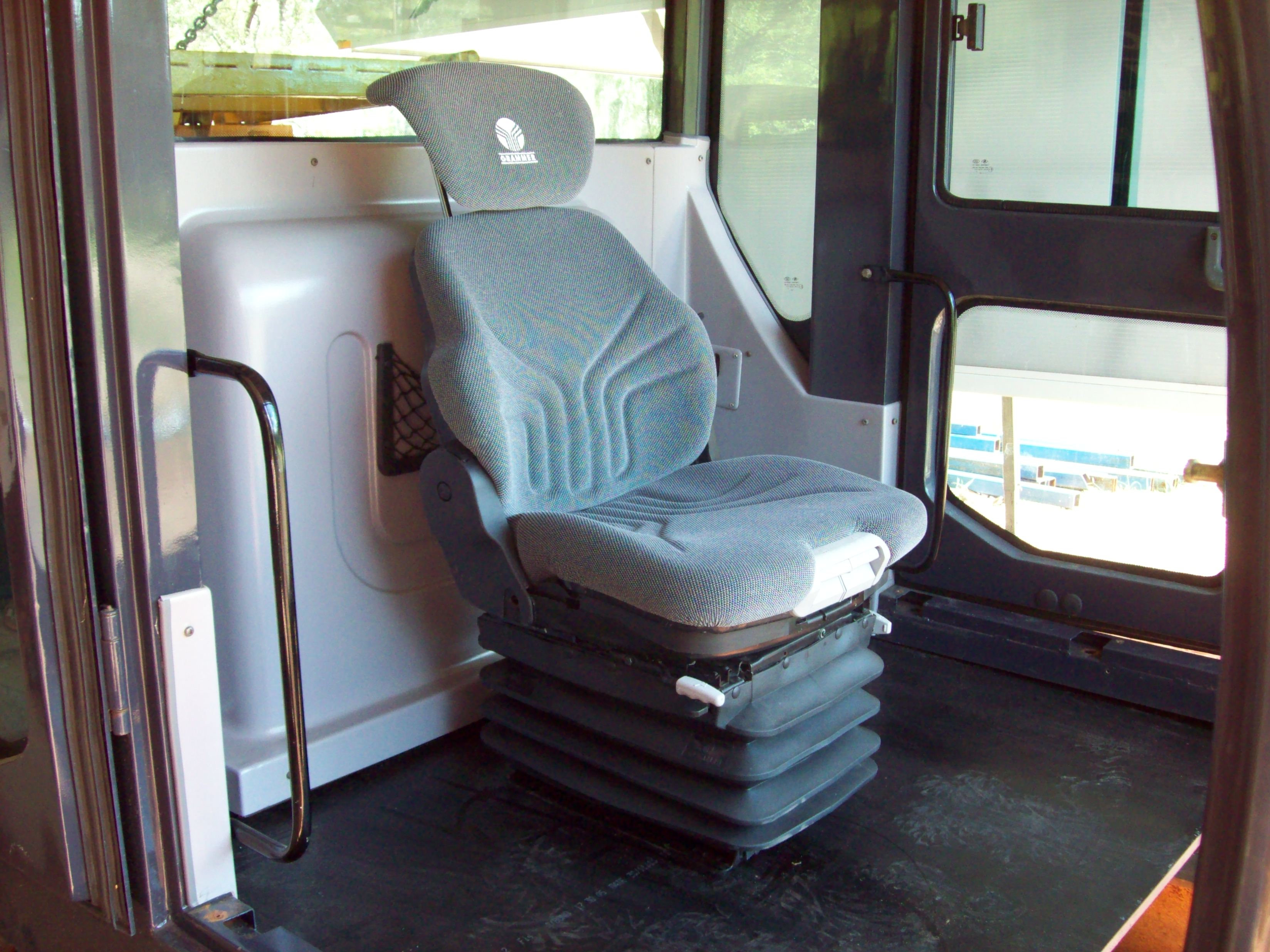

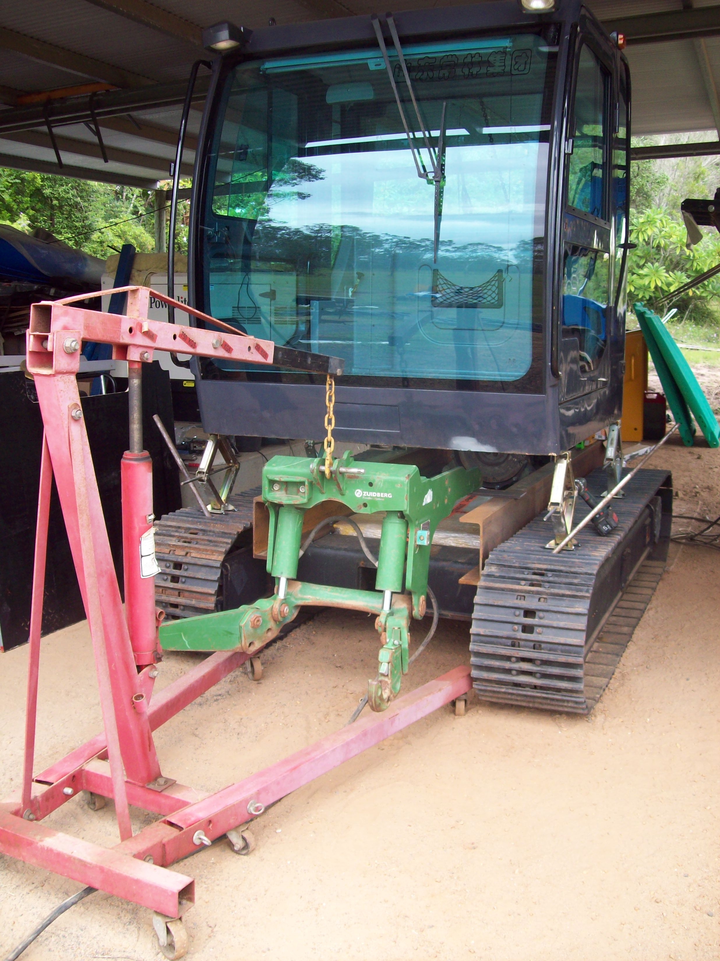

Started building the cabin floor and the fitting of the Grammer air ride seat .
Tony , I got your phone message yesterday when I went to town as we have no mobile service at home . I could not return your call as the phone does not log a number if it goes straight to message bank and you didn't leave a number .

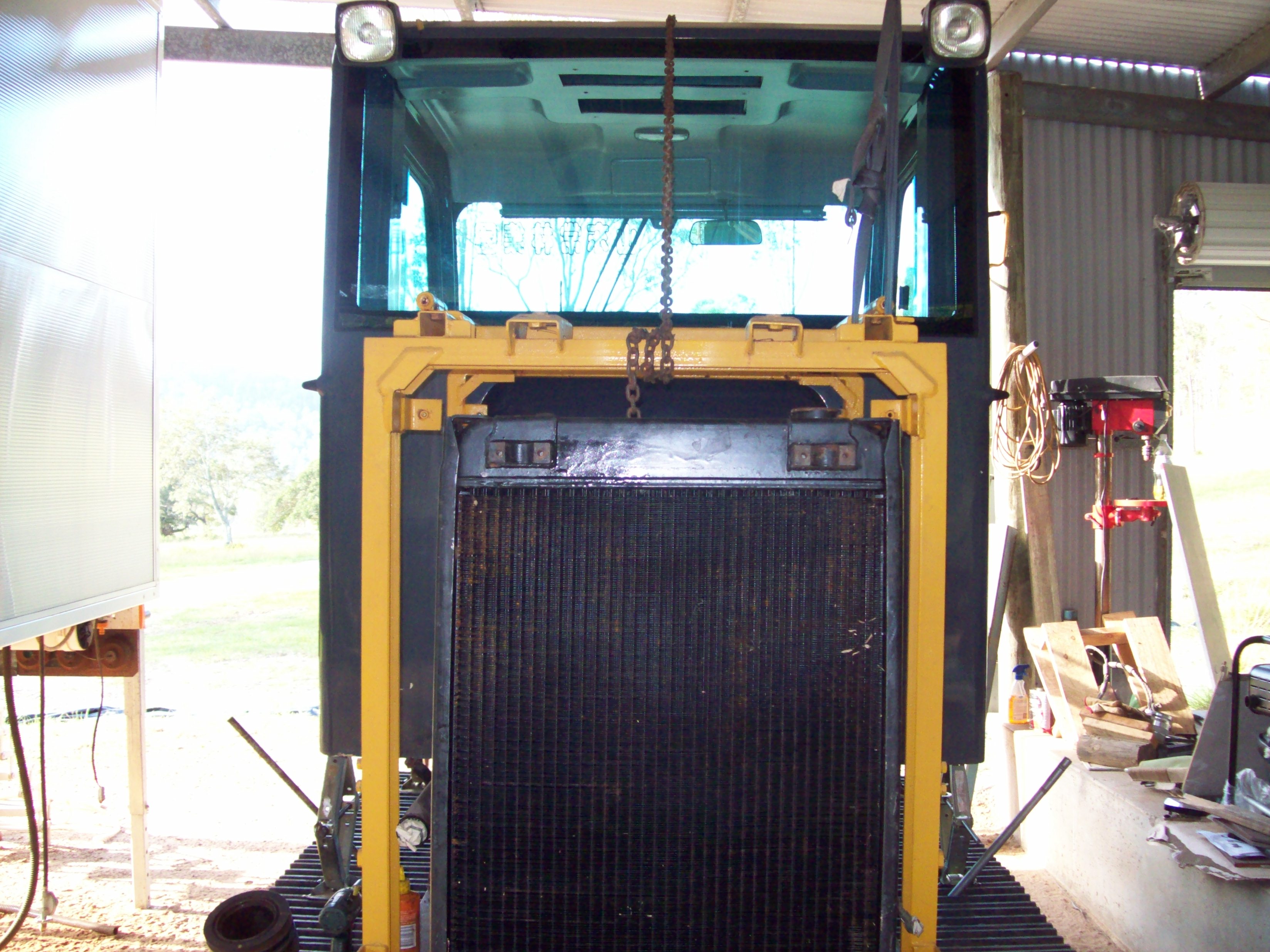

Thank you , the track width is 1800mm , the tracks are just under 3000mm . I think it will weigh around 7 tonne with the head .
All but about 1.5 tonne will be below 1200mm in height to it should be pretty stable .
Radiator is going in today , it is new , old stock out of a Cat loader and is very heavy which is what I want . I want as much weight as I can get hanging out back to counter the weight of the head .

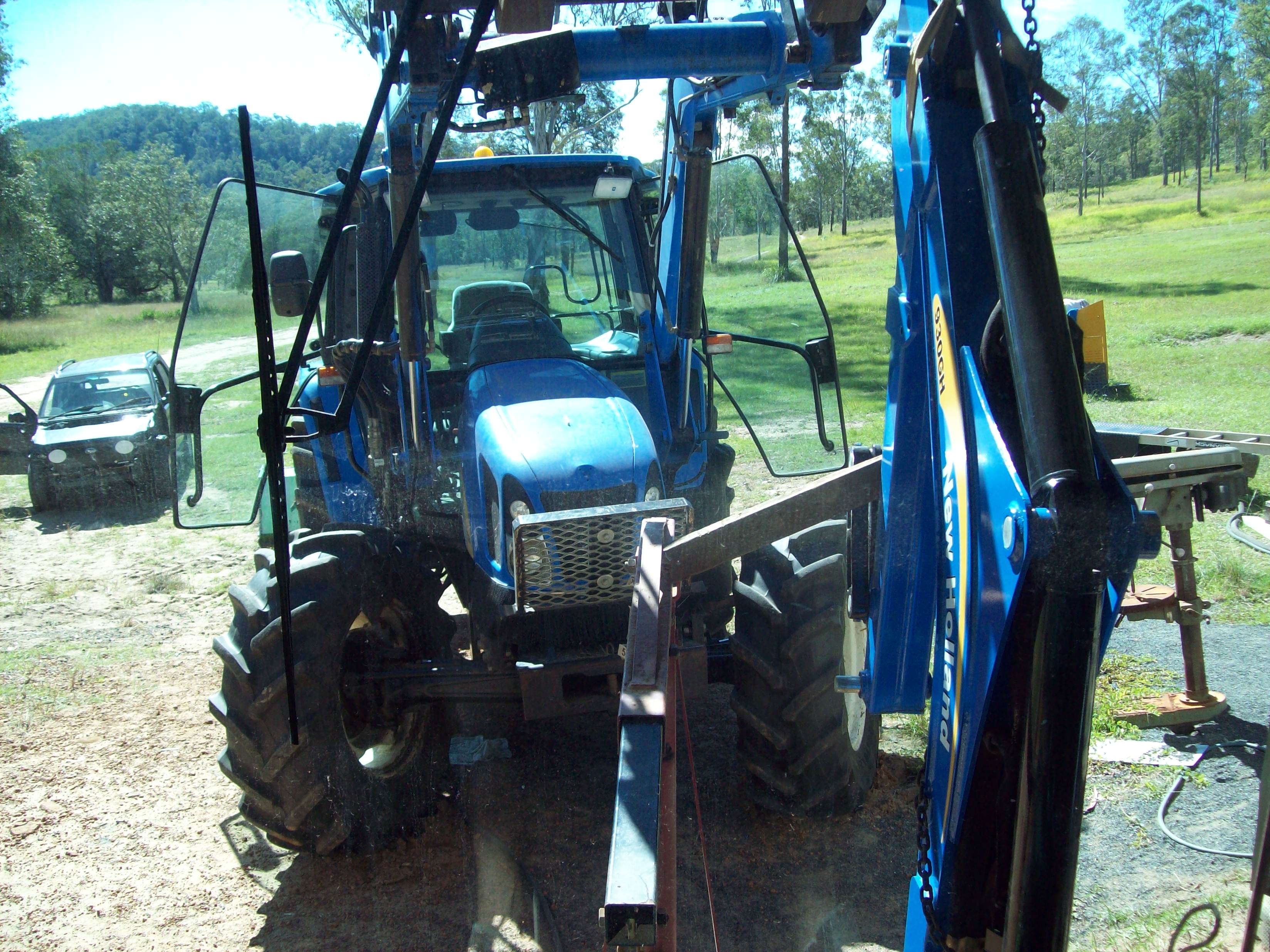

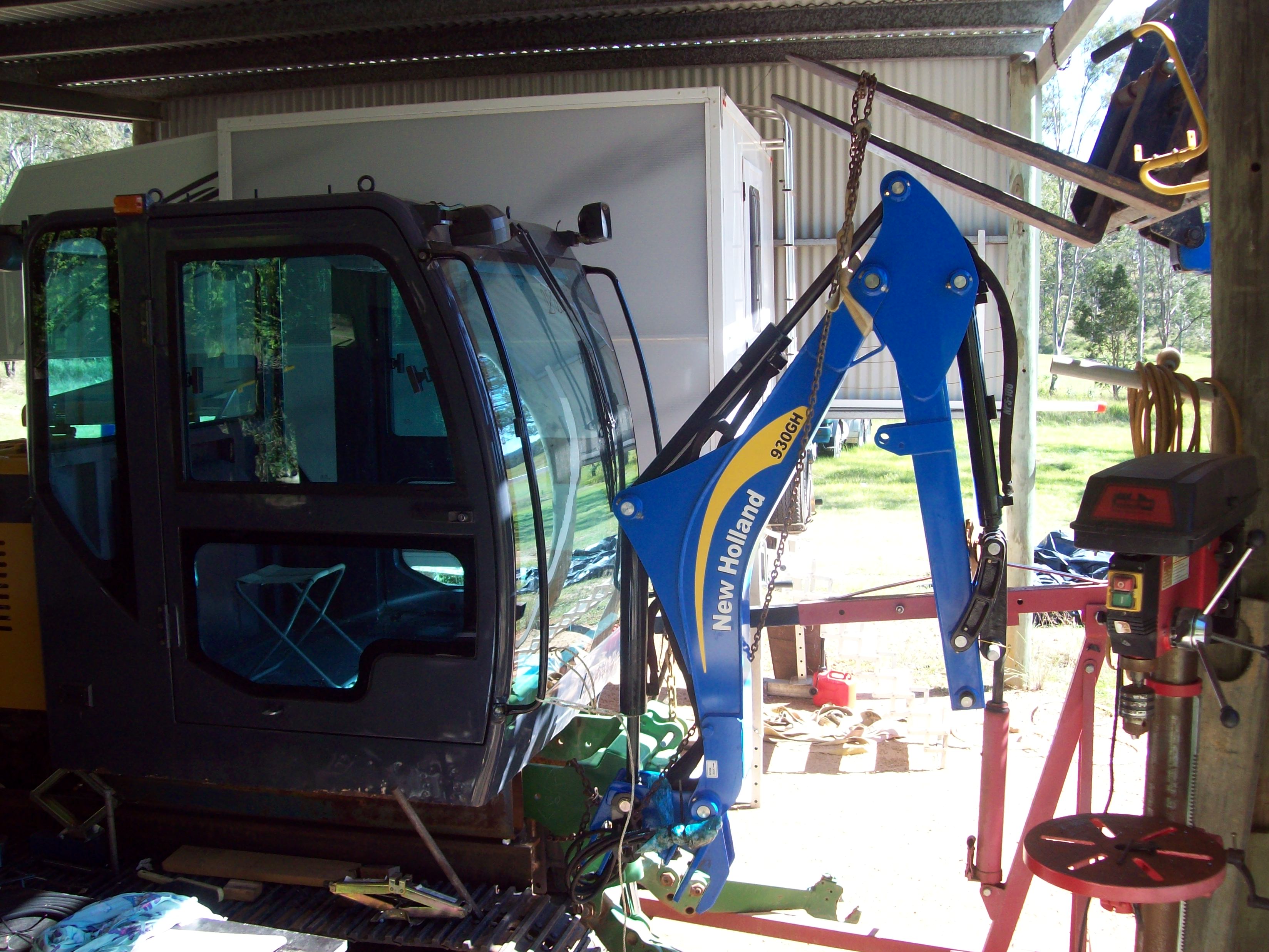

Today I bought a new backhoe off New Holland for a 55hp Boomer .
I couldn't get a small excavator at the right price so this will suffice . I will remove the stabilizer legs and use that function and the control valve sticks to drive the tracks . Servo/Pilot system hydraulics would have been good that the excavator would have provided , but this will do at a 20k saving .
May I ask. Why did you buy one new?? Around here you could get a good 3pt one that would be good to chop up and use for 3k. It would save alot more money. Or couldn't you find any?? Only reason why I don't buy one is cause a back hoe costs 6k and I don't have a tractor for one

To answer the last two posts . If I wanted to end up with a secondhand worn out piece of junk after I go to all this trouble , I would have used second hand worn out parts on it .
