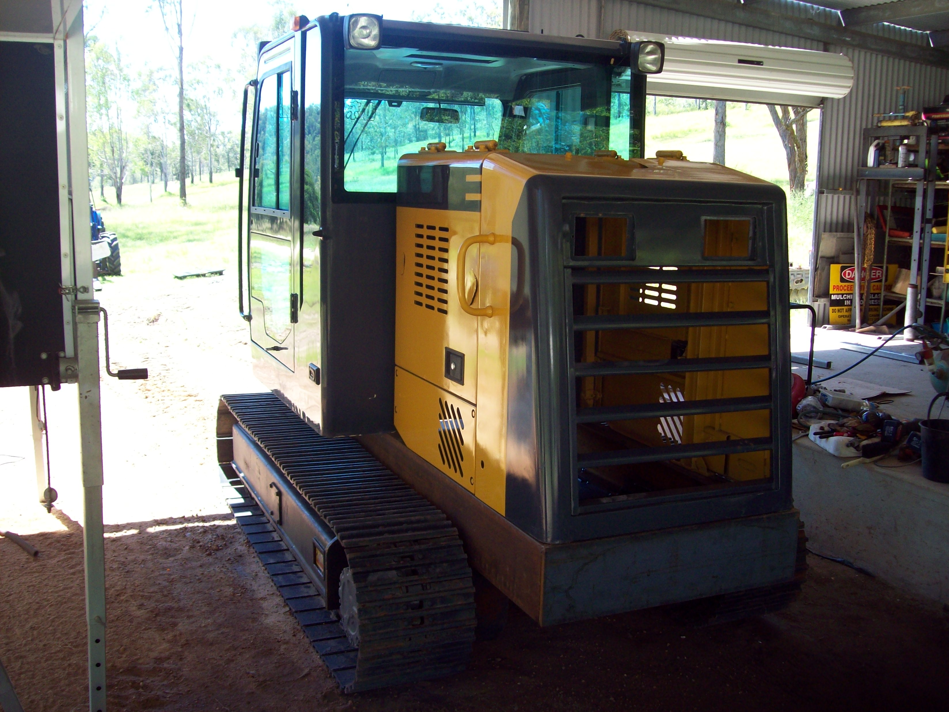

Over the years , I have accumulated a few bits and pieces that I have decided to glue together and end up with a tracked Mulcher .
The object of the plan is to use what I have at home and only buy in parts like hydraulic pumps , valve bodies , hoses etc .

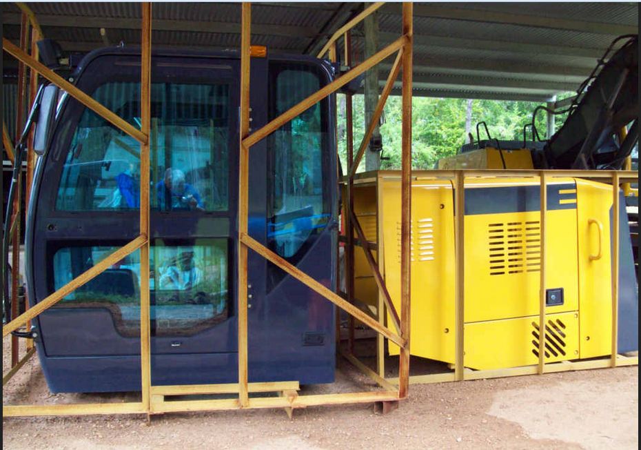

I have a new cabin off of an articulated road roller that I picked up for near nothing that was still in the factory crate . While I was picking it up from the business that sold it to me , I noticed a new articulated front end loader bonnet in a crate . I made them a silly offer and they helped me load it up . :thumbsup:

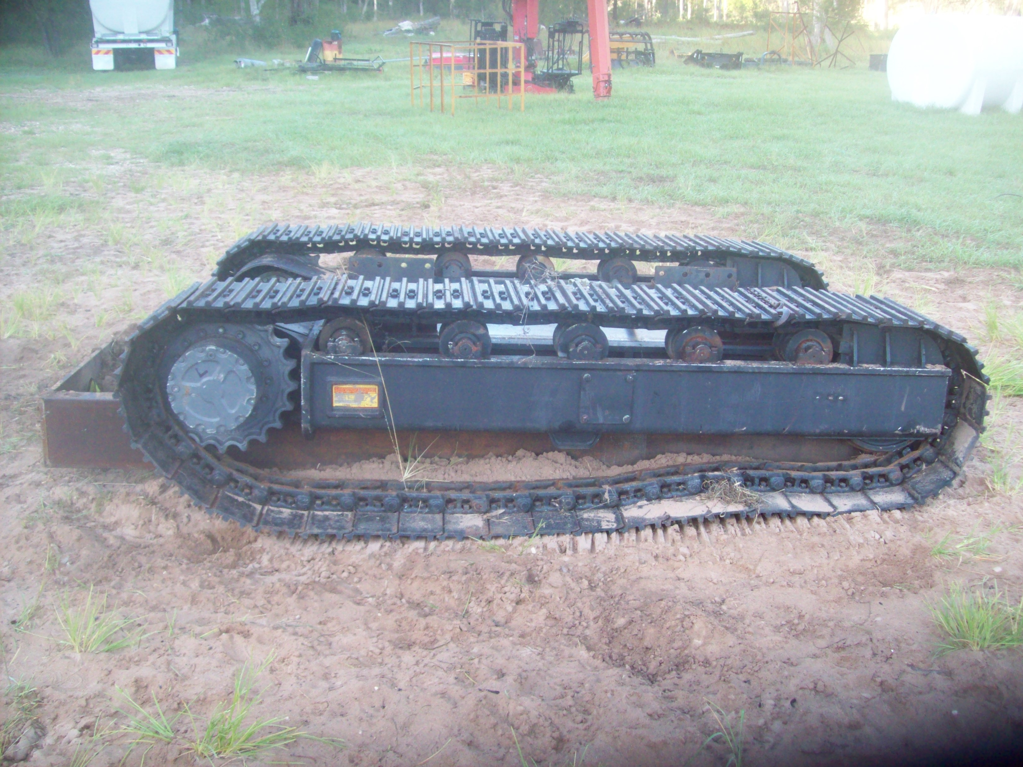

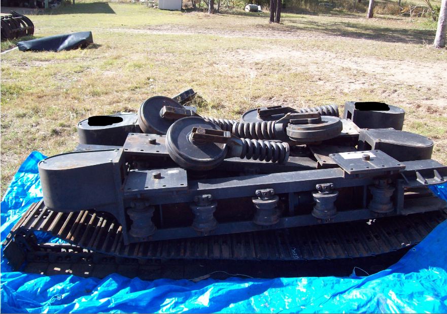

I ended up with 4 new track frames and tracks from a rock crusher/screen supplier that have been sitting around for years at home .
Then I bought a 4 cylinder Diesel 175hp Nissan UD truck engine with only 90,000k's on the clock for a job but never happened .
The other day , I am looking at all this stuff and thought, bugger it , i'll build a mulcher ! (as you do)
Hope you get a kick out of the build , but please dont think it will take a week to do it . You could be in for a wait but these few picks will wet your appetite .
Day 1 .
Looking, Looking . :eek:

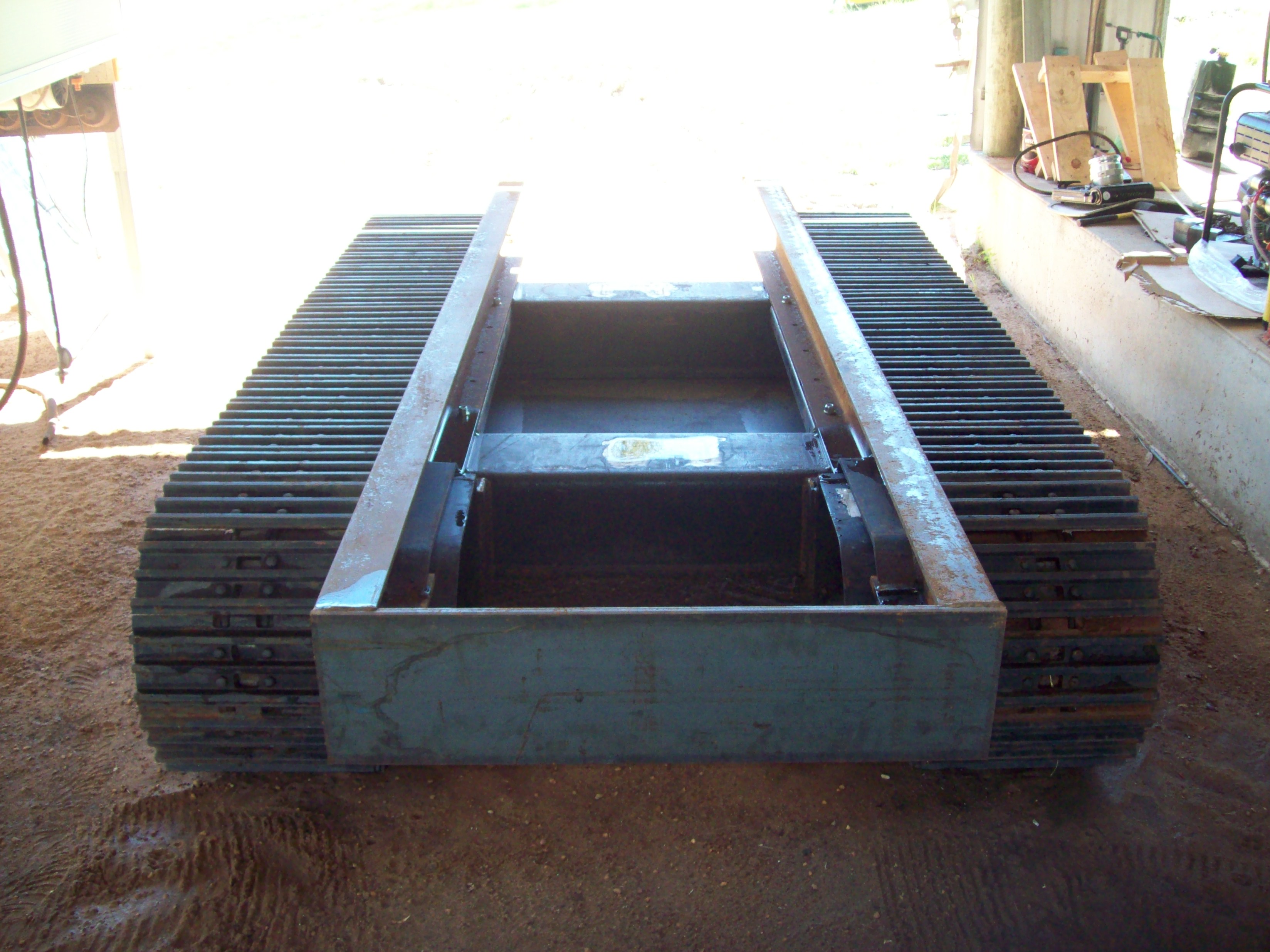

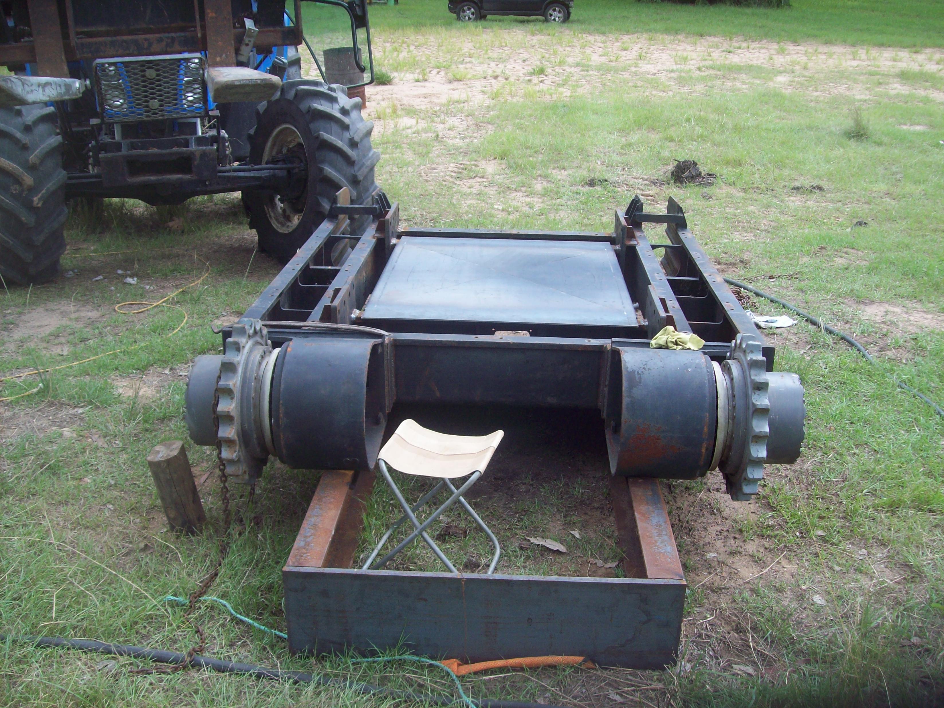

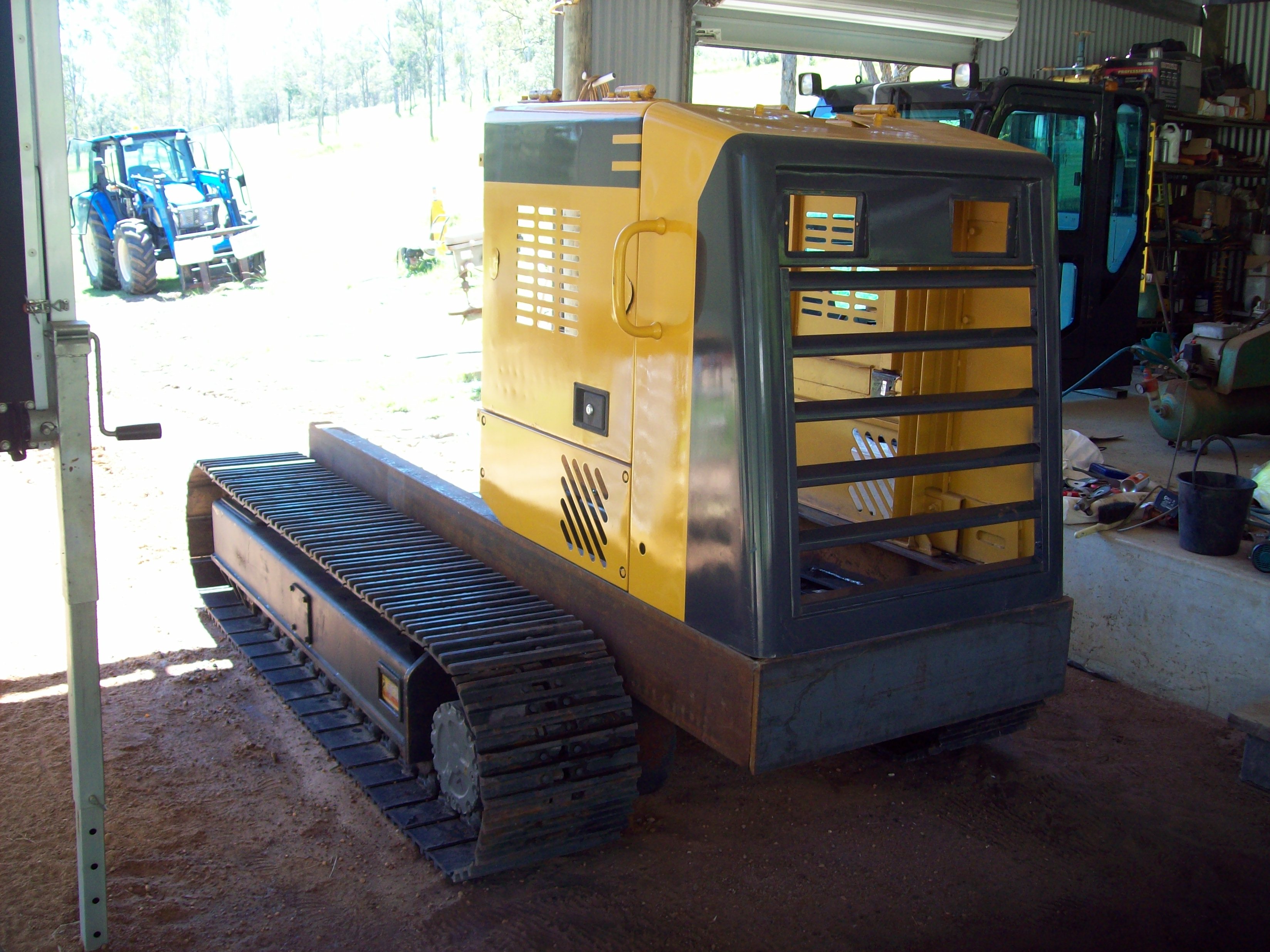

Cut the centers out of two of the track frames to use as cross members to join the remaining two . I didn't want to use box section as it is too torsionally stiff . These sections are "U" shaped with internal gussets etc and they can flex without cracking welds etc . Also built the Channel section intermediate chassis which will carry the cabin , bonnet , engine etc . Turned it all over in the dirt so I could fit the belly plate to the bottom .
Day 6
Fitted the rollers, idlers, track motors and tracks and turned it back over . It was then cleaned and scull dragged into the shed .
Day 7 (today 25/3/16)
Cabin and bonnet lifted on to the upper chassis . The cabin will be 8 inches higher when the cross members are welded in and the rubber mounts are in place .

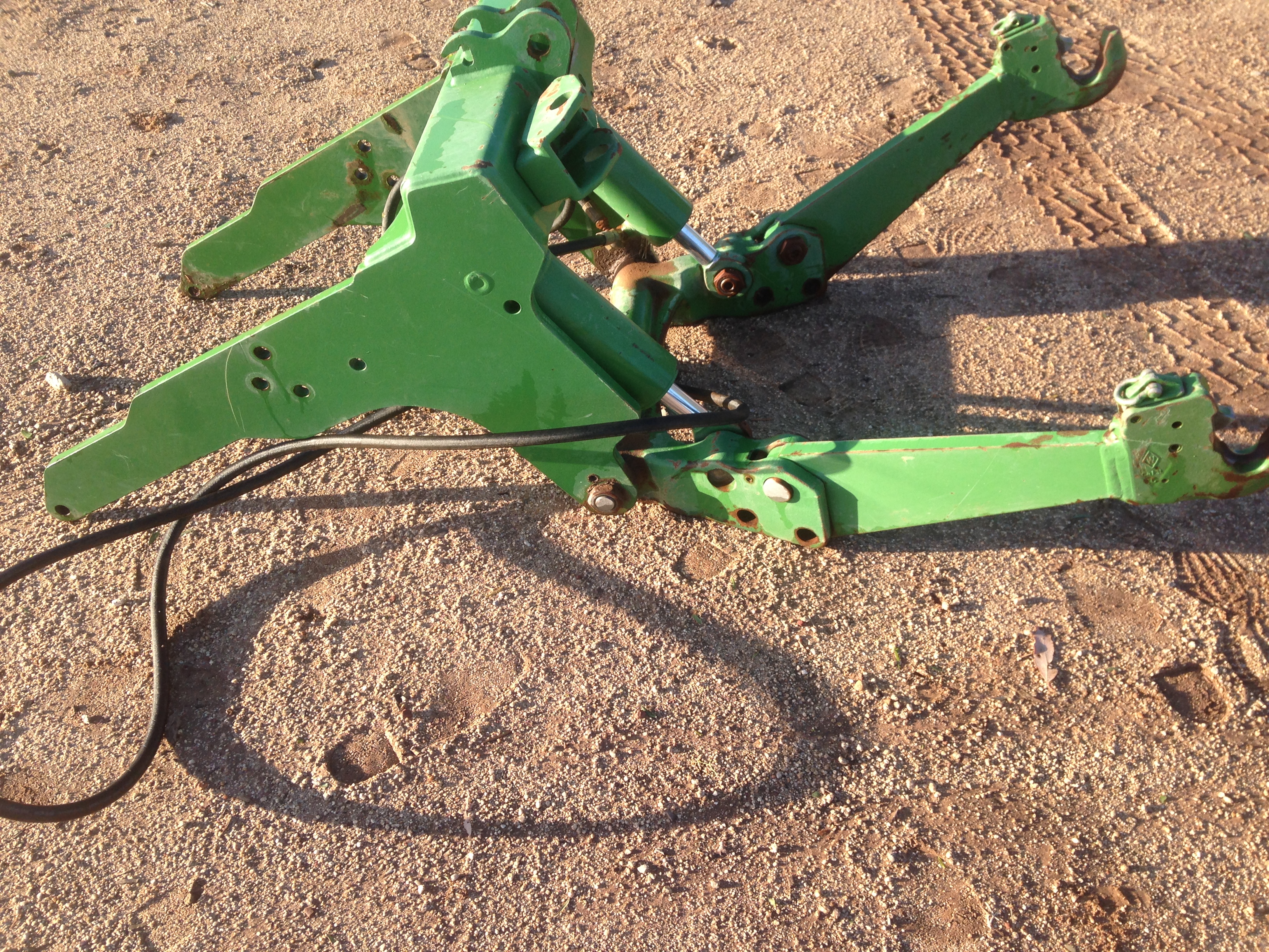

This is the 3 Point Linkage that will be going on the front of the machine . It will not only allow me to run a Tractor type mulcher , but also any other Tractor mounted implement I want , Stump Grinder , Wood Chipper , Asphalt Grinder etc .

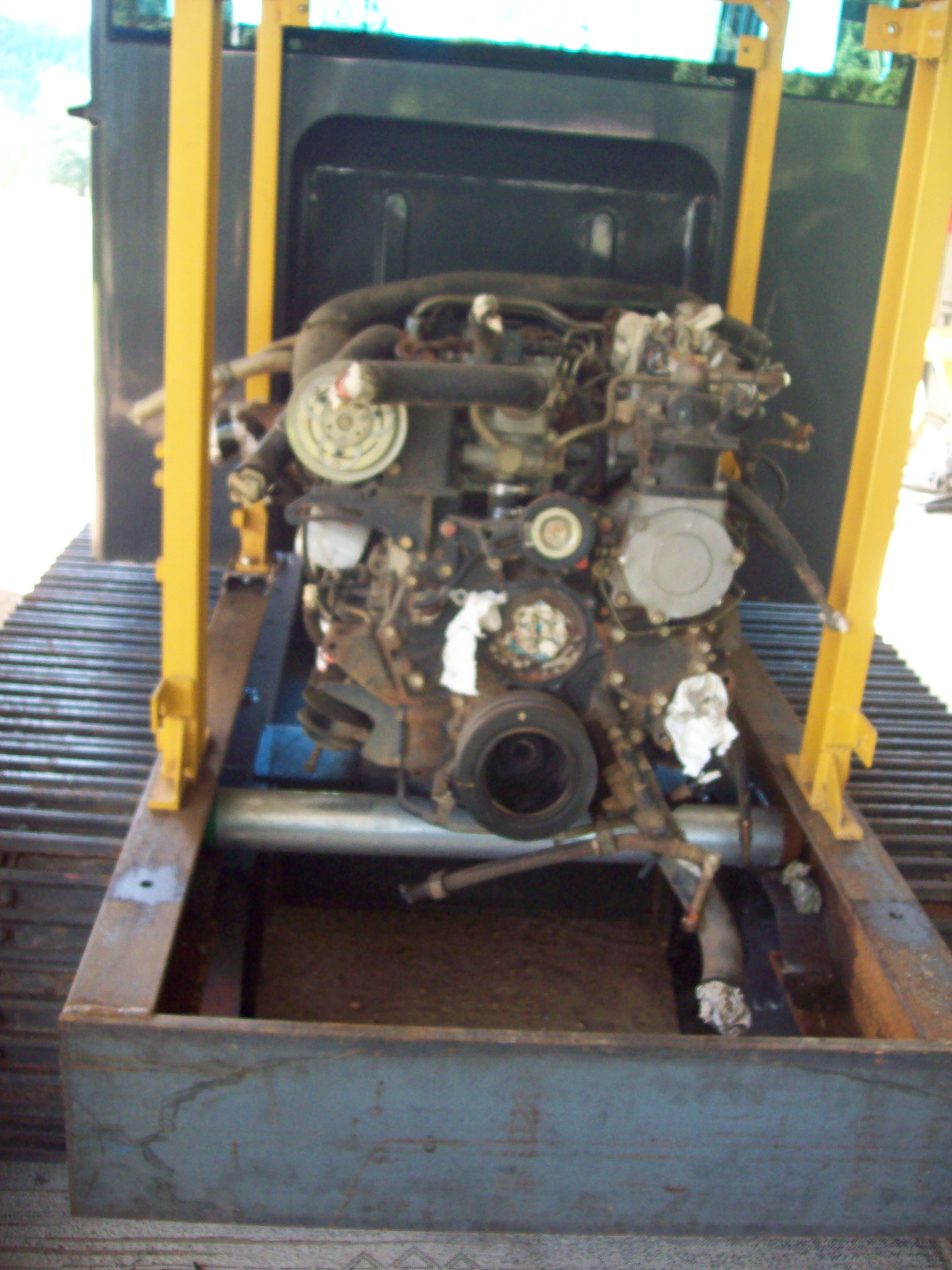

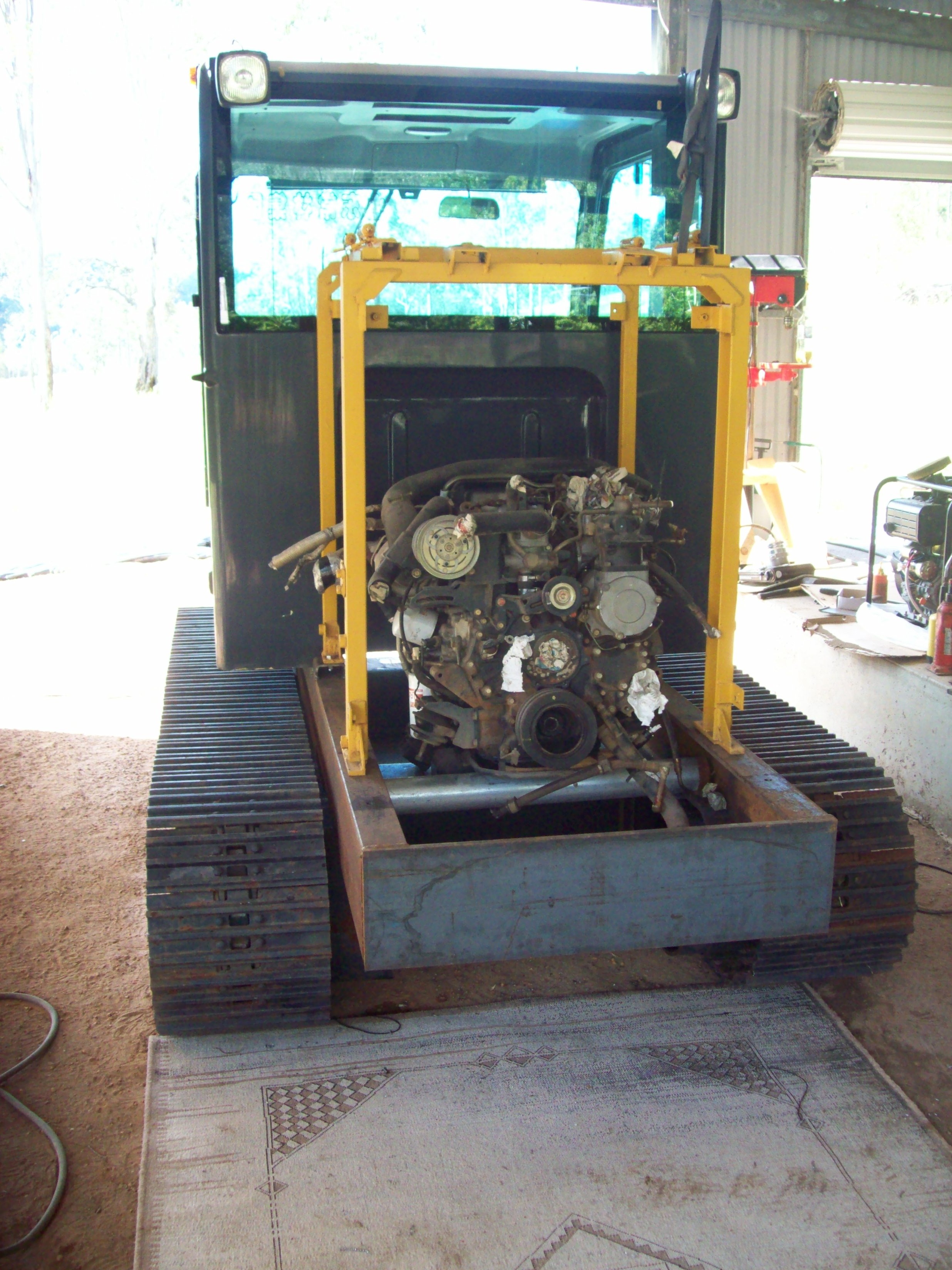

This is what I did on Easter Monday .
Removed the grille panel and side doors , but left the bonnet frame to give me an idea of what the confines were I had to work with and sat the engine into position . I just need to fab up some mounts for it now .
It sits nice and low , keeping the weight all down low on the machine . It will easily cross hillsides sideways without trying to tip over . I may need to weld grouser lugs on the track plates for traction though .
Having the engine low mounted also gives me plenty of room above it for an air cleaner etc .

Do you feel that the engine will do ok handling the shock of running a PTO Shaft directly off it? A PTO on a tractor has numerous connection points that can fail (as a buffer) before damaging the engine, and a mulcher can really "shock" the driveline.

It will still be protected in several places . The first line of defense are the belts on the mulcher itself , they can slip if the mulcher swallows an engine block in the grass . Second line of defense is the standard clutch on the series 8 PTO shaft . 3rd is the standard truck clutch , 4th is the inertia the flywheel and pressure plate has that protects the crank from twisting and 5th is the clutch pedal that I will be stomping on within a second in an emergency .
YES , if it was running the PTO shaft on the FRONT of the engine , as many tractors do and all that inertia was going through the crankshaft , then yes the crank is the weak link .
This is not a first , there are many PTO driven tracked mulchers on the market , as well as Wood Chippers etc that are driven straight off the flywheel .
