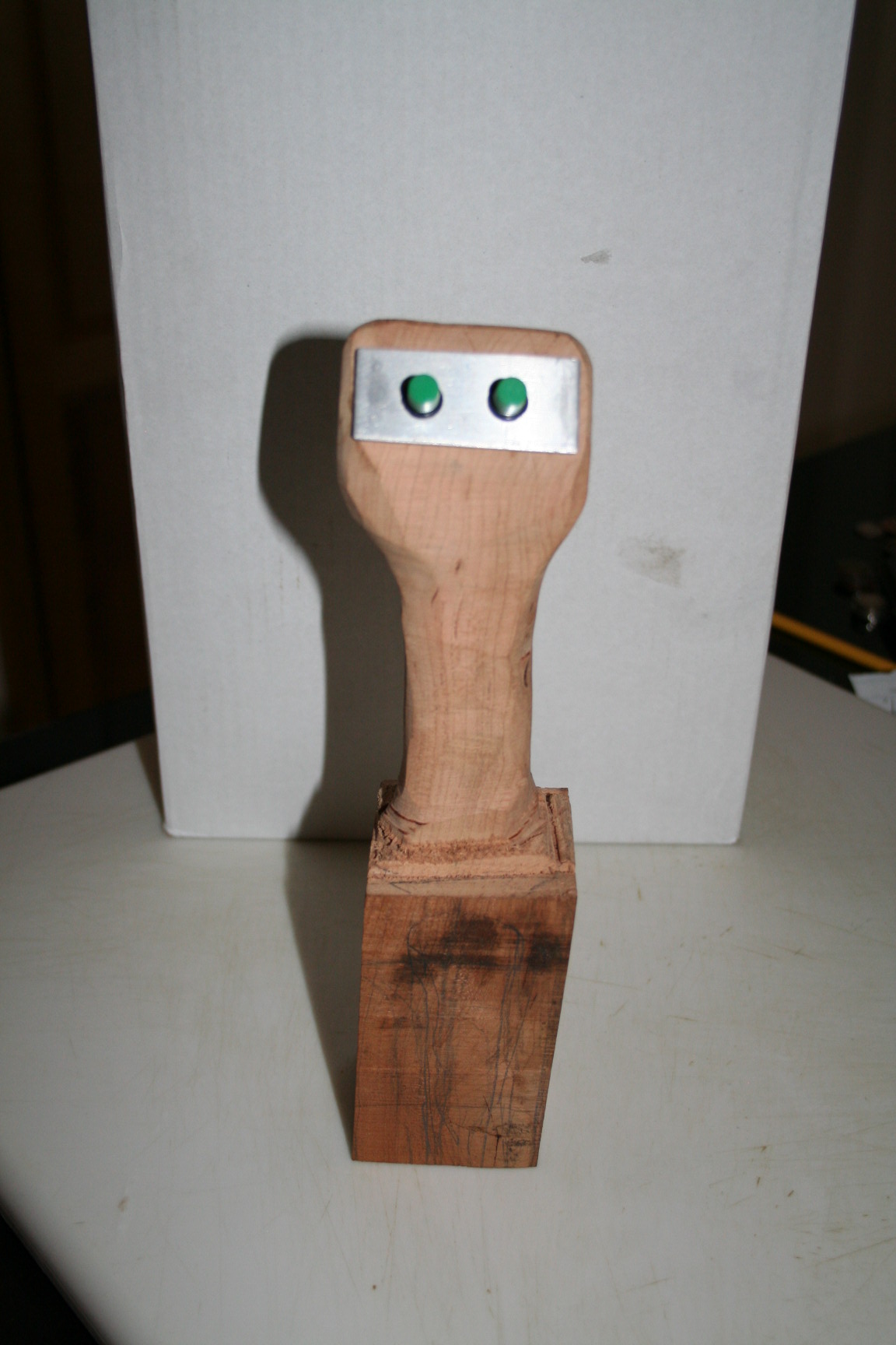

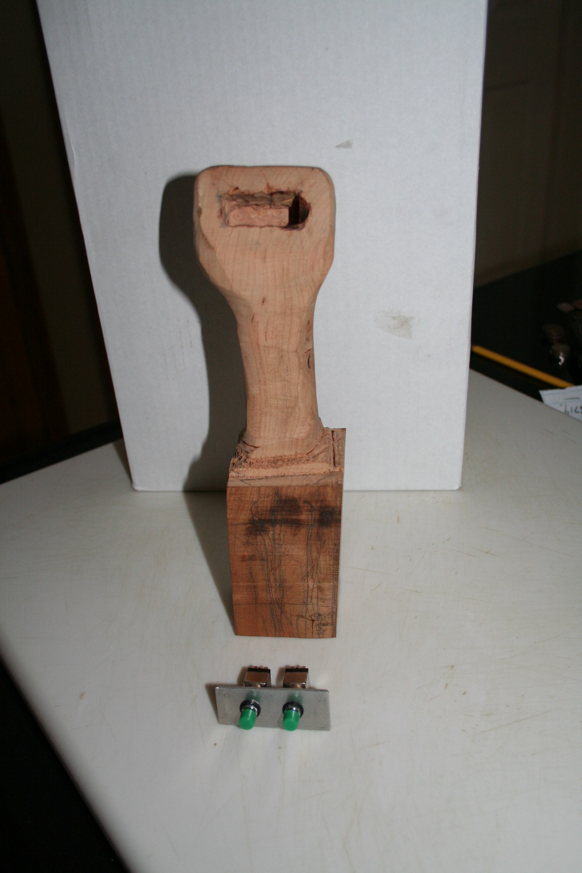

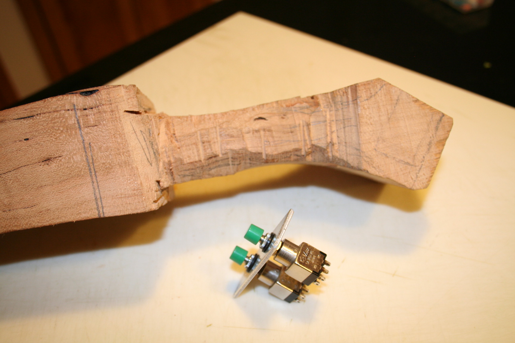

Here are pictures of the fittings, I had to stagger the QD out they were too close to work. Probably too big a loop on the tilt cylinder hoses , I can always shorten them, I have some trouble with the chute tilt hoses as they have to travel 270d. Thats why I put the sleeve on them. I will see how it works,
