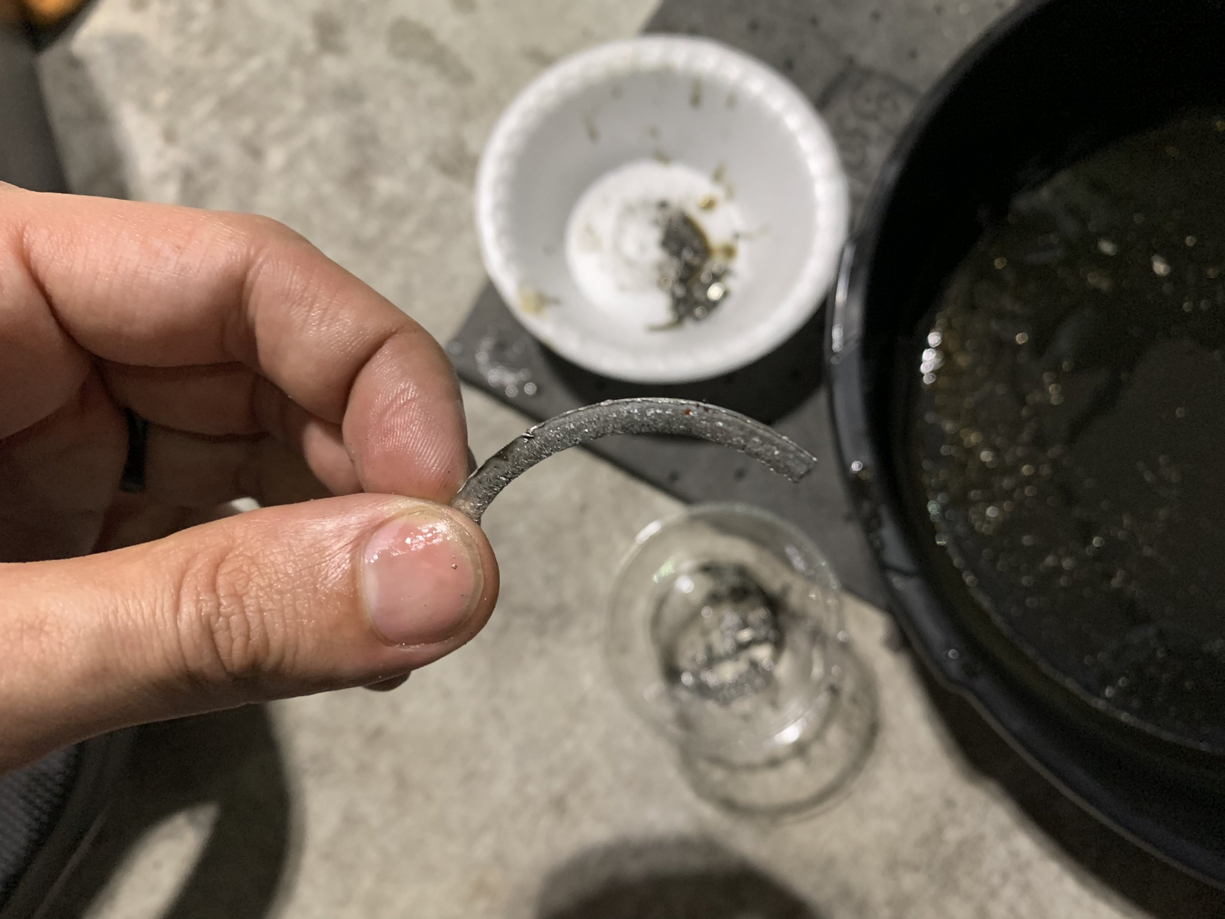

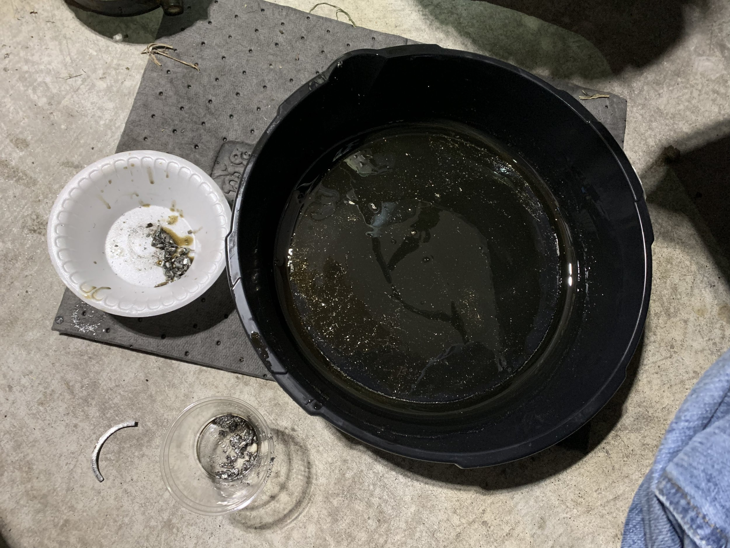

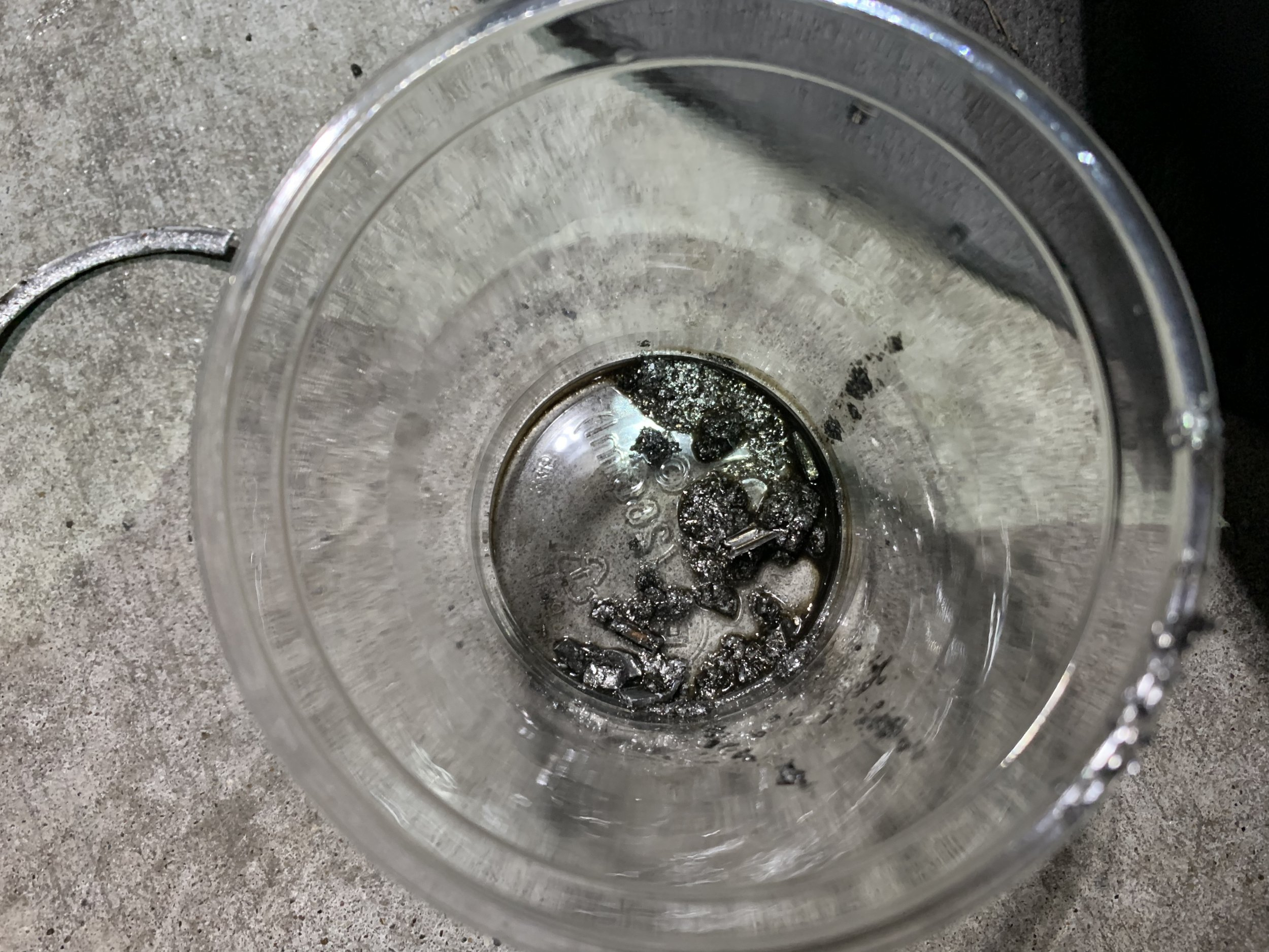

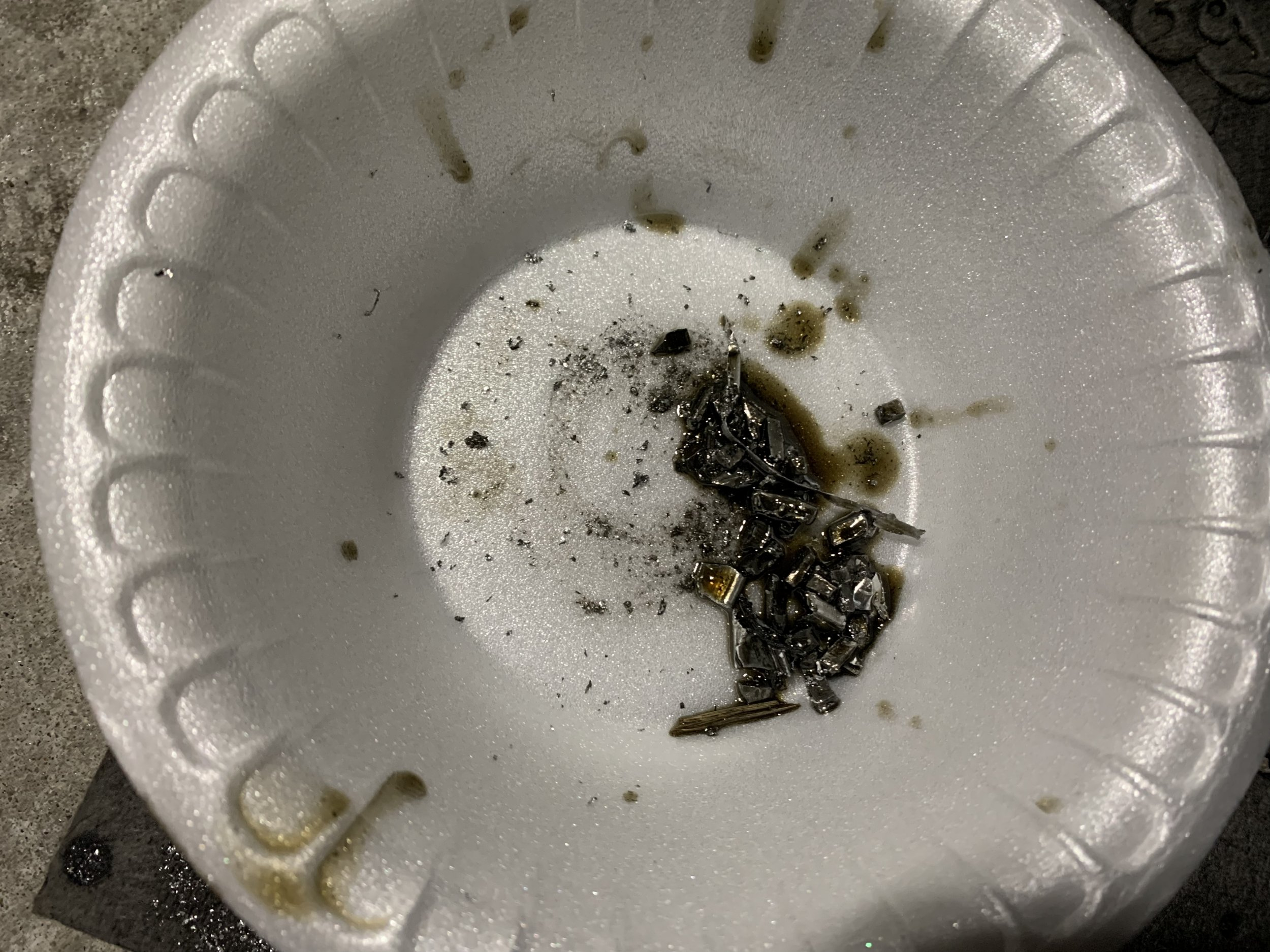

Depending on what destructed inside the cases, you don't even know if the engine is salvageable. To really know the extent of the damage, you'll have to pull the top end and split the cases.
Judging by his pictures imo it's more than a easier top end rebuild looks like there's needle bearing from the connecting rod in that sludge. Im preliminary assuming the cranks probably shot.

I would assume the entire thing is toast, maybe not even rebuildable.

Well I gave it another go. I couldn’t move it with just the ratchet and socket so stuck a breaker bar in there and gave it a few taps in both directions with a mallet and it broke loose. I can now spin it over.
Should I fill the cylinder with some PB blaster and let it sit for a couple of days before draining the oil and putting in new oil? Or is there something else I should do? Any other steps to take with it before trying to actually crank it over?
You have to be very careful when getting one loose. If the rings are stuck and you break a land when tapping, it's rebuild time. That's why everyone urges penetration oil of some type. Be very gentle and put a bind on it each way.
