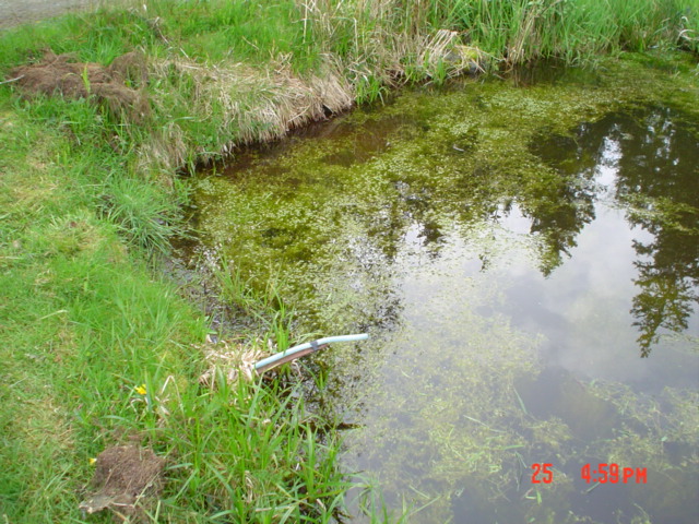

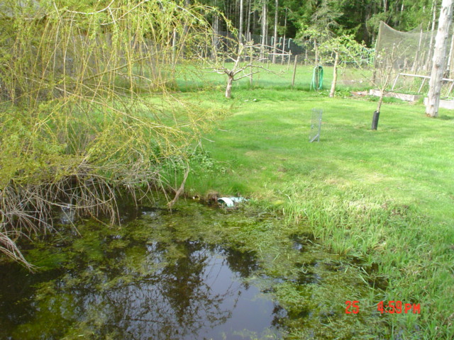

Depending on the size of the pond some people up our way get their ponds "puddled". These tend to be a bit larger pond. This is done by using special clay that is pretty much water tight. Usually it is done by an excavator type of guy who gets the clay and spreads it for you. Our small pond in the backyard is also fed by a seasonal creek and once it starts to dry up so does the pond. Ours is just native clay. We put some water lilies in that have real nice blossoms in the summer. I am just at the point of putting a pump in our year round creek that is close to the house and we pump water into our pond all summer long. Usually we turn the water on for an hour or two in the morning and again in the late evening till the pond reaches the over flow pipe.
Pic 2 is the water line in and pic 3 is the over flow pipe.
