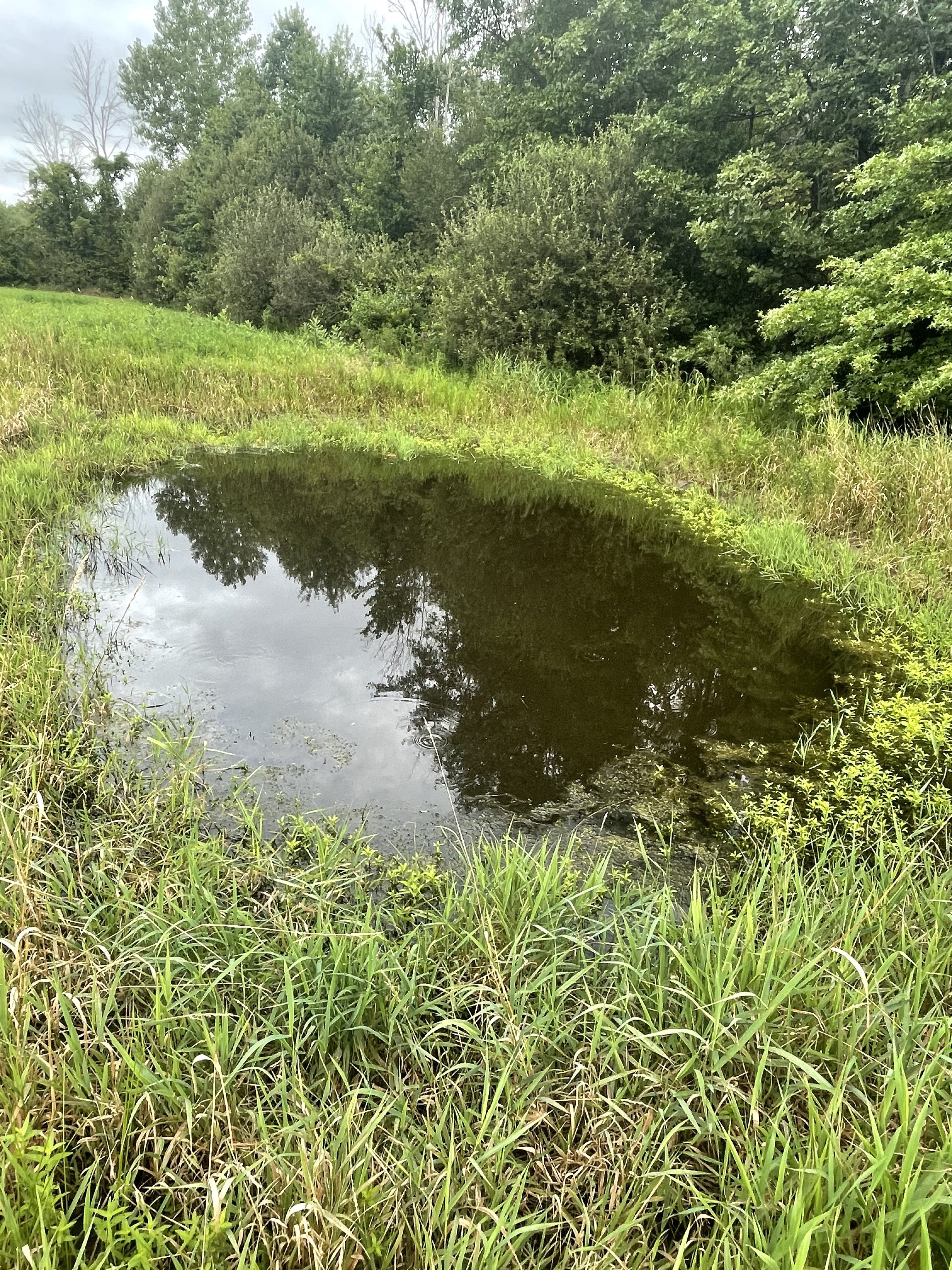

I put one in on the other side of the country (upstate NY) about 30 years ago with my 1951 Ford 8n and 3 point pond scoop. I paid $1200 for the tractor (from the widow of the original owner), and $175 for the scoop. The pond was 32’ x 22’ x 6 ft deep. It took me about 50 hours to dig with that, and that old tractor needed a valve job when I finished (cost me $375).
I didn’t get any permits. You can’t see it from the road. I was a little worried about its proximity to a natural gas line right of way, that crosses our farm, but I didn’t have any issues with that.
We had a severe drought about 10 summers ago and it dried up completely. By that time, I had a newer 4wd diesel tractor (John Deere 4120). I drove that down into it and scooped out 20 years of sediment, and dug it down 2 ft deeper into the clay, with the 400X front loader on the John Deere.
Now it’s 8 ft deep and it has not dried up since I cleaned out and deepened it. It holds a decent population of bluegills (ducks must have brought them in). I added 4 largemouth bass a week ago but one of them didn’t survive.
I dug the pond on a very dry summer, at the lowest point in our farm. That spot always seemed to be wet and I hit solid clay about 5 ft down. I used that clay to line the banks.

That's a nice pond. And thanks for pointing out that there is more than one way to make a pond. Around here we dig a hole and then bring in truckloads of bentonite to seal our sandy soil. There is no native clay. Making a pond becomes a whole lot easier if the site already has compacted clay that just needs scooping out.
