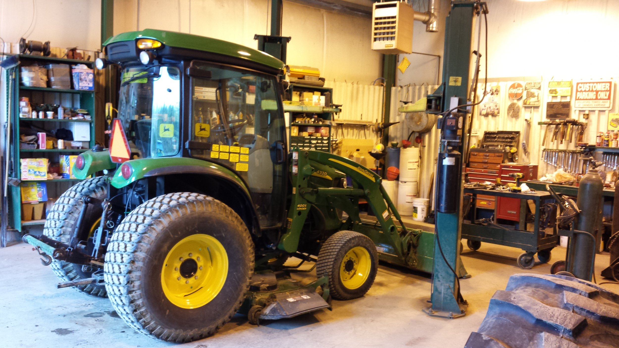

I have a John Deere 4320 cab tractor/ with 48 HP and the mid mount mower/ 72". Now 17 years old and 2500 hrs. It was the only way for me to go. Cruise, air, tilt, eh! The 4X20 series tractors had up to 58 HP at the time. Per the dealer they didn't sell very well, that is with the mower deck, so they discontinued that option after only a couple of years.
