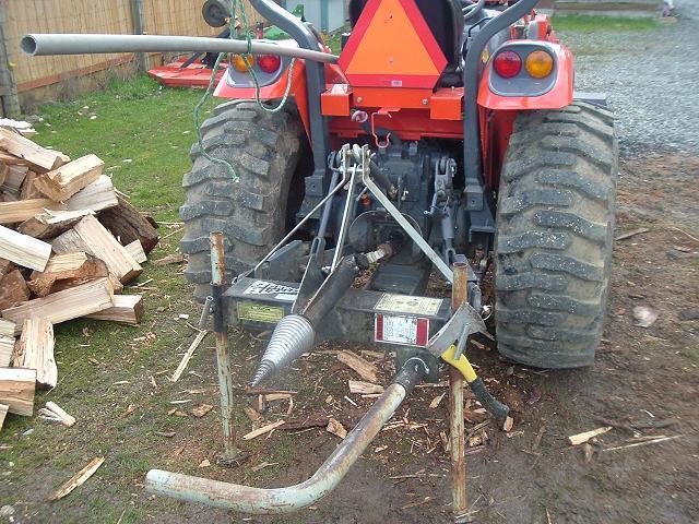

I don't know how many of you have actually owned and used a Bark Buster, but I've had one for many years and split hundreds of cords of firewood without incident. First off, you don't have the pto spinning full steam. You can leave the tractor just above an idle, so the screw turns pretty slow, not whirling as some think. Secondly, I can put my gloved or bare hand against the tip while it runs, and it doesn't catch, the tip is designed that way, plus there's a guard that prevents you from walking into it. Thirdly, it's designed to split 16" or longer wood, not long logs. Fourth, the wood CAN'T catch and start spinning if used the properly.There's a pipe that you rest the one end of the log on before you press the other end against the screw, and it prevents the log from spinning.
I can split wood TWICE as fast as my brother with a hydraulic splitter, without even trying. I just think too many people look at them and run scared.

I used one for many years until the pipe to catch the wood broke and the spinning wood almost broke both my arms. Use it with care!

I would have to say, that it is as safe as the operator. Just about like anything, it has an acceptable risk. What generally happens is that someone will get a new device, and without really knowing how it is supposed to work, they go for it. The lack of knowledge of the devise makes it unsafe for that person. I have seen them mounted on the hub of a truck, tractor, and if used correctly, they work. Probably if you ask 10 men to operate that splitter, 5 would do just fine, 3 might think it unsafe and not use it, and 2 people would use it and get seriously hurt. Again, knowledge or lack of it will make the difference.

Yes sir I have one and I too have split many many cords with it and haven't been hurt. I have a healthy fear of the device and use it while sober and alert. I find it extremely fast at splitting wood and very effective though the wood doesn't split up as pretty, more strings. I would love to have a hyrdo splitter just so that I can split and throw into the tractor bucket and honestly, to make it a safer deal.
Yes they work, they are more dangerous than hydro splitters, but they work very well and they are not so dangerous that you shouldn't use them. Just dangerous enough that you need to be more cautious than with other tools.
