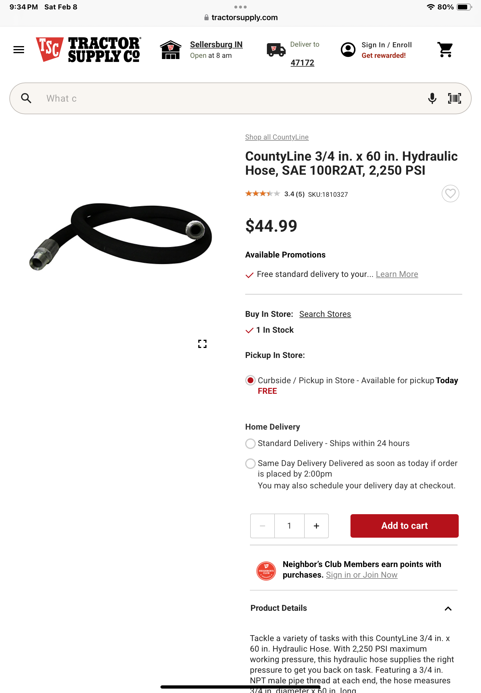

I build a log spliter the way I wanted and I have 1 qustion. On the return line now it's a 1/2" I was thinking that's to restricted so I called for a price today on a 3/4" hyd. hose that was to hight so that got me
thinking black pipe3/4" would be much cheaper will I have any problems withit ?

Well I changed the line from 1/2" to 3/4" I bought a clear line and put it on and started the spliter and it spit fluid all over! .
I use hose clamps on each end I checked before starting the spliter I think I have to buy pex crimp rings and a better line.

I bought a 3/4" hyd. Hose all good now except oil filter I might have to change that because the gasket around it did not stop the fluid and it went on the floor.
Now you know why it's just worth buying a hydraulic hose for a return line. 2gal of fluid prob cost the difference between low pressure hose and a hydraulic hose.

Low pressure return needs to be fitted hydraulic hose.
Had to read the op again.
/ Log spliter qustion
#20
There is pressure on the return line! It blew a hole in the clear line I had that why I bought a hdy. line it has 31 or 3200psi.
