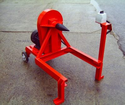

I know that you guys are having a bit of fun with these splitters. They certainly do not look safe, but they probably are safer than they look, with prudent caution. They are quite popular here and many are for sale on our equivalent to Ebay. I will give you a few examples for your amusement. Some are no more than a big 3 phase motor with the screw #1, but I chose especially the tractor attachment models, since this is a tractor forum. #5 is my personal favorite--you could split the tree before you cut it down. :D
By the way I do not have any of these and really do not plan on getting any.

NO piece of equipment I use on my orchard and in my forest scares me any near as much as just looking at those screw splitters............

Thanks Mike.
Wish they were more available here. I like the first one, and the one on the shaft and two pillow block bearings. Will continue looking for the screw head with some idea to make a bench model for splitting split wood into kindling when needed.

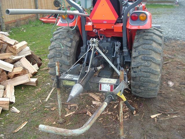

I don't know how many of you have actually owned and used a Bark Buster, but I've had one for many years and split hundreds of cords of firewood without incident. First off, you don't have the pto spinning full steam. You can leave the tractor just above an idle, so the screw turns pretty slow, not whirling as some think. Secondly, I can put my gloved or bare hand against the tip while it runs, and it doesn't catch, the tip is designed that way, plus there's a guard that prevents you from walking into it. Thirdly, it's designed to split 16" or longer wood, not long logs. Fourth, the wood CAN'T catch and start spinning if used the properly.There's a pipe that you rest the one end of the log on before you press the other end against the screw, and it prevents the log from spinning.
I can split wood TWICE as fast as my brother with a hydraulic splitter, without even trying. I just think too many people look at them and run scared.

Yes sir I have one and I too have split many many cords with it and haven't been hurt. I have a healthy fear of the device and use it while sober and alert. I find it extremely fast at splitting wood and very effective though the wood doesn't split up as pretty, more strings. I would love to have a hyrdo splitter just so that I can split and throw into the tractor bucket and honestly, to make it a safer deal.
Yes they work, they are more dangerous than hydro splitters, but they work very well and they are not so dangerous that you shouldn't use them. Just dangerous enough that you need to be more cautious than with other tools.

There ya go. Well put!
