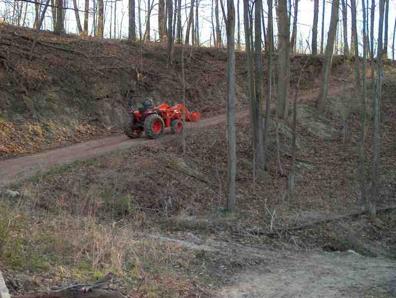

I went out to plow this hill that is part of our driveway this morning at 6am in the dark. It had been covered with ice the night before and we got about 7 inches of snow on top of that. The tractor has chains on the rears and the tires are loaded. I've never had any problem with traction before but this AM was much different.
I took one swipe with the 6ft rear blade on the way down the hill and up the other side of the ravine. On the way back up I completely lost traction even after I raised the rear blade and locked the differential. With 3 wheels spinning it wouldn't go anywhere! I ended up backing down the hill and took another run at it with the blade up and managed to get to the top. I turned around and made a run down the hill with the blade down. About halfway down the hill the tractor started sliding and ended up completely sideways and sliding down the hill! All I could think of was, how am I going to get this tractor off the hill after it's laying on it's side. Well, luckily it didn't tip over but I can tell you it was a wild ride and not one I want to repeat soon.
I got a 50 lb. bag of calcium chloride out and melted some of the ice after that. I hadn't had a ride like that since I used to plow the hill with the old 47 farmall cub.

I'm only running 2-link ladder chains right now. I have a set for the front but I've never put them on and don't know if they would have helped or not in that situation. That's the first time we've had that much ice in the last 10 years and I think I'll put some money into more calcium chloride to melt it rather than new chains. Even with different chains I would still need to get the ice melted for the other vehicles.

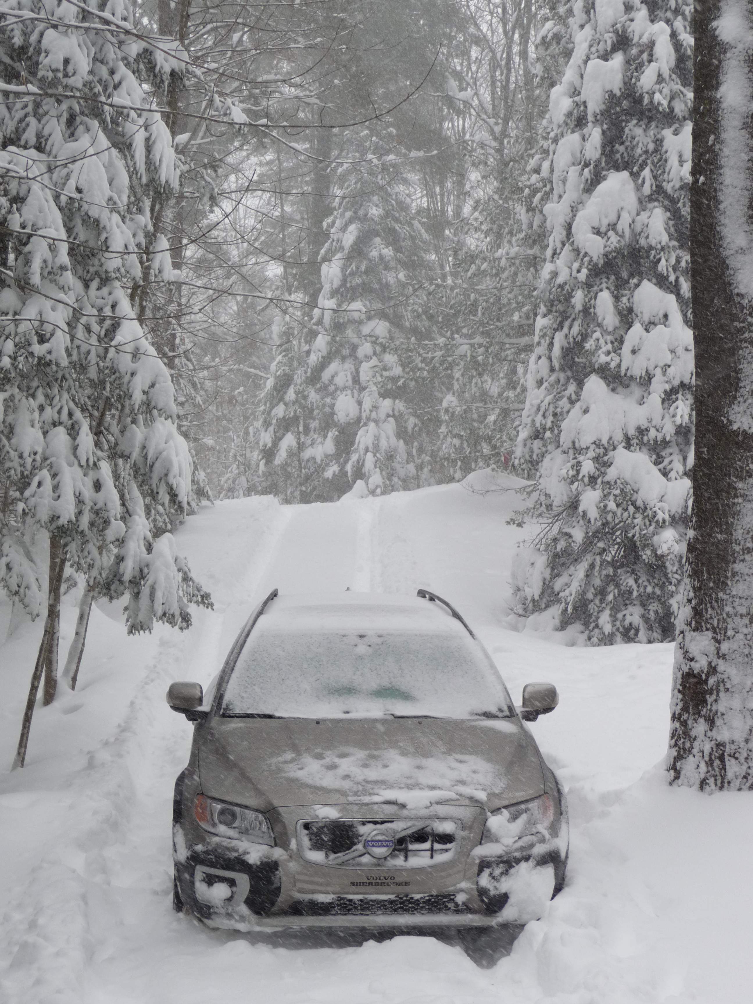

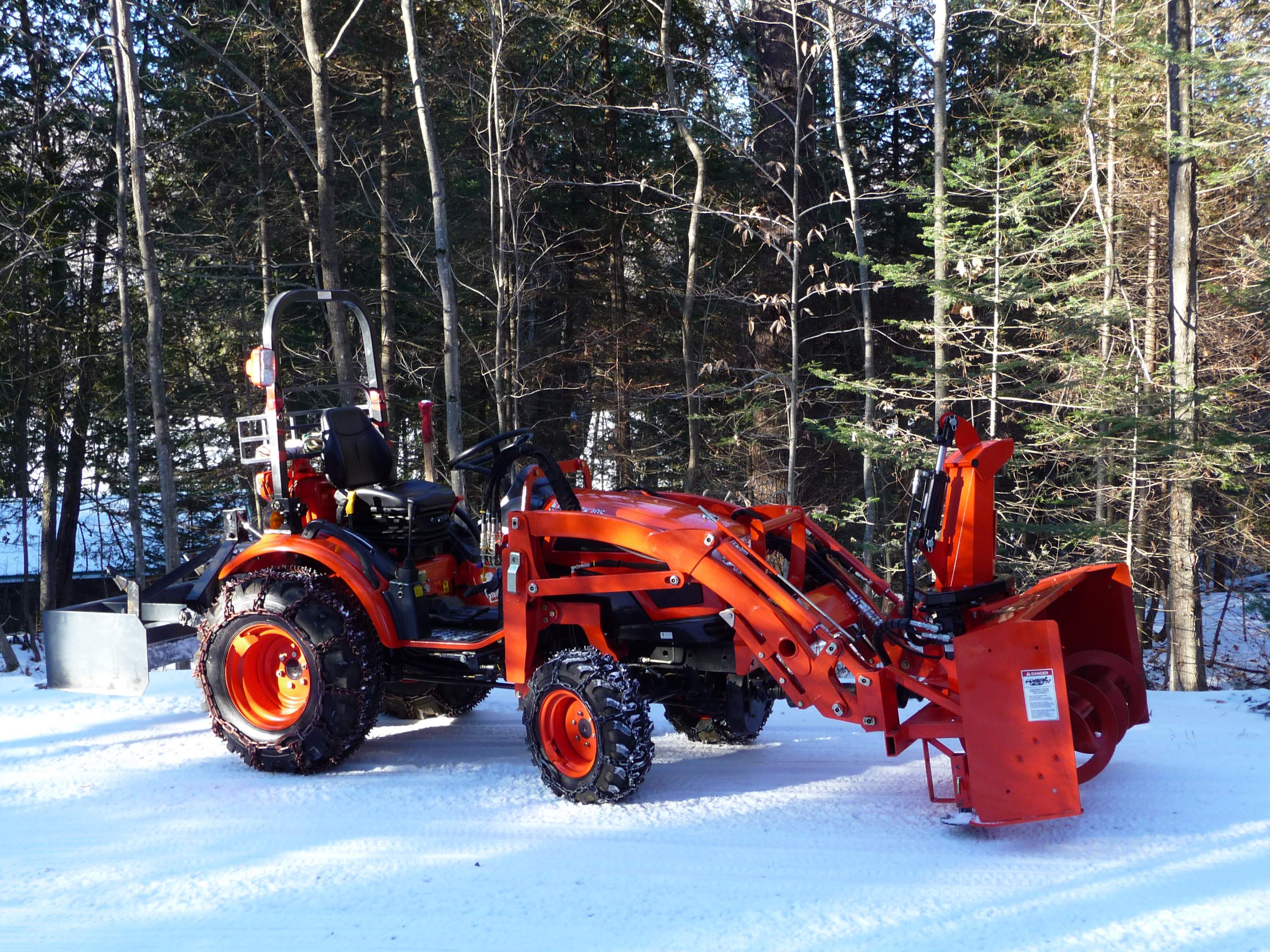

Since the January ice storm, our road has stayed cover with ice, extremely dangerous. My road has about the same step with a sharp turn. With studded chain on four wheels, it's a breeze (I did try the ladder chain - but going sideway where a real problem). There from Tryy, at some point you could not even stand up beside the tractor, my Sorel boots where insufficient! However, the tractor was able to climb uphill without slipping.
On the pic, you can see on the left the roof of the garage. It is the last portion of the downhill slope. I would dare engage that road with regular latter chain. Studded chain are in a class by themselves; You will be impressed, your end up having more traction than in the summer time.
Be careful - Phil

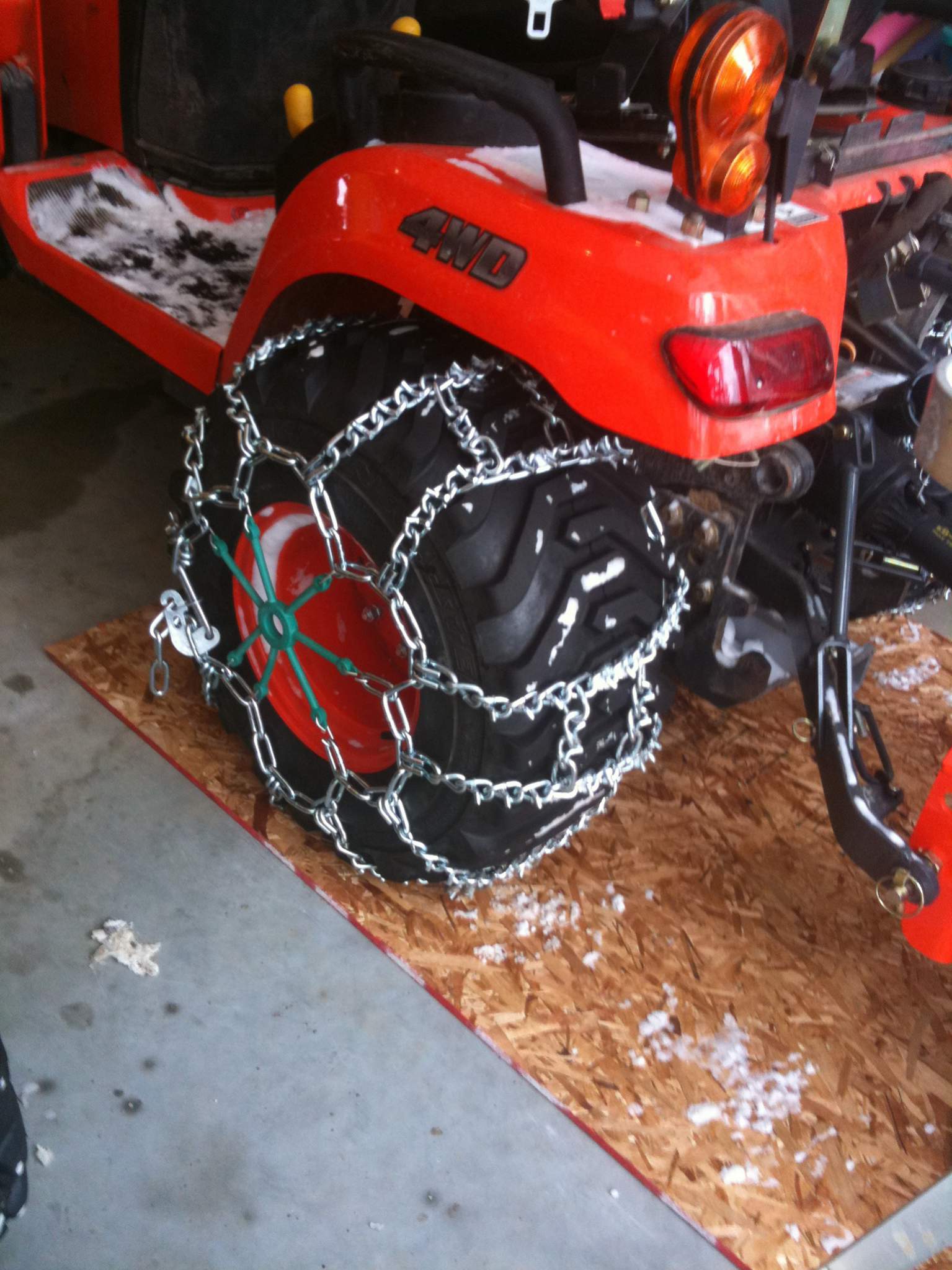

Yes, I did buy them for the front, but to be perfectly honest, I have not put the chains on for the past 2 years because I now have 2 cottages and I have to drive down about 300 yards of pavement to get between them, and I did not want to experience that rough ride. Both properties are pretty level, and so I have been able to get by without them up until this point, but there is a lot more snow this year, so I may put on just the rears. (I seem to recall someone on TBN saying that is is the front chains that cause most of the "rough ride" feeling.)
So, we'll see. If we get another really heavy snow up at the cottage, I may put the rears on, and maybe just drive down the shoulder of the road where it is a little softer.
Oh, yeah, and I do put a piece of plywood down on the garage floor, on which to park the tractor when the chains are on.
