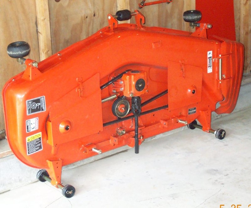

Larry's Mower Stands:
I saw these on the site earlier and they looked like a great way to get my deck out of the way. Used them last night and they worked great. He also supplies a little safety chain that is not shown in this picture.
