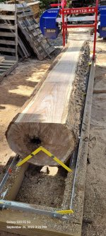

   / sawmill platform? What to use? #18
This is my setup. Hud-son sawyer.6" x 6" with aluminum tracks lag bolted down. I shim the 6x6s each time as they are just set in the ground. Just put mill head in the garage while i spend christmas in Florida with the kids.

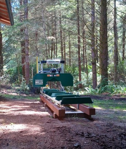

   / sawmill platform? What to use? #19
My Timbery sawmill track sits on 16 ft PT timber. Under that are 4 cross beams of 4x6 PT. Those sits on leveled 2x8x16 solid concrete blocks. Similar to Menagerie's pictured above. Sawmill sits in clearing all summer. The head unit is covered with a barbeque cover. When done sawing for the year it goes in the barn on heavy saw horses to be able to pallets on the floor under. Jon
   / sawmill platform? What to use? #20
My suggestion, and what worked for me. First, find an area that is clear and relatively level that you can easily access from all sides. In my case I had to create such a space, Lots of smaller trees and sloping ground. I terraced the slope using good quality rail ties. Then back filled with very coarse river rock and gravel. Once I had it close to level I put down more ties, one at each crossmember of the saw's track. Then filled the space between ties level with crusher run gravel. Imagine a real railroad road bed and ties. Then permanetly anchored saw mill track to the ties. Periodically check track for level (once or twice a year) usually in the spring after ground thaws, or when I notice a waver/wobble in a board. First year had to re-level a couple of times due to settling but not hard, prybar and shovel in some additional gravel. Eventually I built a pole barn cover for the entire mill to protect from elements. Cost to me was minimal, traded cut white oak lumber from my back 40 for the gravel, had the ties stacked for another project that I decided not to do after all, mostly time and some fuel. I have a Woodland Mill's saw with a twenty-foot track.
