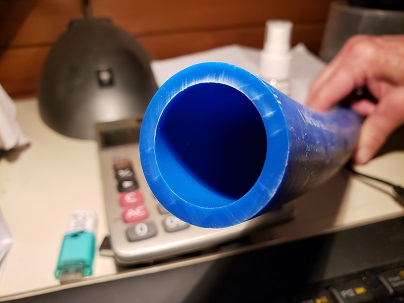

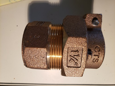

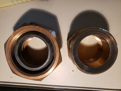

I originally ran my water line 700' in 3/4 pvc. 40 years ago. It did pull apart in only 1 joint. 5 years ago, I replaced it with 1 1/4 " Poly - Very thick walls and very stiff tubing. Came in 500' rolls. The fittings were offered in bronze and plastic. I choose bronze. This pictured is a union. I used one union and 2 end fittings on ends of pipe.
They are tough and very solid and watertight. I bought 3 fittings, I think they were about$45 each. Not too cheap, but good. Maybe I should also mention this in the Ozarks - Any hole deeper than 1 1/2 foot has been dug with dynamite. I bought this pipe at the plumbing supply. This is what the city uses for water lines. Best wishes, Larry

this is what my utility uses as well, and what we replaced copper with. the fittings are expensive, but beefy. ours is 1 in i think, and has a stainless insert in the pipe at each fitting.
From your pics that sure looks like PolyB that I've used a lot of.
Our city also OK's its use.
For fittings I used brass barbed ones and double clamps and lightly heat the barb insert B4 clamping.
My thought was heated inserts would make it easier for the Poly to mold itself onto the barbs.
And it sure does as I once had to remove an insert and finally had to cut it loose.
(Lately I found that stainless fittings were actually less costly than brass.)
