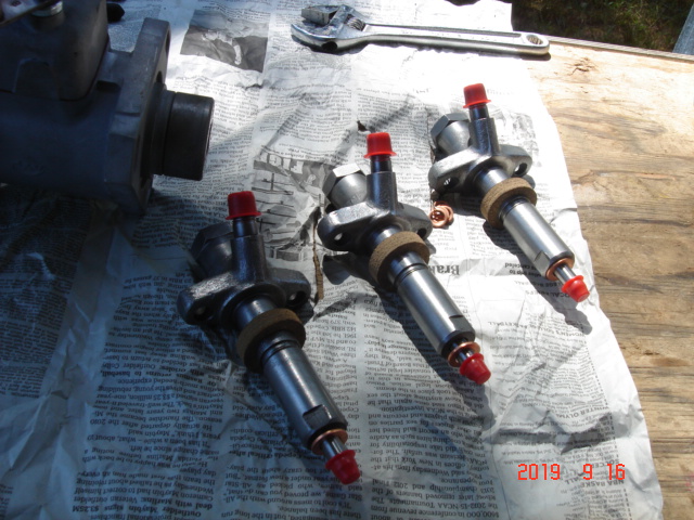

I have been working the 3910 some, and it seems to be helping. I poured a can of Sea Foam into the fuel tank about a week ago, not for the injectors which are new, but was thinking it might help with carbon build up inside the combustion chamber. I put a six ft box blade behind it and graded with it for about 3 hours a few days ago, and didn't run it again until today. There was very little smoke that cleared away very quick. Thanks to all who made suggestions on this old tractor, it seems to be doing a lot better than I first thought it would.
