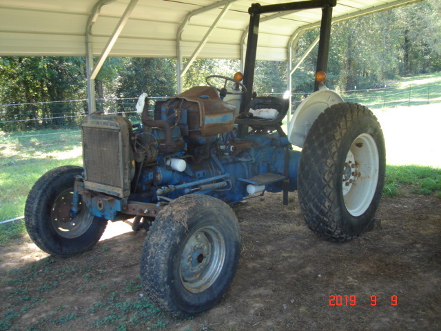

I reinstalled the radiator shell and guard along with the air filter housing and new inner and outer air filters, also replaced the pre cleaner that was missing. I could tell a difference in the sound of the engine, with that little extra tug to get the air it needed to run.

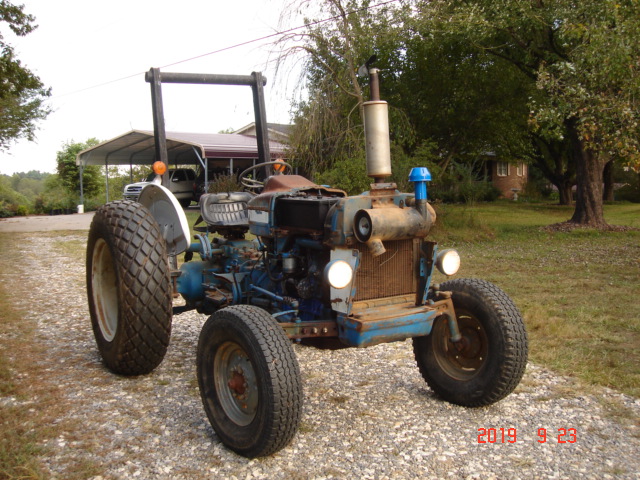

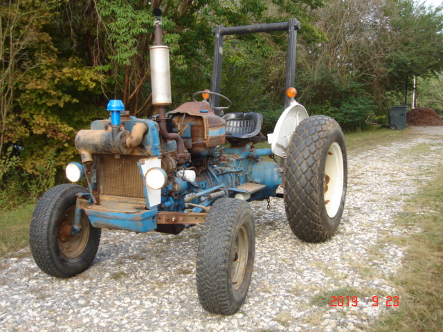

The 3910 is doing better each day, started it this morning, very little smoke that cleared away in a couple minutes. I adjusted the clutch, now takes hold about 3/4 out, feels about right to me. I had a set of headlights that came off a 3930 that I installed a front loader on a couple years ago, installed them, connected the wires pulled the switch and they are working. I did get a new 4DLT battery for the tractor actually before I did very much to it because the battery was missing. I didn't get to change the transmission, and rear end fluids because I bought what I think is the wrong fluid. When I told them at the parts store what I wanted, they gave me Warren AW-32 which I believe is 10wt. I have read that I need at least a 20wt. I have 5 gal of VP Racing ultra J20A Plus, that I think came from TS. Thinking about taking the AW-32 back and getting 10 gal of the ultra J20A Plus. What do you think? Here are a couple more pics with light on and tractor running

Do not use AW32. The J20 compatible oil will be ok for the brakes and PTO clutch if they are referencing the Deere J20 spec. You can use it in the transmission and power steering as well.

Ran out of paint after the breather cap, and the diesel fuel cap??
/ Saving A Ford 3910
#73
I ordered the air cleaner cap off ebay, it was supposed to be black, but as you can see it was blue, the fuel cap was on the tractor as is when I got it , don't know if it had been replaced or not. I did change the transmission and rear end fluids along with new hydraulic filter today, I used a premium grade tractor hydraulic & transmission oil that was recommended for New Holland tractors M2c134 a,b,c,d. I was surprised at the condition of the underside of the tractor, paint was pretty good and drain plugs were in good condition with no rust. The transmission fluid was milky, the rear end fluid was getting dark but still looked good, no water in it. Started the tractor after changing fluids and have very little smoke. I will probably put the rest of the sheet metal back on it and just use it as is for a while. I am happy with this project so far and think it was worth the cost to get it going again.
