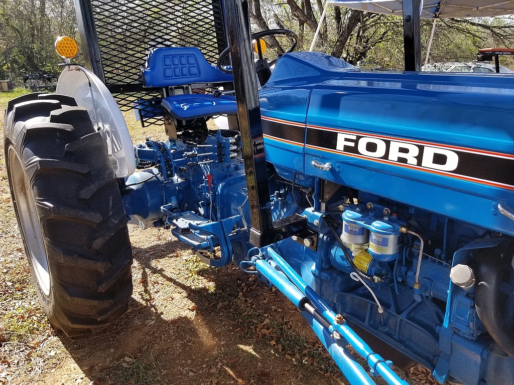

I can't answer for anyone else, but I sure like my 1986 3910 for cutting. I have a six-foot rotary mower and a six-foot flail mower I use with it. I also have a back blade and tend my driveway with it. It works better and faster than my little dozer (420C).
I bought it at a county auction that used it for mowing back in 2008. It came with a five-foot Ford rotary mower, but it was well used. I'm not sure of the hours since it had no dash at the time. During my restoration, I found the engine was replaced with a 1989 model (6A89A) and had new everything--Injector pump, injectors, starter, power steering pump, water pump and radiator. All I really had to do was some wiring, install a new dash and paint it. I ended up replacing the hood and fenders during the paint process since they were pretty beat up. Oh yeah, I put new tires on it too. It's like a brand-new tractor now. I rarely use the pre-heat (south Texas). This is 2025 and it starts with a flick of the key down to about 40*F.
I ran across the original auction receipt while going through my desk. Including buyer's premium, I paid $2805 for the tractor and $44 for the Ford mower. But that as 2008 dollars. That's $4203 in today's money. šŸ˜Ž
