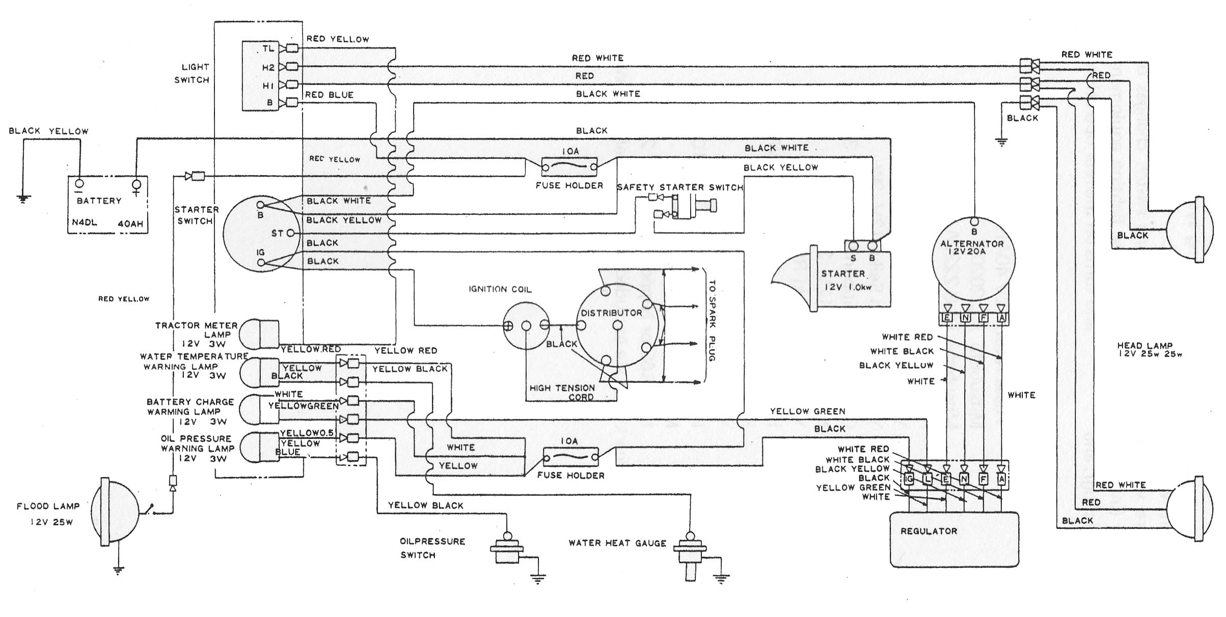

S630 eh?
  • SATOH S630 ELECTRICAL WIRING DIAGRAM.pdf
  • SATOH BULL S630 INSTRUCTION BOOK.pdf
