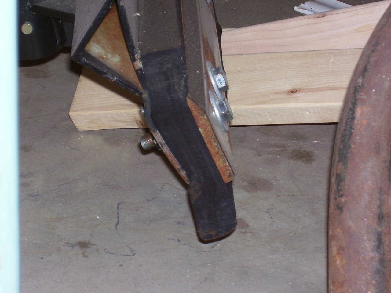

Anyone have a source for rubber or other substance for the blade edge?
Or any other recommendations?
I got a piece of this very hard rubber like material that was used on a county truck. A friend of mine who works for the county got it for me.

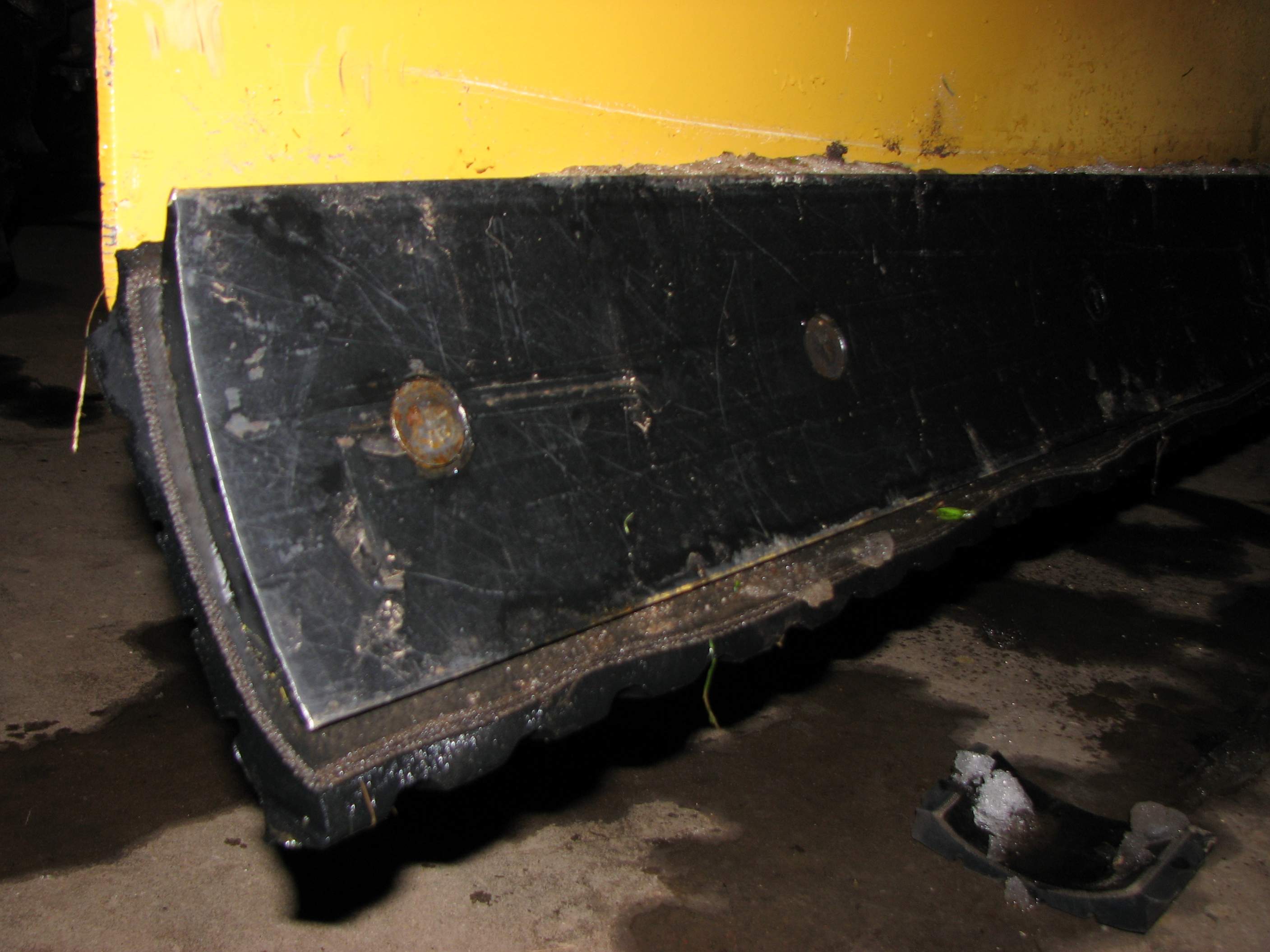

   / Rubber leading edge for snow plow? #4
Here's a couple I saw when I was looking at rubber for my fel plow. I have a very long asphalt driveway, concrete pad by my 3 car garage, and a brick circular turnaround in front of our house. I was concerned about the brick, but went with steel cutting edge to handle ice built up from car tire tracks when I couldn't plow in time.
No damage on any of the surfaces - I just don't go at crazy speeds & watch the transition points from one material to another. I think the snow actually acts as a lubricant too. Anyway, all my surfaces come out clean. Good luck.:thumbsup:

   / Rubber leading edge for snow plow? #5
I'm pretty sure I got mine from BoughtaJD's first link, which is a company called Rubbercal. I have mine on a rear blade, and it works well, it has a little bit of a squeegee affect that helps remove snow.
