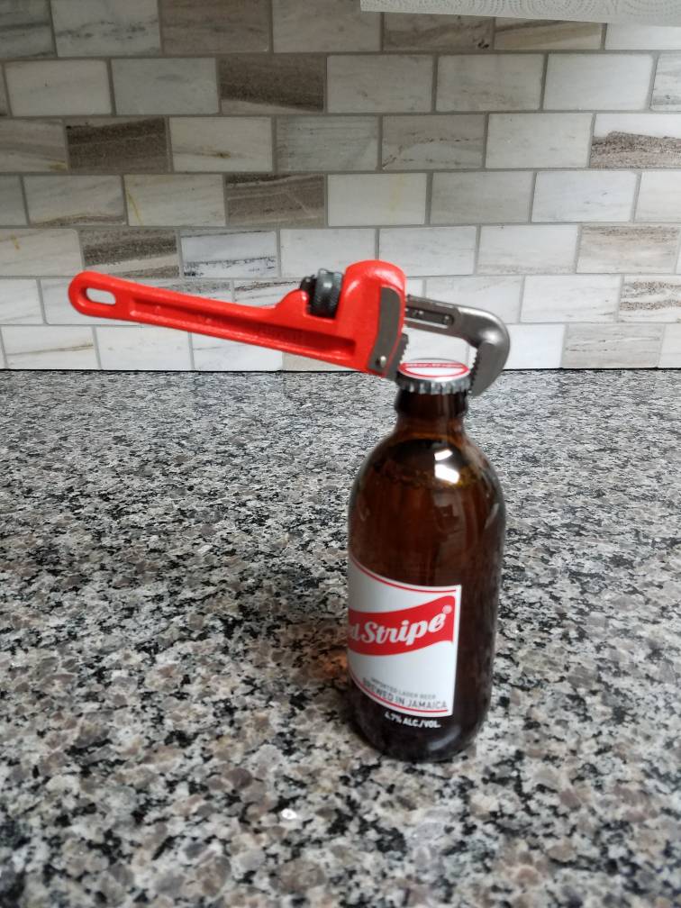

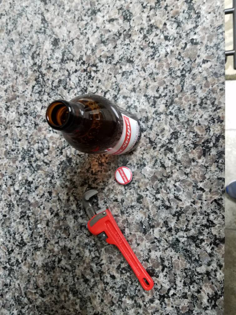

You could have ordered one of these from amazon for $15, removed the plug with it 1 time AND used it for its intended purpose (pictured) at least 6 times by now. 20181121_223535.jpeg20181121_223612.jpeg

You could have ordered one of these from amazon for $15, removed the plug with it 1 time AND used it for its intended purpose (pictured) at least 6 times by now.View attachment 579936View attachment 579937
I actually found a 6" ridgid in my toolbox that I don't remember buying. Ordered an 8" one that was delivered today. With time off work for the holiday I'll work on getting a flat spot on each side of the plug to stick the pipe wrench on.
/ Rounded off drain plug #719
Cool.
I would try getting a good grip without removing any material. You can always remove more, it will be exceedingly difficult to replace any that didn't need removing.
Find a good size pipe or conduit to give you some leverage. Be sure to have room to turn it while it does it's grippy thing. I would grab as high up against the pan as possible.
Maybe watch some yoo toob and try it out somewhere easy to get at just to know what to expect?
The teeth, especially new, will grip the **** out of and scar up anything. It's either gonna come on out or snap off (very extremely highly doubtful it snaps).
And don't get nervous or worry that will mess you up. Worst case, you gotta take it somewhere and pay $100 to get it welded on or drilled out.
It could be worse and your wife could mad at you.
