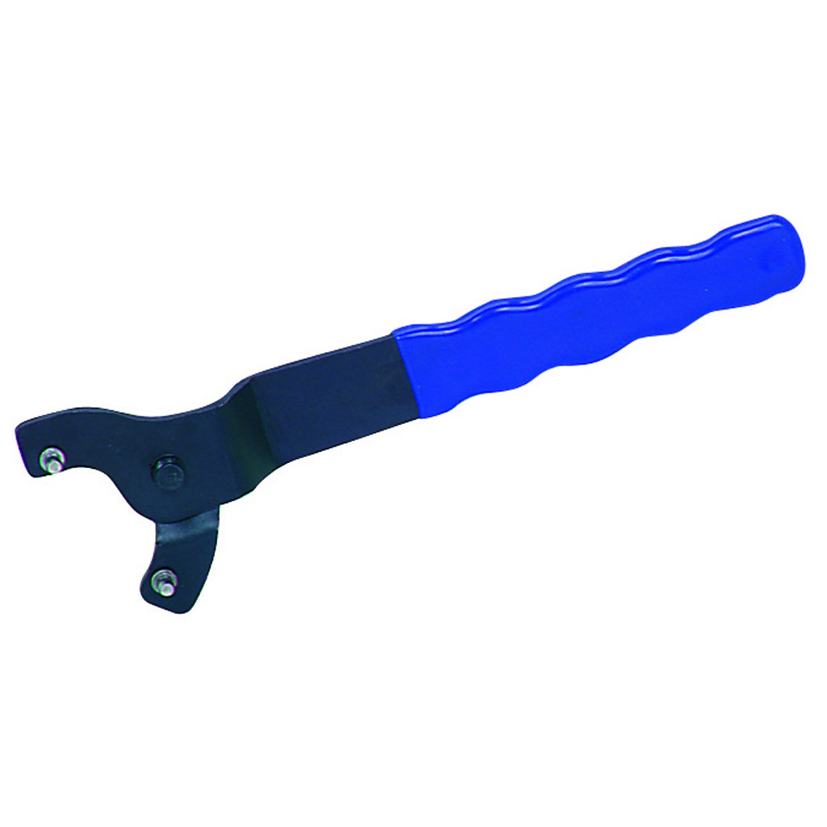

For the dewalt:
Take an appropriate length 2x4 and two 20d or 16d nails, hammer the nails in the 2x4 at the spacing you need and cut the heads off so you've got got about a half inch of or so of nail sticking out. You've now got a spanner wrench.
A buy several of these next time you are in Harbor Freight.
Adjustable Pin Wrench
