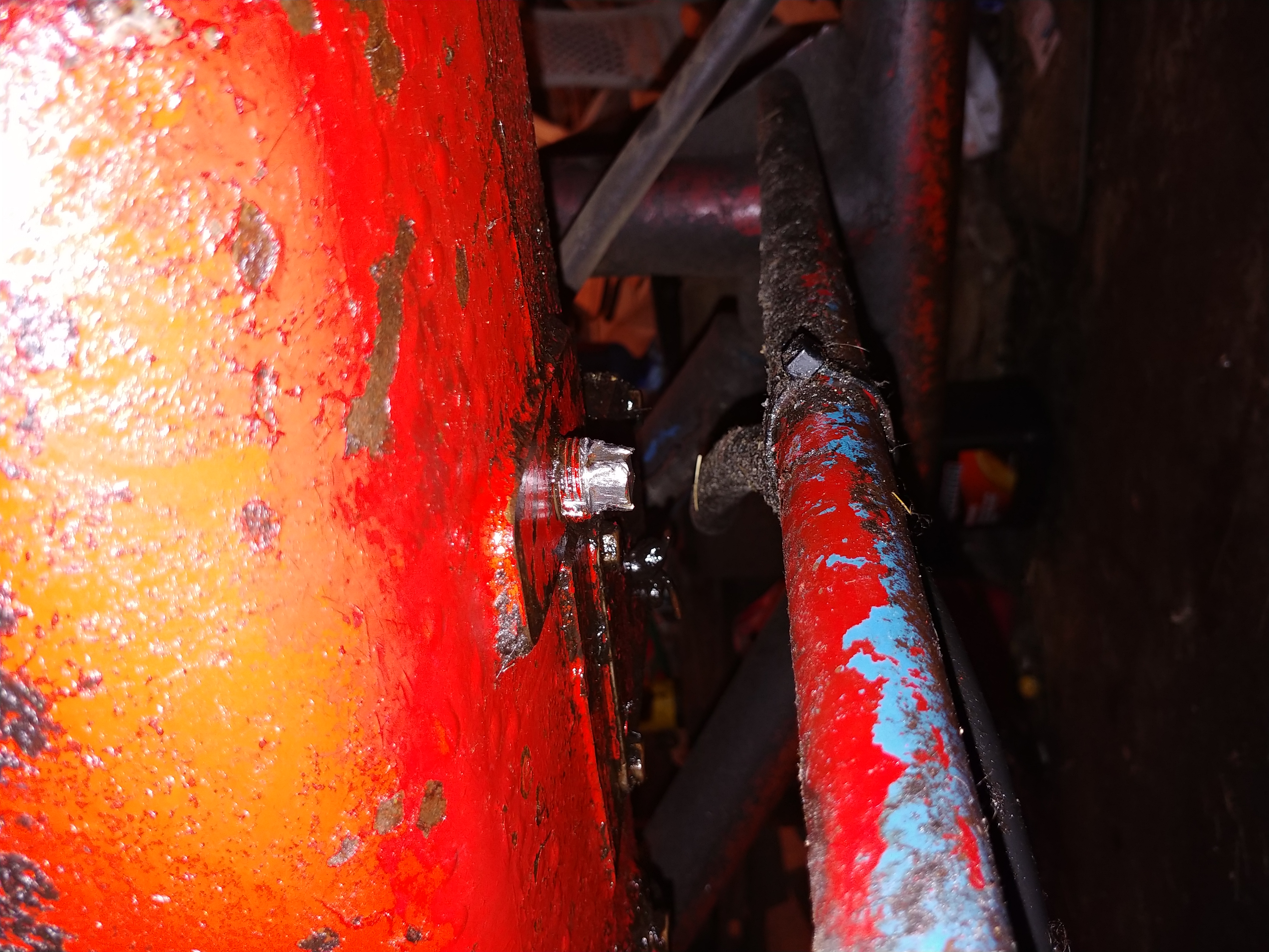

Yes, square head.
Here's the current state of the plug. That bar should be removable, bolt on each end. The loader mounts to the frame on the front under the engine and to axle on the rear, just a support bar I suppose. Johnkn, I've tried those extractors as well, although the one I tried was the one that fit in it's current state. Once I remove the bar I'll look into using the next size down, 1/2". Bolt head would normally be 9/16"
Wouldn't it be a hoot if for some odd reason that plug was a left handed thread and all this time he's been tightening it?
Well, we actually dont know which way hes been trying to turn it - - although its observably a right hand thread.

Drop the oil pan. Weld a second drain where it is accessible. Reinstall the pan. Refill with fresh oil.
And use a Fumoto Drain Valve if it will be protected by that crossmember.
That was easy! :D
(No I haven't read the first 500 or so posts. I just noticed the thread today).
/ Rounded off drain plug #506
Well it is obvious that you (and many others) didn't read the first post.
There is no pan on the transmission.

Yes, square head.
Bumping Kando's original picture of the plug and the bar that's obstructing it. I also included a picture of the plug on my Ford to show how they look in better shape.

Can't say as I've ever seen a pan that can't be removed one way or another.
Would it be totally unreasonable to consider drilling a new hole for a new drain plug in a more accessible spot?

I would grind some flats all the way up to where the threads disappear into the plate, using an angle grinder, die grinder, whatever. Then pressure wash the tractor so you don't set it on fire when you heat that area with a torch.
Run the tractor until hot, heat that area further with a torch, chill the plug with an ice cube or electronics spray etc, then put a huge pipe wrench on the flats you made and pull hard.
