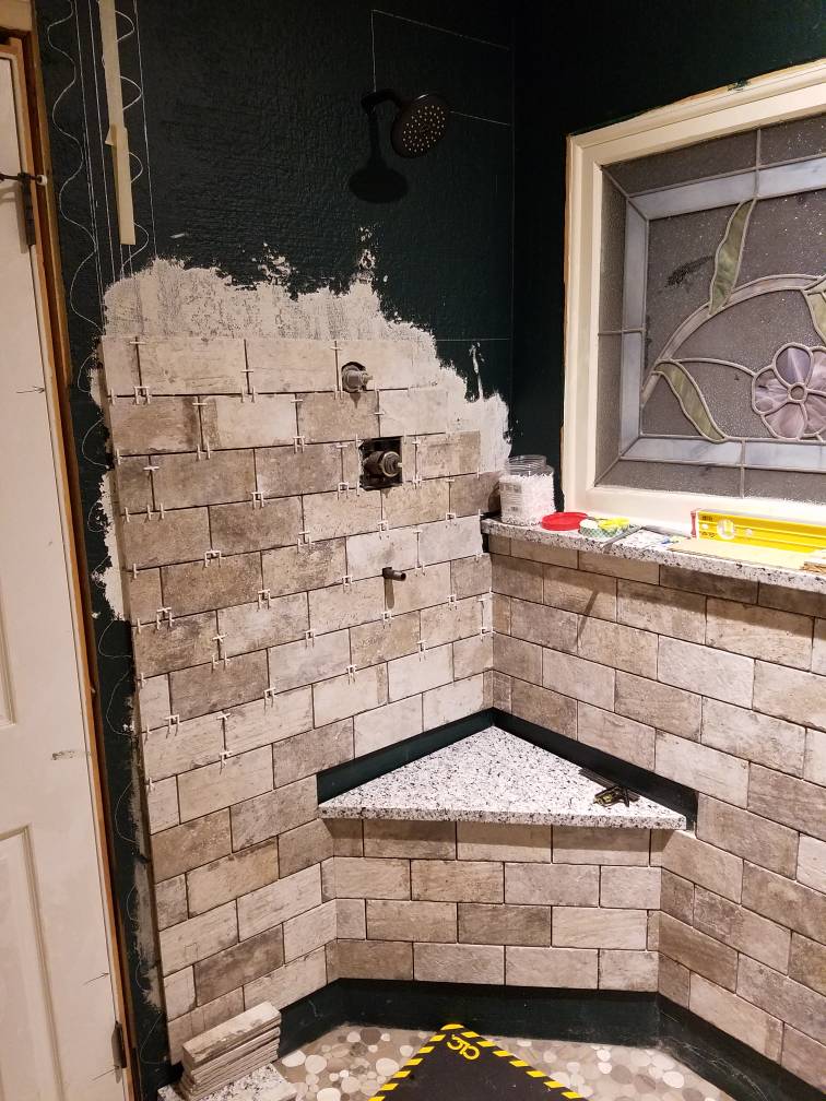

I guess everyone has their own personal stuck drain plug.
