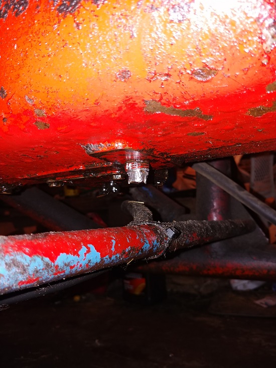

Looks like there may be enough room in the pan boss to just drill and tap a new hole...
But I would probably first try welding a wrench onto the stub that's left. Worst that can happen is that you twist it off.
Then you have two choices:
A) drill out the existing plug and hope you get your drill centered (and parallel).
B) drill and tap a new hole.
BTW, why do you need to remove the plug? Is it possible to use a pump to drain from the top?

Really, just find the closet 6 point socket, grind the plug till it starts on, hammer home and remove. 20 minutes work
/ Rounded off drain plug #1,684
Probably would be a good idea to use an impact socket. Brute force may break a standard socket. Lo and behold; after driving the socket on , the plug comes out only finger tight. Never under rate brute force. As my Dad used to say " if it don't go get a bigger hammer".
Closing on 1700.
Ron
/ Rounded off drain plug #1,685
the plug is 4 point, like the back end of a socket. it's MUCH harder to grind a 6 point by hand than it is to make a 4 point!.. I'd just put a good pipe wrench on the threads of the plug, and un-thread it!. and ALWAYS use a 4 point socket or wrench on the new plug!..
