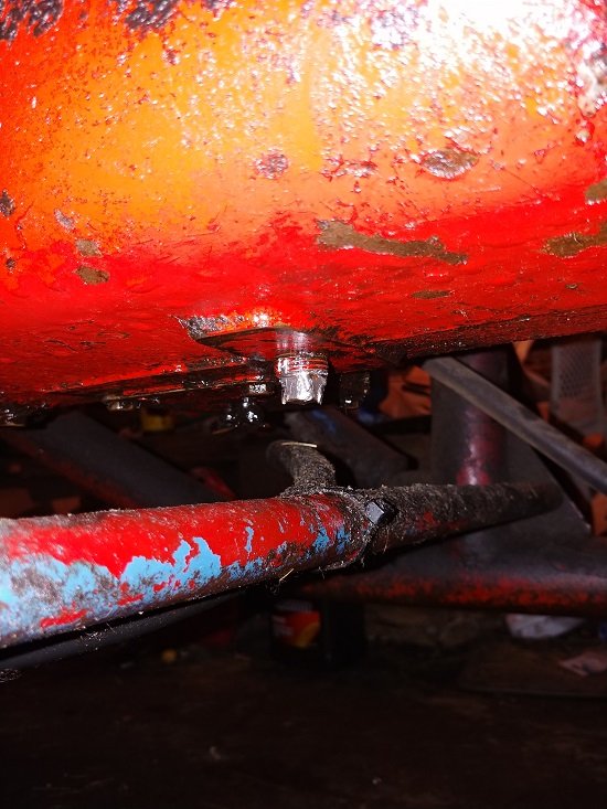

The existing visible threads are all of 1/4 inch or less of space to grip. The problem previously, as has been stated, is that there was never enough proper grip. Every attempt simply sheared more material off, hence moving in a different direction. Flat edges for grip with flat edge tools. Trying the pipe wrenches after grinding flats was an attempt on a slightly better surface to actually be able to tighten the jaws enough to not simply slide around or shear material.

Re-read. The visible threads are only 1/4 inch or less of space, from the pan to the actual square head itself. The plugs on this tractor, and my 5000 do not thread in completely. Some threads are still visible. The visible portion of threaded area is only about 1/4 inch. The square head itself is about 1/2 to 9/16 inch from the threaded portion to the end of the head. The head is what I ground flats on, as there is actually space to grip on that as it isn't up again the bottom of the tractor itself, unlike the threaded portion of the plug.

Kando said "visible threads" not "wrench flats". It is a pipe thread plug, the flats are rounded off. The 1/4 inch of threads that are showing are what he mentioned to grip.
This picture that was re-posted just 5 days ago, shows the threads:
Getting more and more too late​
Grind/file the whole exposed part of the plug parallel down to the root dia on just 2 sides. Dont cut into the root much. The root wrench surface is getting too small. Youre looking at twist off time.
Use a Crescent that will fully engage the faces to gauge // -- and then to take it out. You get 1 try.
