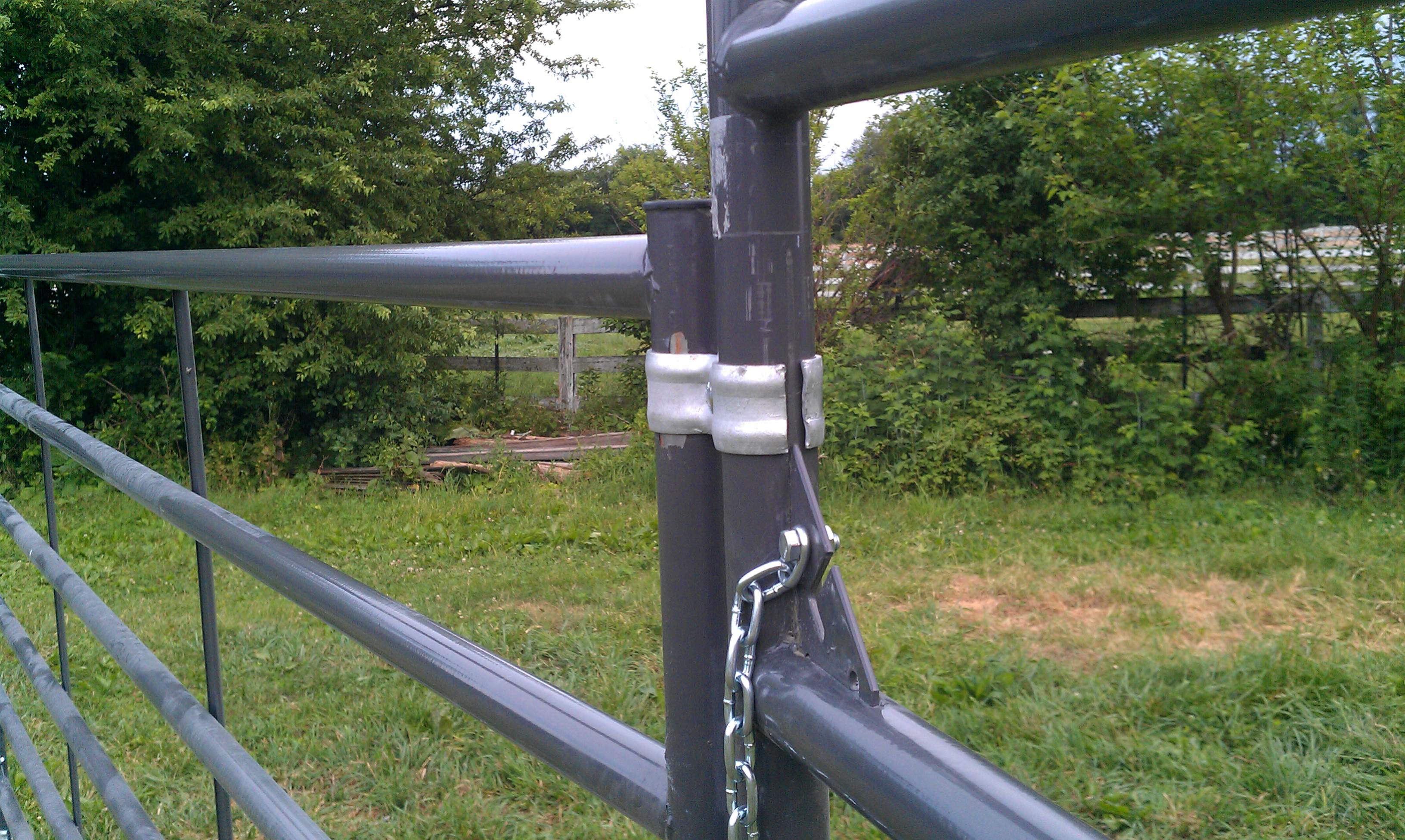

Thanks, I put duct tape on them to see if that helped, works great. So I ordered some saddle clamps that they use to assemble dog kennels. I think that will hold them. They were only $1.25 each, will post photos once I get them installed.

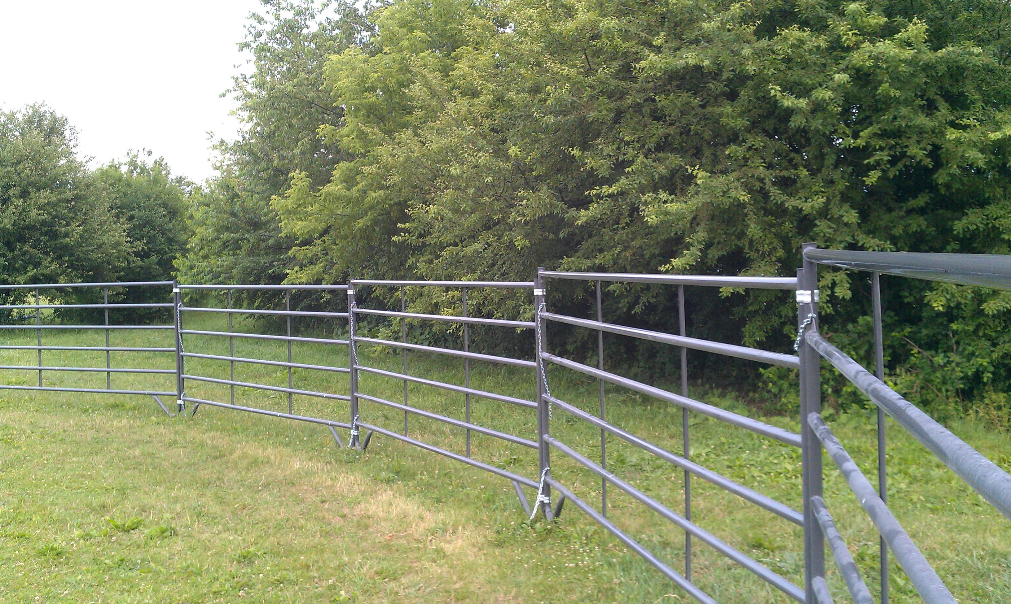

Here's my solution, bought the saddle clamps, they work great. Also found that I had to keep each panel level and raise or lower them to go up and down the grade. So tops aren't even, and only one of the panel feet touch the ground (unless it happens to be on level ground) but panels are plumb so a clamp can be installed top and bottom to make things secure.
