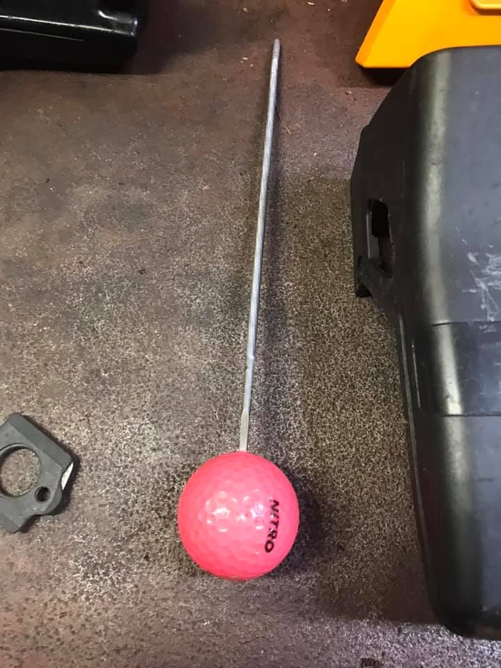

I've gone back to using a round file in one of those flat, Oregon Tools guides. The problem with that setup is the wooden handles are less than useless... drawing the file back pulls the file out of the handle about every other time you pull on it.
any other single-file handles you've run into which really grip a round 5/32 or 3/16 file?

I like the golf ball idea I heard the other day.

Sure. There's for sure no filing backwards - that would be counterproductive and ruin the chain; but the least grab on backward movement and the wooden handles loosen/wobble or the file slides out of the handle.
Just was wondering if any handles have a locking mechanism that would hold it secure and without wobble too.

a small dab of DUCO cement will cure the handle issue.

Put the file in a vice with the tang facing up. Heat the tang with a torch until it's red hot. Push the wooden handle down on the tang as far as it will go and give it a few light taps with a mallet.
Good luck getting it off when the file dulls. ;)

I was wondering that about the Duco-method as well. one file, one handle. No problem!

Now I finally have a use for a golf ball. Thanks for that!

Years ago I bought several thread on file handles for my files in my machine shop. Here are a couple links to some thread on file handles: https://www.leevalley.com/en-us/sho...HuQs94RG2jvs7BOkPS1n9F-C49wCIdFRoCZ6MQAvD_BwE
You can just google" thread on file handles" to find other examples. They work great and can be re-used when the file needs replacing.
