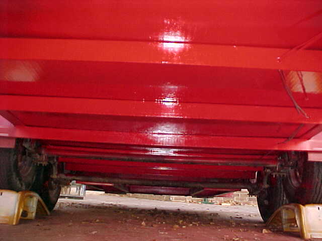

RanchMan,
Today, after church, I got serious in the 60 degree weather and sprayed some paint. I got almost as much paint on me as I did on the target. Even after cleaning up, my kids were asking, "Dad, why is your face so red....and your hair, too?" Uuggg!!
The underside looks a whole lot better than the topside. So, another spray day in the future to bring the rest of the trailer up to par.

   / Rotten Trailer Boards #74
Nice looking job! Wouldn't want to come over and paint mine too, would ya? /w3tcompact/icons/wink.gif
